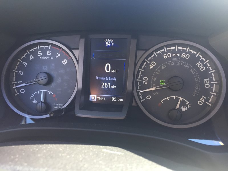

    I started noticing this too but mine seem worse than yours. Both my tach and my speedo will kinda "jump" up or down depending is in increasing or decreasing speed kinda like the seconds hand on a watch. Here are some videos/pictures of what mine does! Actually, can't seem to upload Apple video files...

    Yours is all by wire on a 2016, not sure how its relevant to a Gen 1

    Yeah I am sorry, I searched for this issue on my phone and inadvertently commented without realizing this is a 1st gen post. Sorry bout that
