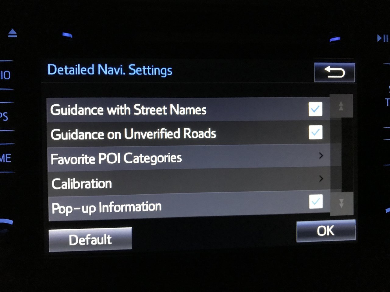

    Apps -> setup -> navigation -> detailed Navi settings

    And that altered the speedometer to the correct speed???

    Mine was off probably 3-5 mph from the factory and it has been spot on after I hit that button and drove around a bit.

    well I'll be damned. I tried that a while ago but it didn't seem to do anything. Maybe I'll try it again...
    as per the manual
    5. SETUP
    TIRE CHANGE CALIBRATION
    Select
    “Tire Change”
    The message appears and the quick dis-
    tance calibration starts automatically.
    The tire change calibration function will
    be used when replacing the tires. This
    function will adjust miscalculation
    caused by the circumference differ-
    ence between the old and new tires.
    INFORMATION

    Nope. Been driving around for 2 days and still not calibrated. BS
