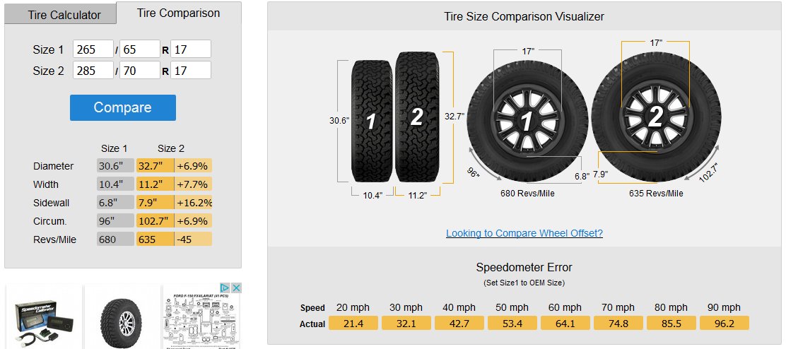

    Of course not. Per the Navigation Manual, it has to do with your location shown on the navigation map, not anything to do with the speedometer.
    "If this procedure is not performed when the tires are replaced, the current position mark may be incorrectly displayed."
    @raven543 the pic below shows how far off your speedo is at what speeds
