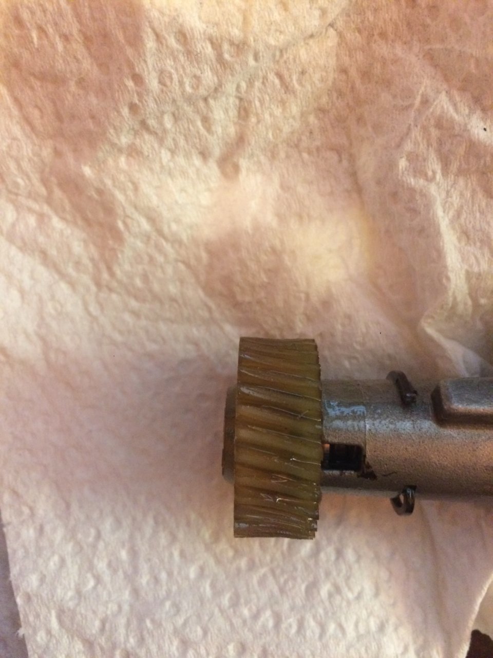

    I just pulled the speedo gear from my extra R155 and I’m about to swap that in. Hopefully it was a shredded nylon gear on that causing the issue. I’ll report back a little later :fingerscrossed:

    Well that fixed it! As you can see on the old one below the inside of the gear’s edge is lower than the outside and wasn’t engaging. This is on my 2009 5speed manual R155 for reference
