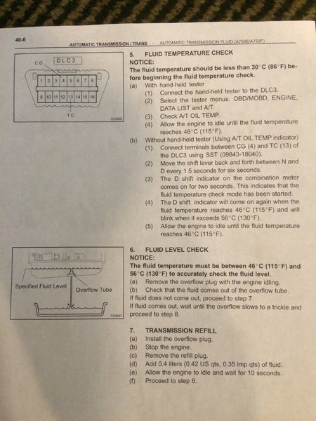

    Sorry man I can't help with the odo.
    But I think I remember having to jumper something to fill tranny correctly, fwiw.
    I'll look it up tomorrow.

    Not to get off topic but here's the tranny check

    Thanks for the pointers, everyone.
    Thanks for the info Radarninja - I might have to put in another .2 Qt of transmission fluid in...I might have shorted it 2/10ths.
