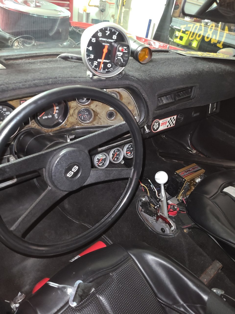

    I did however pickup this little beauty...

    In the spring I'm 99% sure that will be up for sale, I'll let you know if he decides to part ways.

    I've got the same Hurst Quarter stick !!

    As for that Quarter Stick shifter the only problem I've had is the lever you use to squeeze to allow it to move thru the gears . The mounting screw will loosen constantly , remove that screw and use blue loctite and it will stay tight
