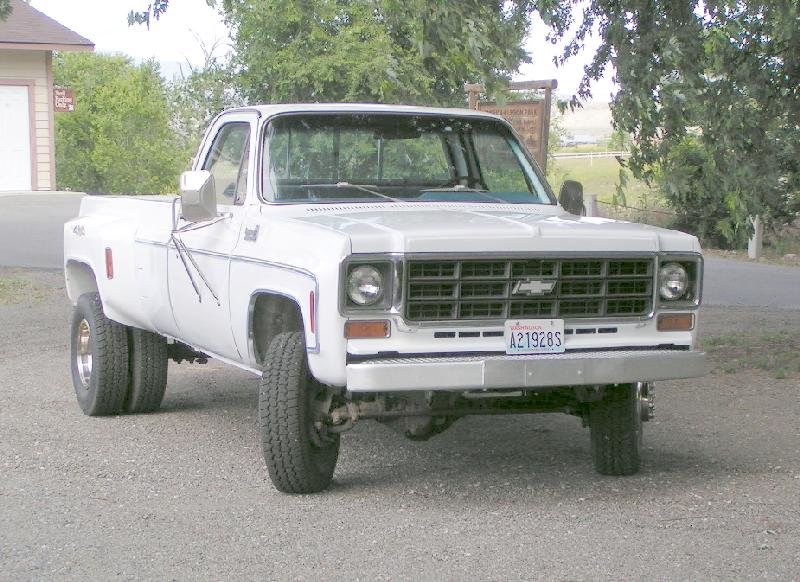

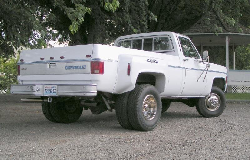

    My 1976 I fixed up a little 4x4 1-Ton Dulley with a 454 loved it drove it for 15 years till I sold it to add to my 2022 TRD Cost!

    Wow that was a clean Square! I've got a soft spot for the dually trucks, the design is just great with the body lines. 4x4 dually isn't seen often around my part of the country
