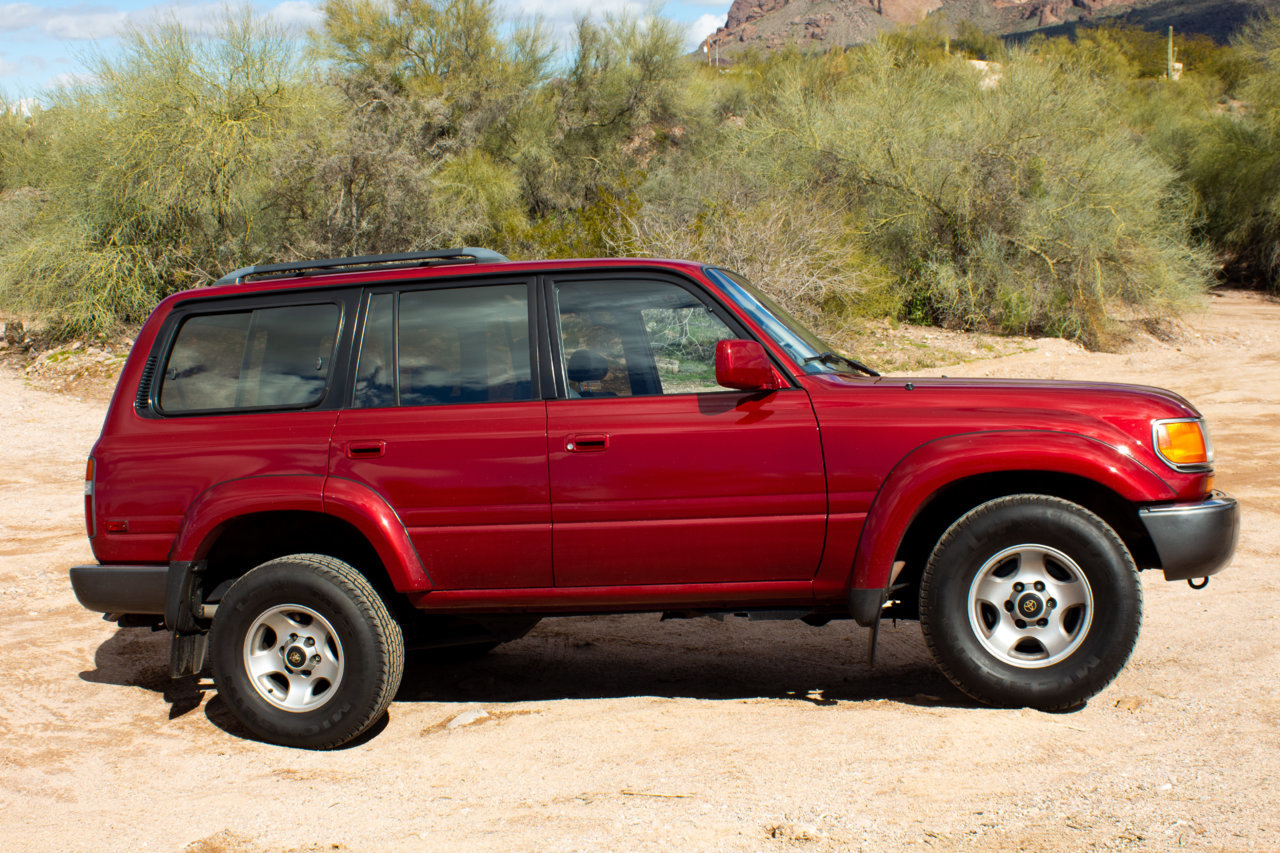

    Took a nice pic of it...

    It got washed.

    Washed, clay barred, and waxed

    Nice. Mine needs some buffing.

    Man that paint looks good!

    Thanks, it was repainted a year and a half ago. They did a nice job though and used Toyota paint.
