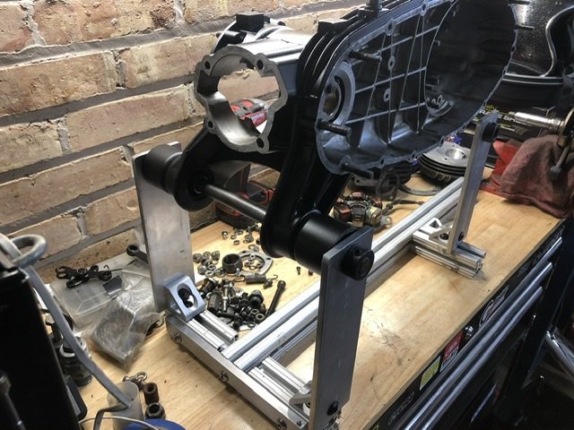

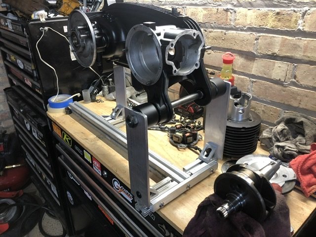

    Yeah, it’s a fun bunch. Mostly things I didn’t “need” but couldn’t pass up. The IT being the most recent...
    Gasser is a 250, it’s a little rocket. That’s my Ducati Hypermotard 1100s, I chopped up the bodywork and cut the termi exhaust apart and rewelded it at a different angle (and shortened the carbon fiber can) Its pretty rowdy- velocity stacks and cams, race ecu, Barnett clutch, quick change rear sprocket. Sounds like a NASCAR engine... I’m a little scared of it. The Beta was by far my favorite and most used machine in the fleet. The 300 lugs like no other 2t motor and she’ll scoot in the upper revs too. Friggin scumbag meth heads got it... insurance just sent me the payoff today (didn’t do great)
    The TR I got new and hated it till I figured out all of its quirks... now that I’ve gotten it running like it should and got the front end sorted out (stock fork is shit- I swapped in a Yamaha WR426 fork!) all I do is rack up miles... it’s my commuter and camping machine, 23,000 on the clock and averages 60mpg. It’s getting retired to the cabin when my Tenere 700 gets here (waiting for the hype to die down a little)
    edit: forgot- the scooters... oh man, at one point I had like a dozen vintage Vespa and Lambretta scoots. Sold most- the silver one is a Stella (LML Star/Vespa PX150) That’s mostly stock besides tubeless wheels and a pipe and jetting. Just a fun cruiser, errand machine. It’ll do 65mph flat out but 45-50 is where it’s fun. The red one- that’s a 74’ Lambretta Jet 200. I’m building a motor for it currently I’ll post some pics if I’ve got any. Standard cast 200cc cylinder bored to 69mm with a Yamaha RD 250 rod (longer stroke) to get 250cc out of it. Runs a Wiseco piston from a Kawasaki JS440 jet ski with intake windows cut into it, cylinder has a boost port cut in, runs an RD250 reed block/cage. Custom machined cylinder head, o-ringed, old school expansion chamber with a Toomey silencer. I put a hydraulic disk brake and some fancy shocks (rear shock is a re-sprung Yamaha R6 piggyback unit) to keep it somewhat under control, as it’ll creep up on 100mph (feels dangerous as hell- probably cause it is!)

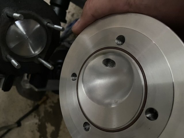

    Can’t find any pics of the cylinder/piston machining. Too bad, it looks so cool!! E198FACD-B466-471D-8AAA-8ABDF0C96DC7.jpg1B652D57-6098-4336-82B6-776855147825.jpg718FC19A-670A-4533-83F5-FA24A37467DE.jpg893AA8D5-9F37-4C2F-B2C8-4BC6C9EAC301.jpgA60CF47B-23D9-4499-BD5B-C2B61D5D5DE2.jpg

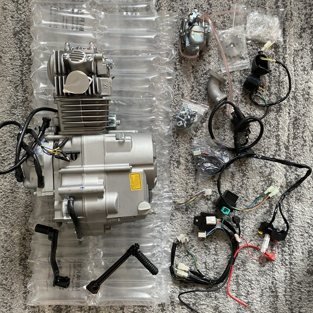

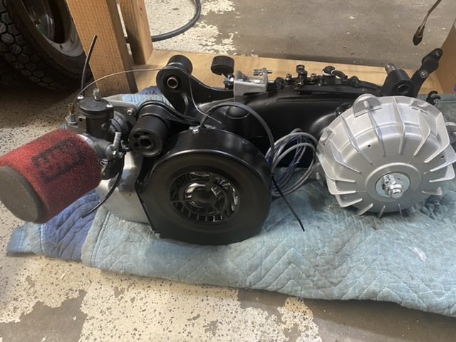

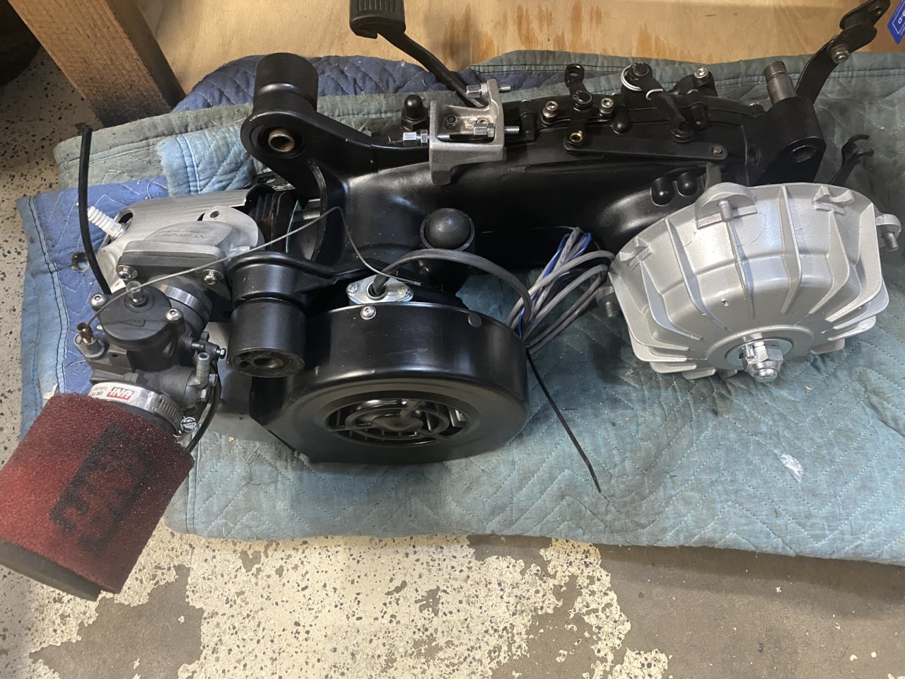

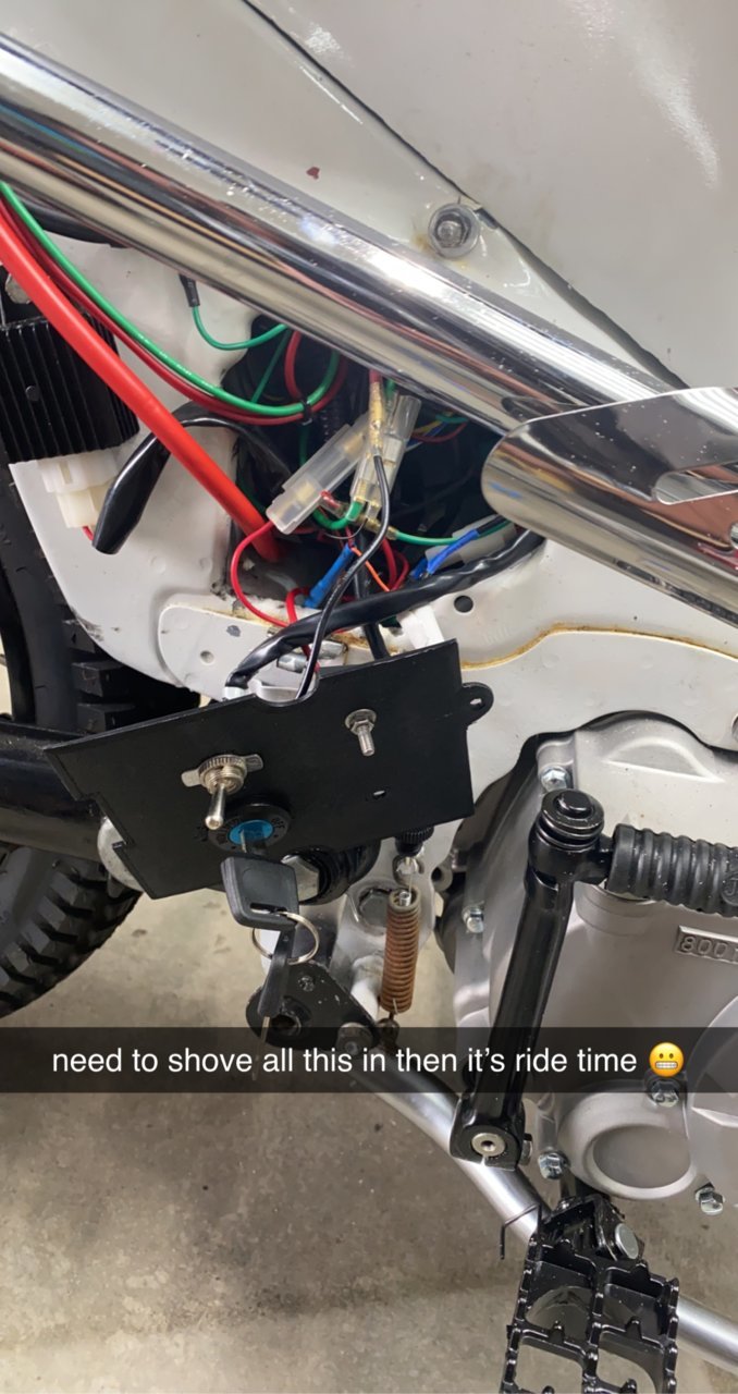

    Started this weekend on the prep work for getting the new engine in. Handlebars are mostly sorted, new front brake has been adapted and is working. New throttle tube and grips are on. She looks so naked without a tank, engine, or skid plate.
    Engine came in yesterday, unfortunately I had to leave to go to work as soon as I signed for it :( I work at a college union building and we were a polling place last night.
    Unboxed and took stock of things this morning though!
    So excited. I think the difficult parts are going to be adding lighting to the wiring harness (lighting output is AC, I'd prefer some rectified DC but think I can make it work, it's all LED anyway so I might just say yolo), adapting the stock CT90 exhaust over, making the engine mount brackets line up/size up, adapting the skid plate to work with it, and that's really about it. For now the plan is to run the starter battery on the tail rack, at least until I decide to buy or better yet make a LiFePo4 battery pack to shove in the stock location.
    The goal is to be on the road by the end of Thanksgiving weekend. I should have some good time off then to finish things up.

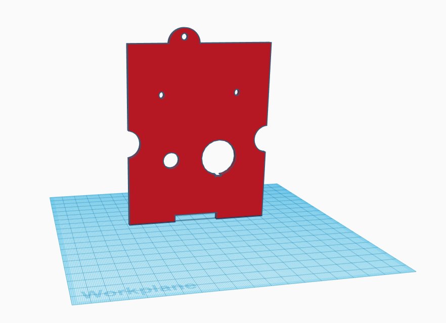

    Started working on a new switch plate/battery box cover tonight. Hopefully can get it printed after work tomorrow. I've never had a key on this thing before and I'm weirdly excited to put one on haha

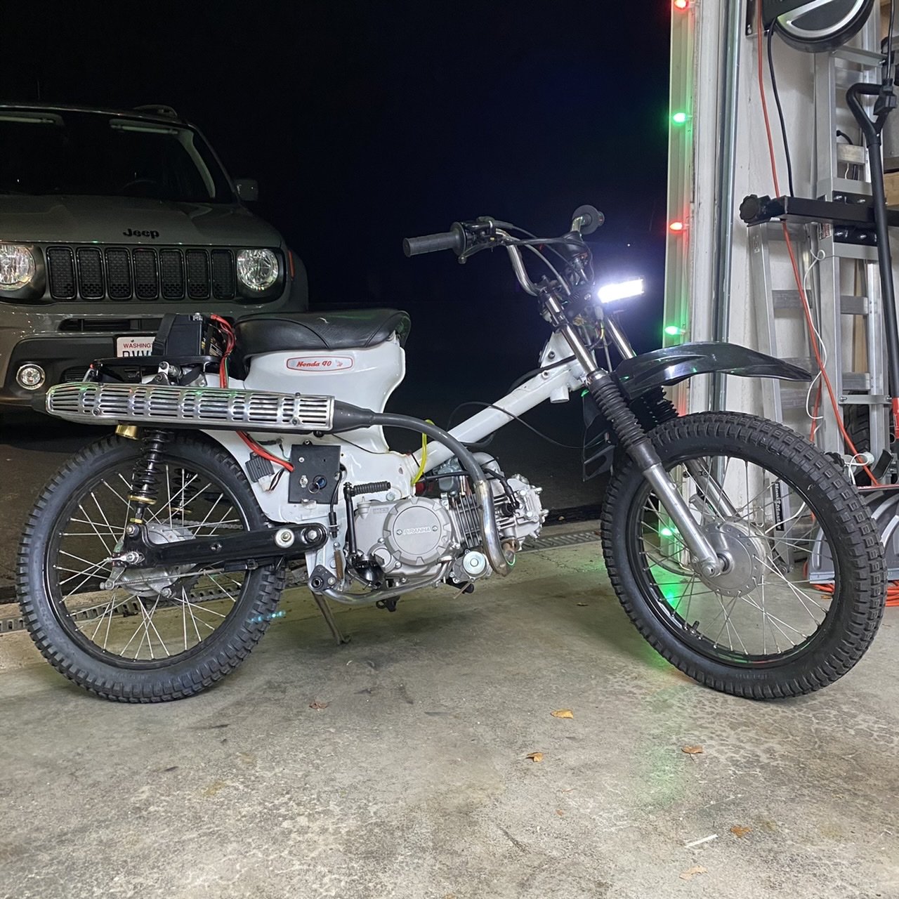

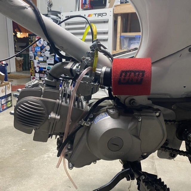

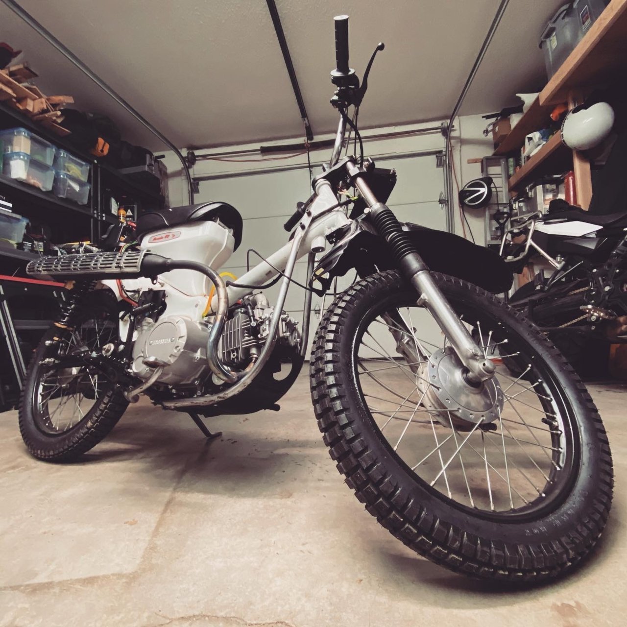

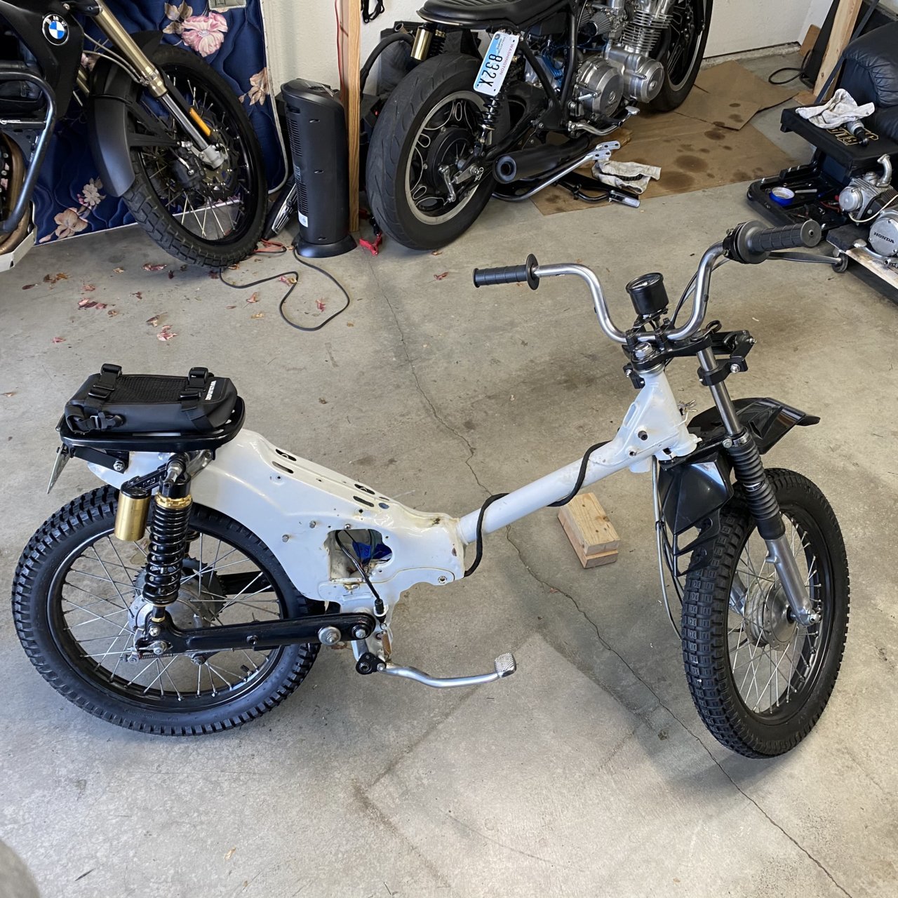

    Big ol update on the CT90!
    On the 6th I got the engine in:
    The top engine mount lines up on the honda frame, but I did have to drill it out larger. Terrifying drilling through a brand new engine. For the bottom mount, I had bought a mount converter kit from dr atv, but I think it's meant to be used with their footpeg adapter kit, which I wasn't using, so one mount lined up, but I had to re-bend and hack away a lot of the other one. Eventually I got it to work, but it wasn't exactly plug n play as advertised.
    The pegs ended up being a pain. I bought a spacer kit to clear the sides, which I'm glad I did 'cause I needed the space. The brake lever hit the engine cases and pegs real bad though, so I had to drill and tap a hole in the brake lever arm to put a bolt in to make it an adjustable stop, basically. Works well but it was just another thing on a long day.
    The exhaust for the CT90 had a wider flange and a different mounting depth than the Piranha engine needed. Luckily I bought a $40 ebay exhaust that worked to throw on and get the thing running.

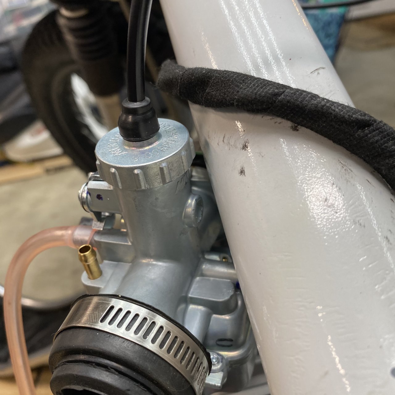

    The carb couldn't have fit any better.
    The new engine's front sprocket is a inch or two further forward, so I had to buy a new chain that was a few links longer. Hallelujah prime shipping. It's also laughable how cheap 428 chain is compared to full size bike chains.
    Next up was wiring, on the 11th:
    I used 90% of the harness that came with the engine, but had to make my own battery cables and the headlight/brakelight/tail light wiring. I guess the DC coming off the rectifier isn't the cleanest, according to the interwebz, so I floated the whole DC side of the system and wired all my grounds back to the battery. For the battery cables I cut up a set of harbor freight jumper cables. It was cheaper than buying bare 10 gauge cable, life hacks.
    Also swapped out the crappy handlebar switch that came with the harness for a slightly less crappy Amazon switch. A couple molex connectors and some bullet terminals and all was sorted with that. The wiring is all straightforward, there just ends up being a lot of it.
    Wrap the whole thing in fabric harness wrap and shove it all into the old battery box area behind a 3d printed cover. The 12v system is separate from the key, so if I need to turn on the lights or keep them off for whatever reason it's not tied to the engine being on.
    Got it running that day and took it for a sprint around the neighborhood. Rowdy little bike but fuck was it loud. Backfired like a mo-fo too. That ended up being a two-fold problem, not a tight enough seal on the exhaust and bad jetting.
    On the 19th, I put on a proper oiled filter and got the jetting sorted out. Went up a size on the pilot jet and down a notch on the needle but the main jet was spot on.

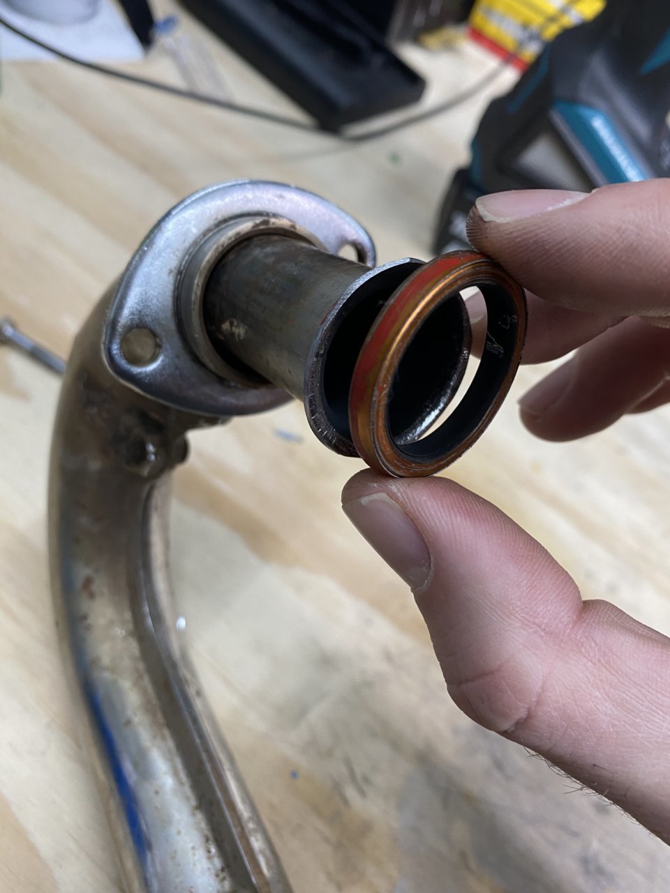

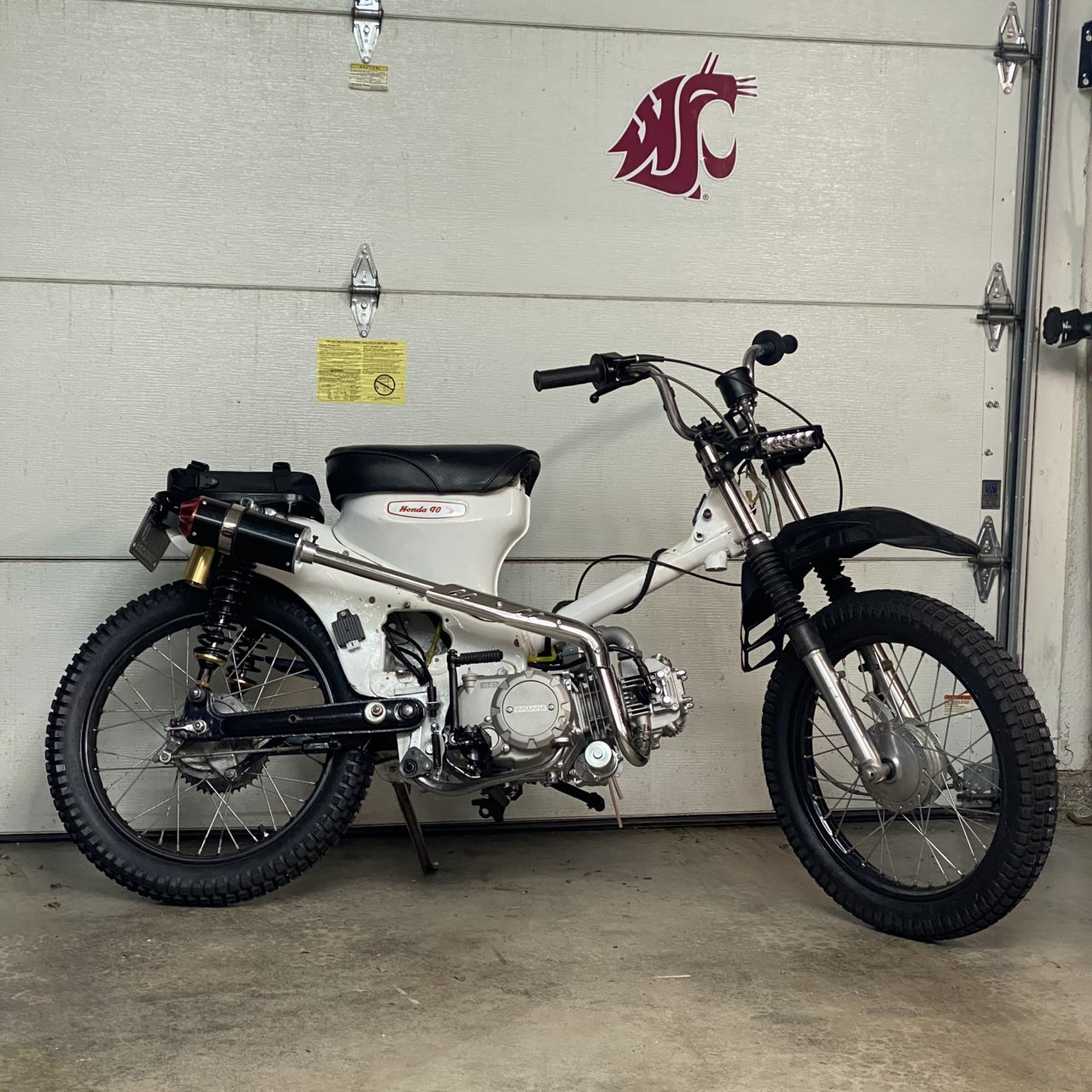

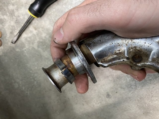

    Today I wanted to get the old CT90 exhaust on and working.
    First step was grinding away the extra material on the face of the pipe. I used an exhaust donut to mark the pipe and ground it away with a flappy disc. Then had to drill out the holes for narrower studs. The metal flange was harder than I expected and took forever. Didn't have the proper set of tools so ended up using a drill bit and a lot of patience to slowly open up the holes.
    I needed to make a spacer to go between the mounting flange and the lip of the pipe. The face of the port to the bottom of the studs on the new head was much deeper than on the old engine's head, so the pipe wouldn't have sealed at all without some kind of spacer in there. Used some scrap metal I had laying around and it worked well.
    The new head is slightly longer than the old, and the whole engine is a little lower than the old, so I had to make another small bracket for the rear exhaust mount. Flat piece of aluminum bar with a couple holes, couple bolts and nuts, and it was all sorted out.
    Got it all mounted up and took it for a quick ride! So much quieter. I'm curious how much the power output is affected. It's a couple mm narrower of a pipe, and is definitely going to be more restrictive. I'm happy with how it looks though. Much more stock and way less hooligan-y.
    Next up I think is going to be mounting an oil cooler, then maybe a different kick stand, followed by trying to get the old skid plate to work with the new peg mount pattern. That one might be kind of difficult..

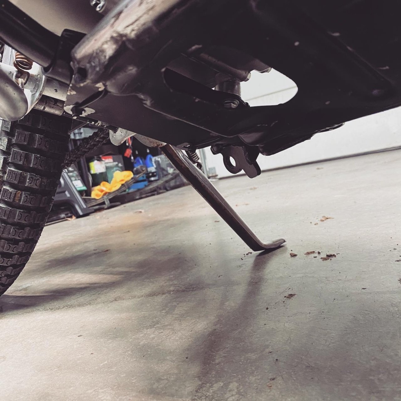

    Got the stock skid plate kind of back on last night. I'm happy it clears everywhere, that's a big win with how much longer the cylinder is on this compared to the stock engine and with the starter hanging out below the engine.
    The plate mounts with 2 bolts per side up near the neck, then another 4 bolts where the footpegs attached on the old bike. Those, unfortunately, don't match the new footpeg mount pattern at all. I think I'm going to put a rivnut or two into the new footpeg mount, then drill a couple holes in the skid plate to bolt it into the riv nuts. I'm thinking that should work out OK. It's not like it's a stressed member or anything.
    Currently it may or may not be held on on the bottom by two zip ties :anonymous:
