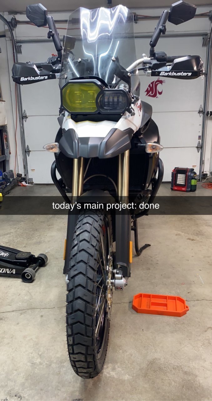

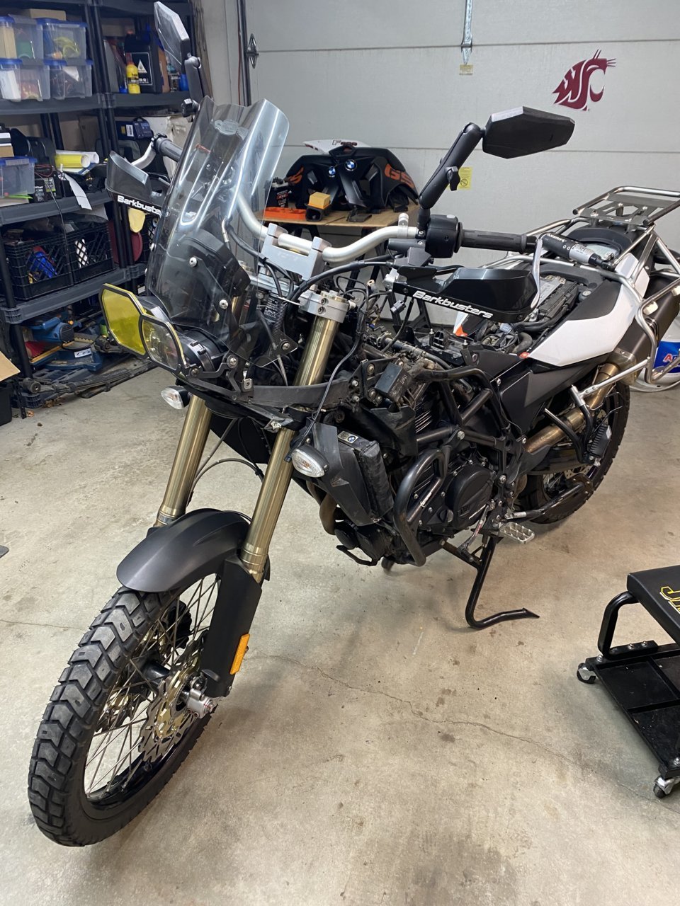

    I'm awful at keeping this thread updated. I did a bunch of work to the BMW over break. Fork seals, fork oil, checked the valves and changed the leaking valve cover gasket along with some new plugs. Then a few days later did the coolant, oil change, air filter, and oil filter.

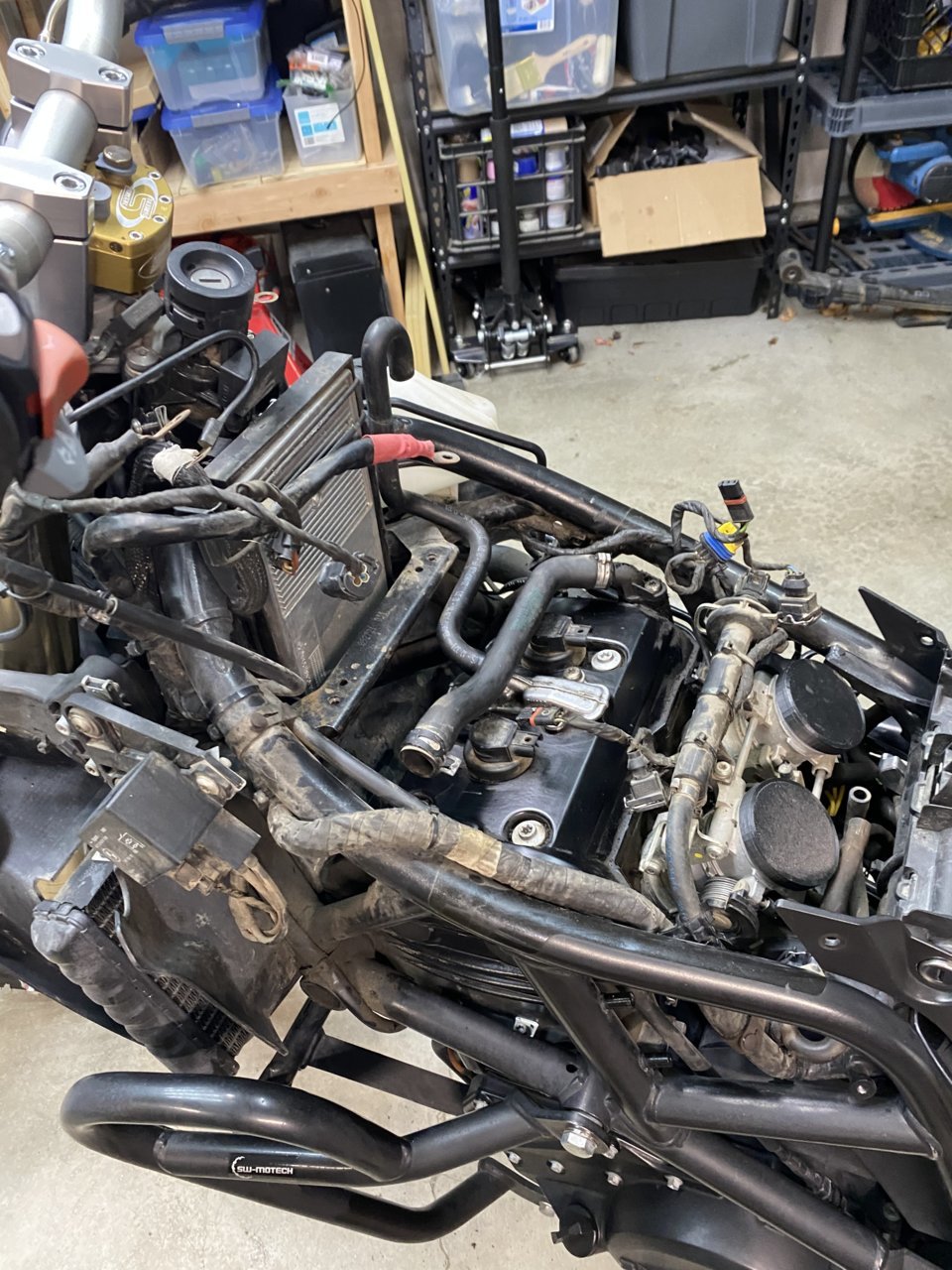

    Did some work on the BMW today. I changed out the chain guide rails. What a messy pain in the ass. Turns out I probably could have waited another 5 or 10K miles, too, the original ones still had plenty of life. Then gave the chain a good scrub and lube. This winter commuting has been hell on it.
    Decided to do a quick how-to, too:

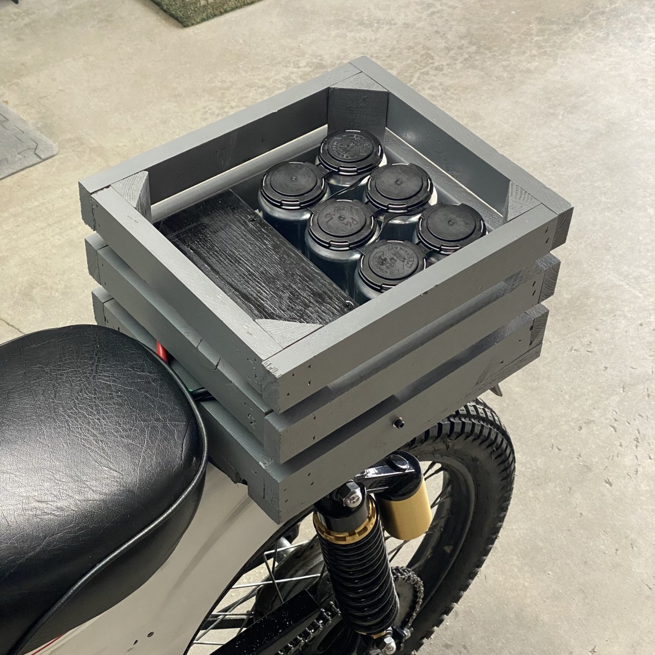

    It’s been awhile since I did anything to any of the bikes, or the truck for that matter.

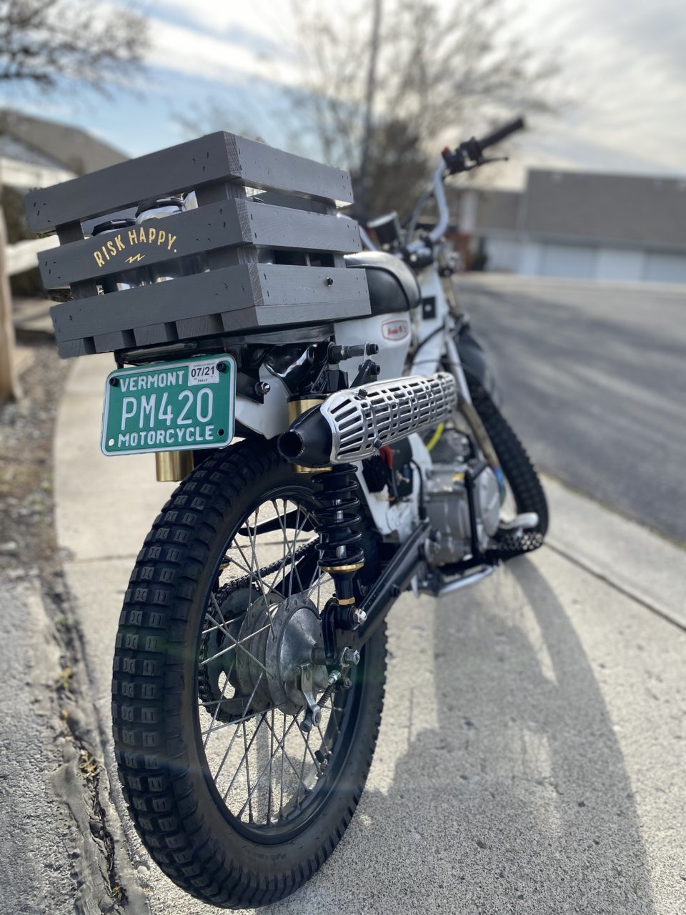

    I have some air hoses on the BMW I should have replaced on the BMW today but instead made a crate for the CT90. I looked at milk crates, but thought they were all way too large. I didn’t want it to extend out the back, because of how small my brake light is, and didn’t really want it much wider than the coils of the suspension, for looks hah.
    I took a $9 bare pine crate from Walmart, chopped off 3 inches from the end with the circ saw, then shorted the bits I needed and nail gunned it all back together. A can of grey rusto and we were in business.
    When I swapped in the Lifan and added the started battery, it clearly didn’t fit in the battery box. Out of shear laziness with a little necessity I used a rok strap and put it on the rear rack and it’s always bugged me a little. I was able to slip the wires through the slats of the new crate and added a few bits of scrap wood to hide the battery a bit.
    Used some nutserts and long bolts to make the battery box/cover quickly removable. Drilled through both pieces then pressure fit the nutserts into the crate. The bolt extends into the box and locks it in.
    Next time I have some free time I think I’m going to measure for some boxes that I’ll 3d print to fill in on the sides of the battery in the box. Throw a spark plug, a couple sockets, registration, etc etc in there.
    The crate itself is just held in with a scrap of wood under the rack, with two bolts, a few fender washers, and some wing nuts. Should be removeable in like three minutes. Kind of annoying to wedge the wood in but it’s not awful and not permanent. The wing nuts fit around the middle can of a six pack, couldn’t have planned it better if I tried.
    Lastly, I had ordered some stickers a while back. Heck on wheels, heck raiser, and a small risk happy one. I had the heck on wheels taped on to line it up and found the risk happy. Really glad it showed up when it did, I think it’s perfect on there.

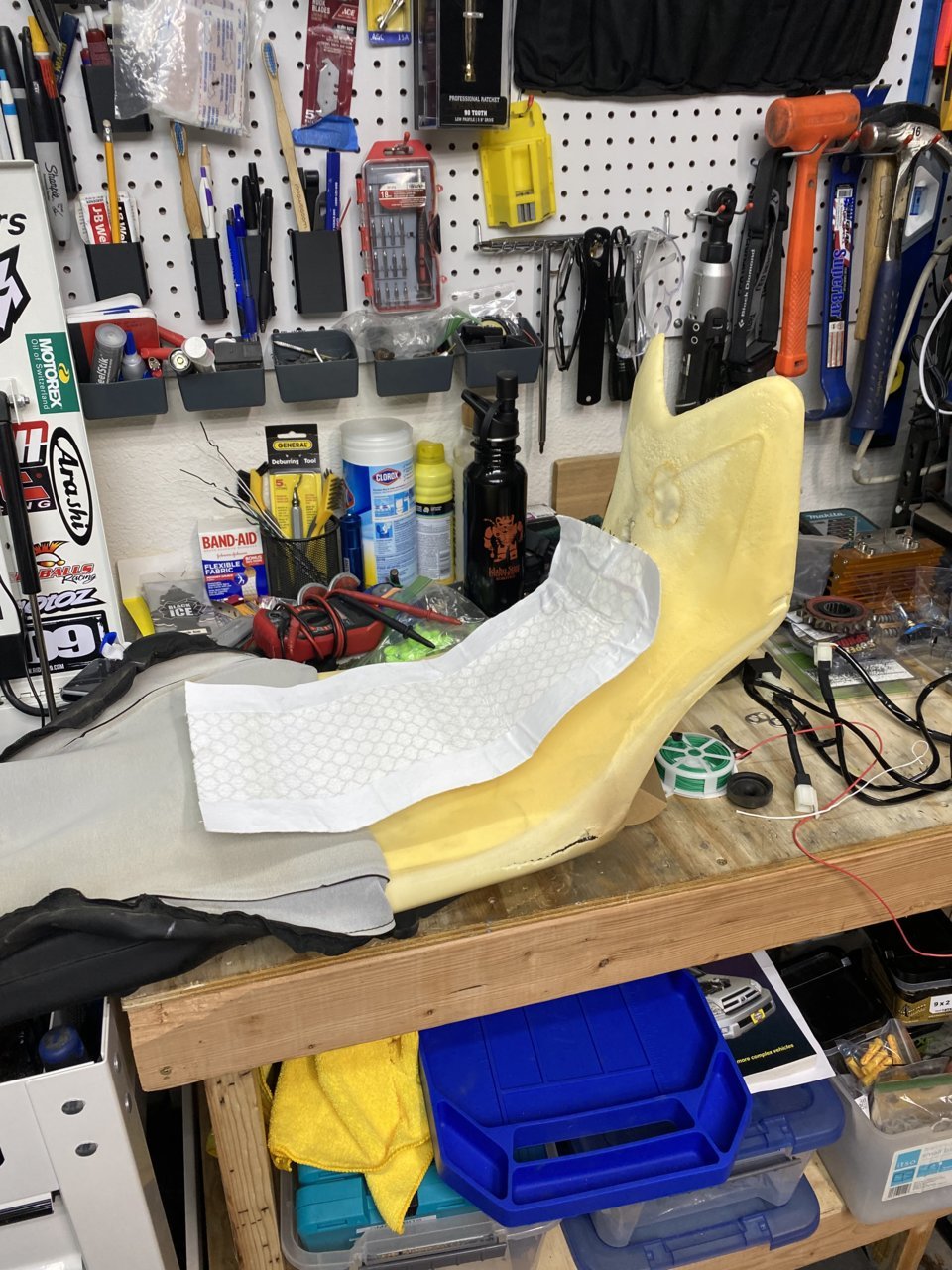

    But TODAY! I made a huge quality of life improvement to the BMW... Heated. Freaking. Seat.
    Bought a $19 kit off Amazon, a $35 pneumatic stapler from harbor freight and went to townnnn. (Stapler was also clutch for xmas lights this year). First step was to mark the underside of the seat in about 10 places to make sure when I put the cover back on it was lined up correctly. After that I started pulling staples, this part sucked. There were lots of weird spots where it was very difficult to get any kind of a tool in to get under the staples. Maybe 20 or 30 minutes of pulling later I was here:
    The seat pad has tape on the underside then came with more tape to go over top. I cut a hole through the seat and had it come out existing holes at the bottom of the seat.
    The kit came with a complete fully assembled harness, just snipped the lead wires to length and put eyelets on them to direct attach to the battery. A few zipties later a voila: heated seat.

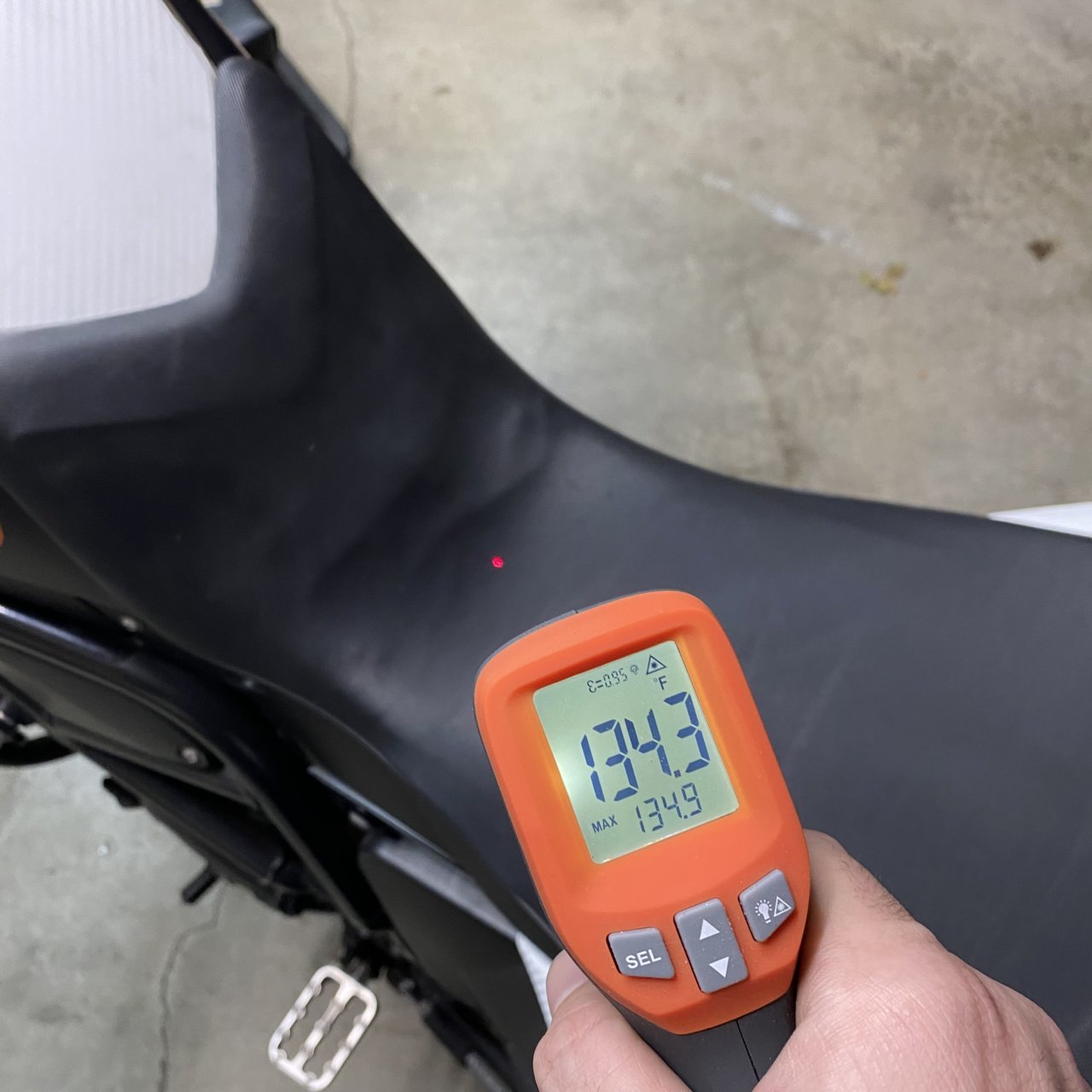

    On high it gets toaaaasty, about 134. It'll be nice as a pre-heat, but probably too hot to run for a while.
    On low though, it's perfect 100-105 degrees. This is going to be absolutely amazing on cold commutes. Why didn't I do this years ago.
    There's a little bit of lumpy-ness near the front of the seat where the wires enter the pad and the resistor is, but eh, it was an old-er seat anyway and was starting to stretch.
