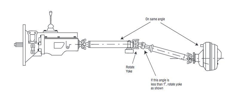

    Got the bearing in today. Tomorrow, the install. Will update. Biggest concern will be how to situate the driveline angles properly. Going to try to match the 1st and 3rd joints like this.

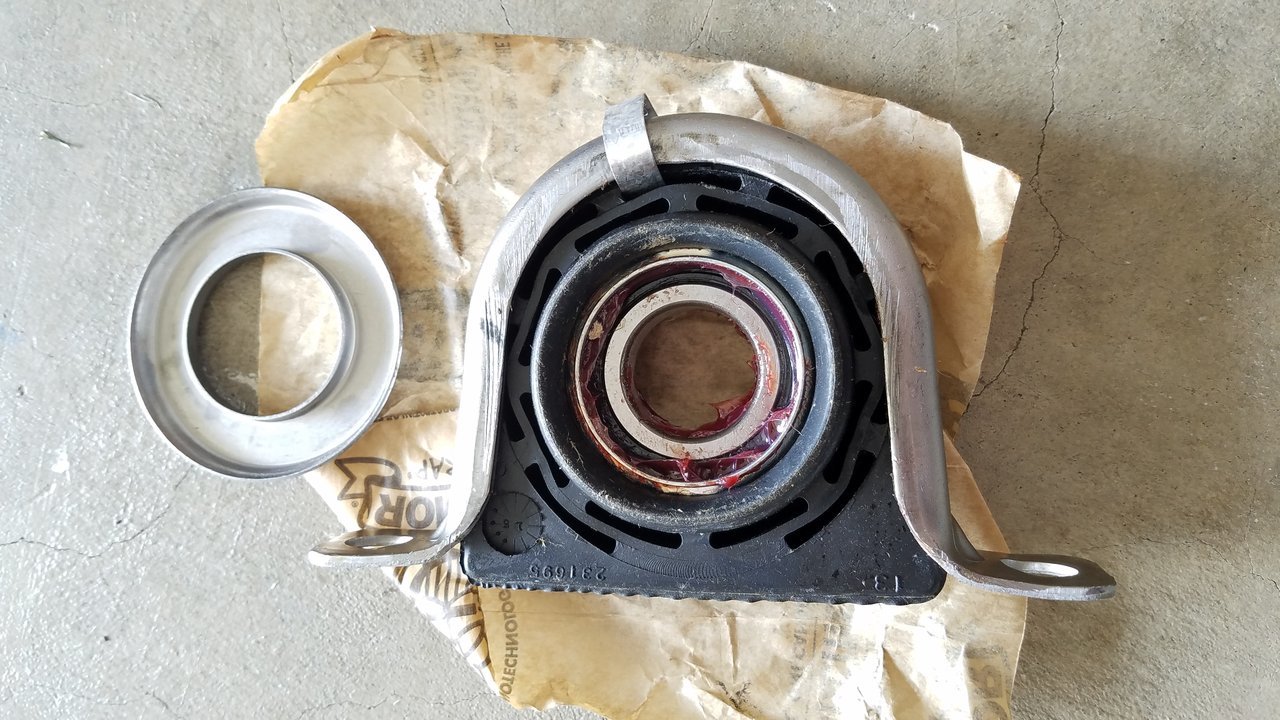

    I cant tell but does that CB have a sealed bearing or is it just grease that im seeing.

    Not sealed, but it does come with 1 dust cover lol. For $30 im gonna try it out

    I wouldnt recommend that. The slinger (dust cover) they provide is not going to fit properly on the tacoma shaft as its made for the ford.
