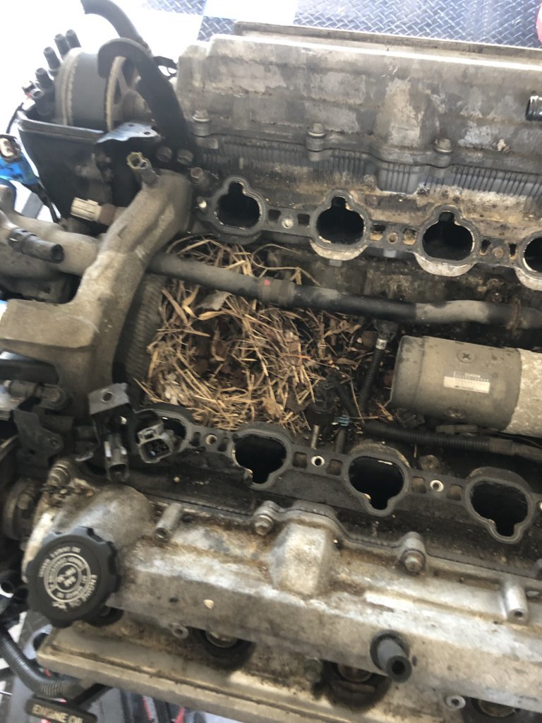

    Someone got a little comfy. Hopefully didn’t tear up too much of a mess on the harnesses and such.

    Yeah that harness was toast but engine connection are good n ground harness. So hopefully I won't have to do to much with the stand alone

    It was squirrels, there were acorn crumbs everywhere, they weren’t really interested in the harness, what killed the harness was age and heat cycling, connectors were very brittle and most were broken. The harness got replaced with one that integrated the engine to the truck’s electrical system, expensive but to me worth it, photo taken Dec of 2021.

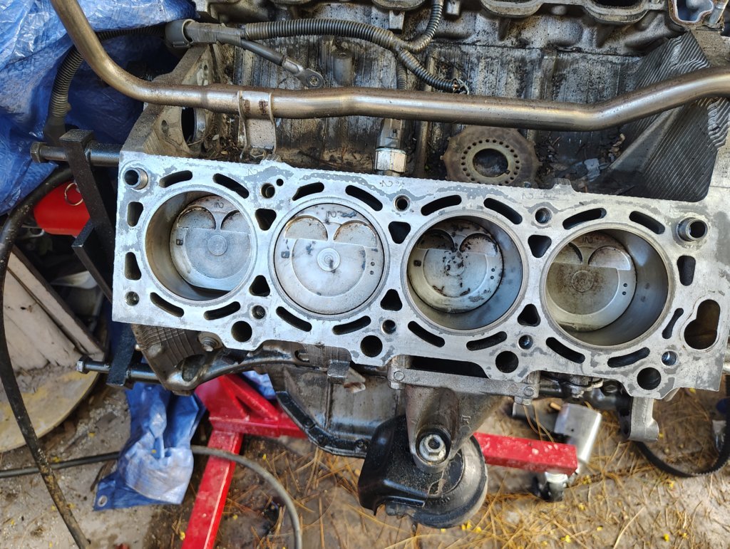

    Like new pistons gonna do others side. Getting cams just not sure from witch company yet

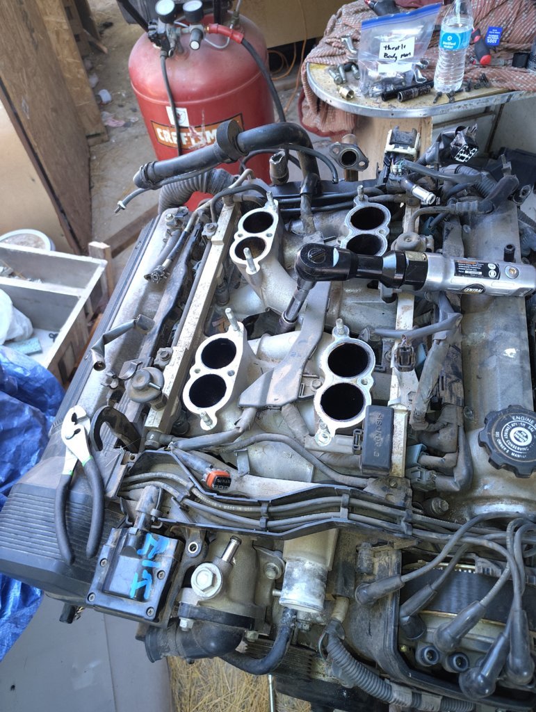

    It's great until ya gotta pull the intake manifold to change it.

    That is the only bs I've seen on the 1uz why why would they do this

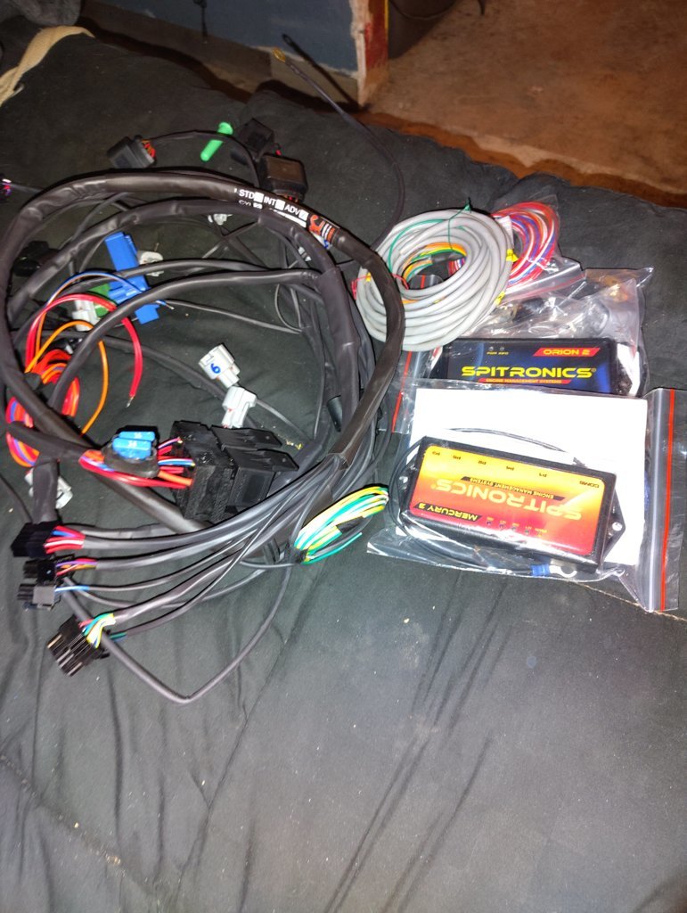

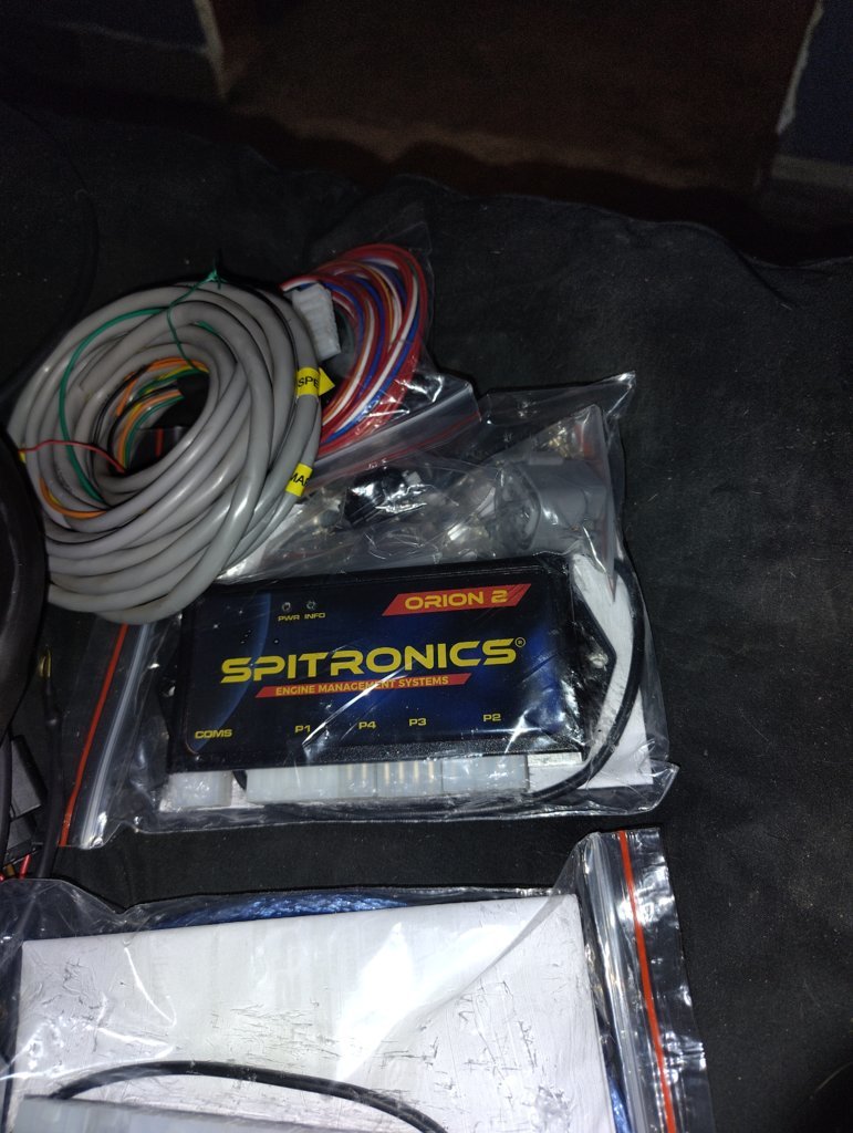

    Oooooh my tcu n ECU came from automotive racing group didn't take long connect and everything look good and numberd

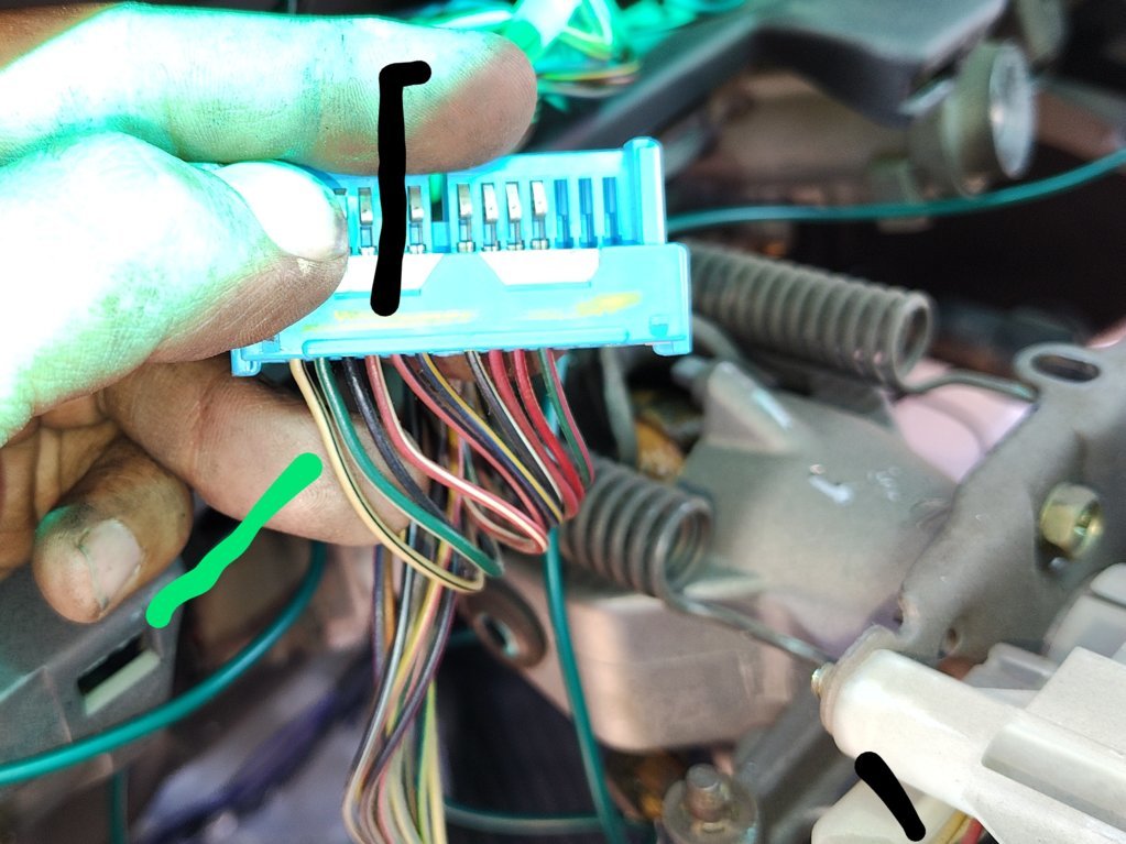

    Is black tac right

    I have no idea, you will need the wiring diagrams for a 95 SC400 or volume 1 of the factory service manual for 95 SC400 it will give the pin-outs for the connectors at the ecu. Recommend you go to a web site that strictly deals with 1uz swaps, like on FB there is a site 1UZ Toyota pickup/4 runner swaps lots of good info there, higher likelihood of finding 95 SC400 wiring diagrams and answers for your swap, for example my ecu (93 sc400) has 3 40 pin connectors, yours (95 sc400) has 5 connectors dont know how many pins, so im not any help. Some tribal information: in 95 the 1UZ went to 10.5 to 1 pistons, became interference motor, be on your A game doing the timing belt and use quality parts again the FSM would be good to have as well.

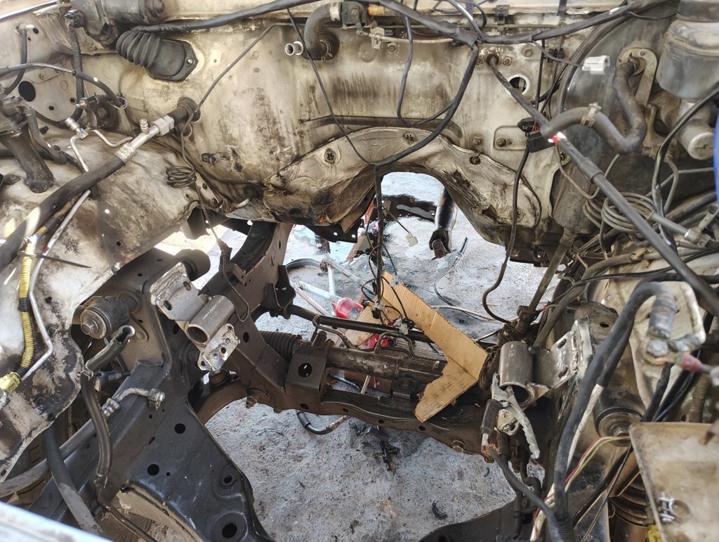

    Motor mounts r n hopefully everything got measured n good it lines up good new stand alone is all in wired
    Also I was reading some we're I could probably use Tacoma power steering pump any input on that thx
