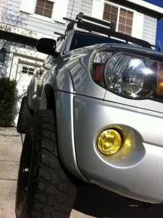

    I just got a pair of aluminum wheel spacers (2 inch) on my 2006 dcsb with a 3 inch spacer lift and aal, I heard people on here say that they are bad and if you get them get spider trax, aren't they both just a piece of metal with some screws and lug nuts? I'm not sure but I want to know your thoughts:D

    I have a 3 inch lift with 285/75/16s and they did NOT rub before, after the wheel spacers they RUB ALOT on the body so there is no way to fix it, this sucks. Now I have to take them off. :(

    I have baja champ black 16 inch wheels and yokohoma Geolander 285's

    Not at all!! i thought it would help if anything not make it rub :/

    Basically yes, but they are very critical pieces. If a spacer cracks or a wheel stud breaks, your wheel can fall off. Buying from a known brand like Spidertrax or All-Pro gives some assurance that there was some degree of quality control involved in the wheel spacer's manufacture.
