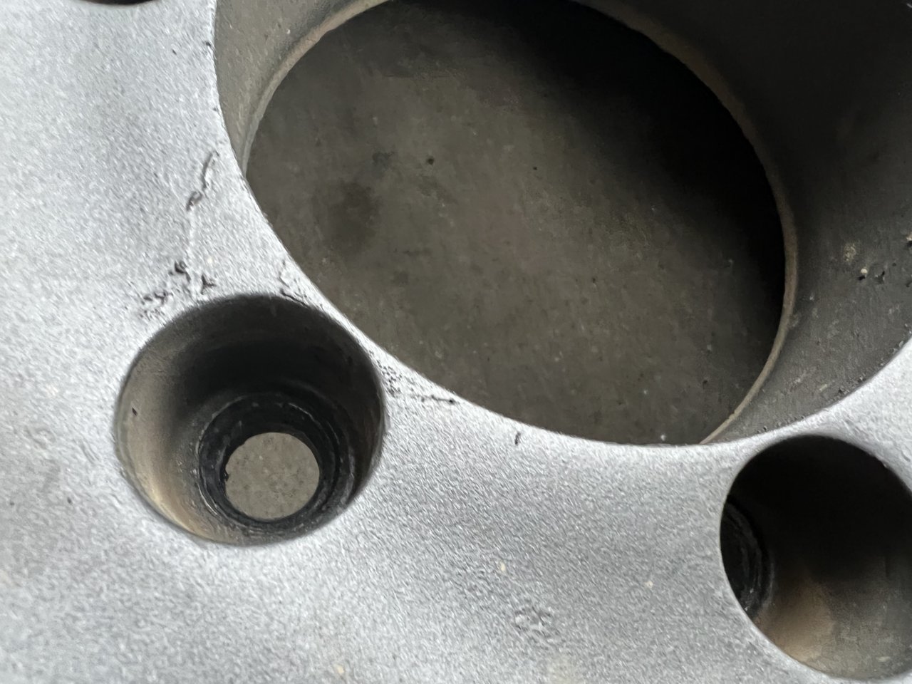

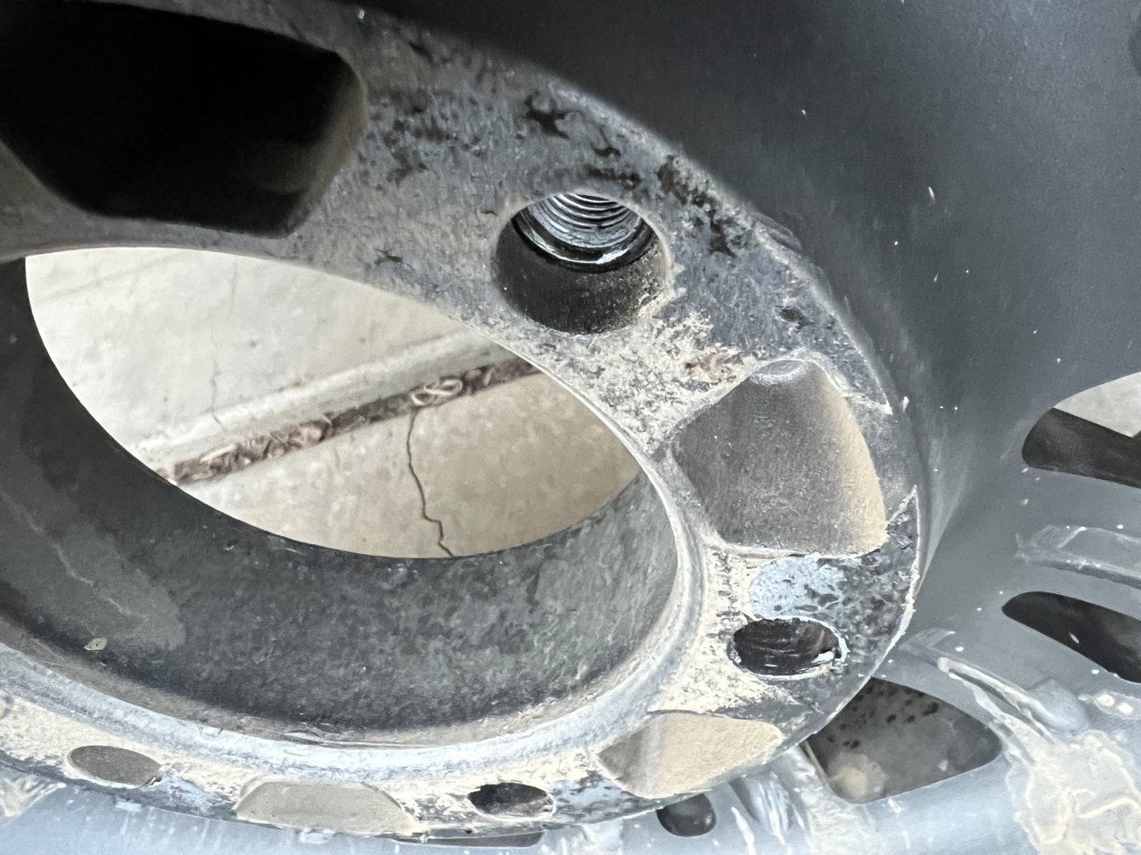

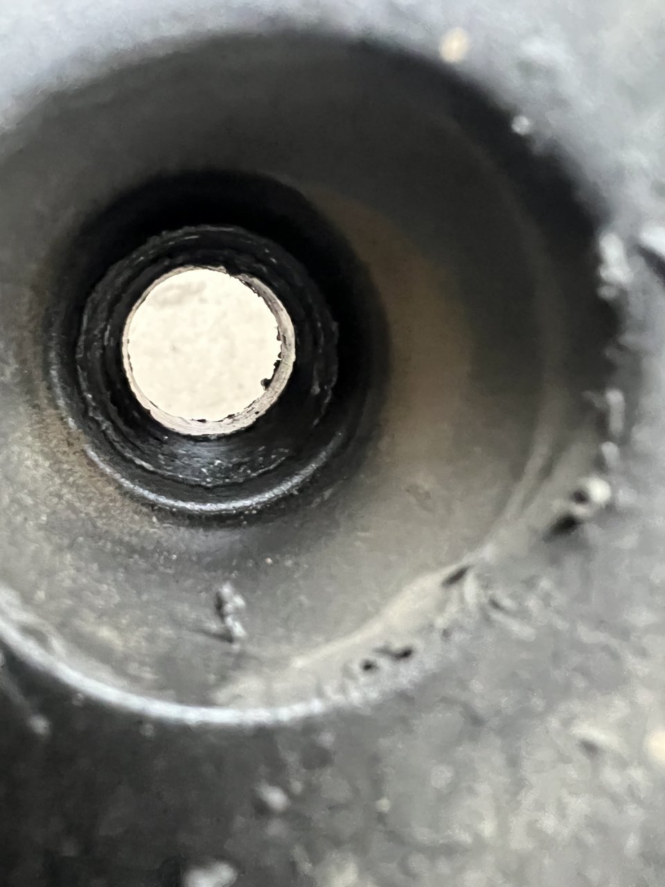

    So I’m in the process of putting on my winter wheels and tires, which gave me the opportunity to pull off my rear wheel/tires. The wheels are conical/acorn. The original front was damaged so much that it really altered how the wheel previously looked. But looking at both rears the wheels aren’t like OEM, and do take acorn/conical lugs.
    But what I did find is the SpiderTrax bolts are shorter than the ones in the ECCPP spacers I took off. And looking at how the black lug nuts fit might be why the wheel worked itself loose. Like I said I torqued the wheels to spec, and got a total of about 13 turns or so. But from the photos you can see how far back it sits. I ordered extended conical/acorn lugs (silver in the photos) and you can see how much more of the bolt they can catch. So that’s the route I’ll use moving forward.

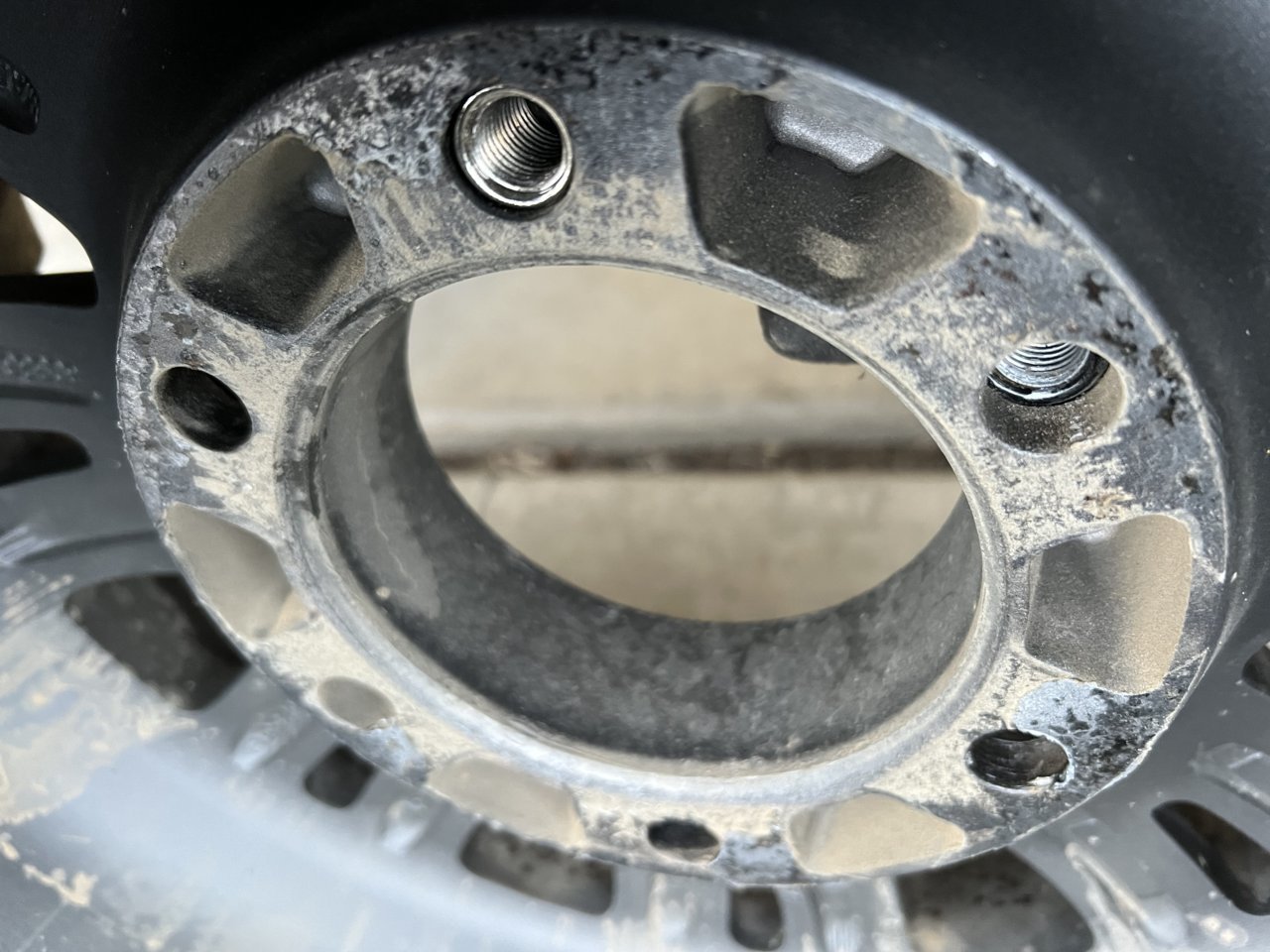

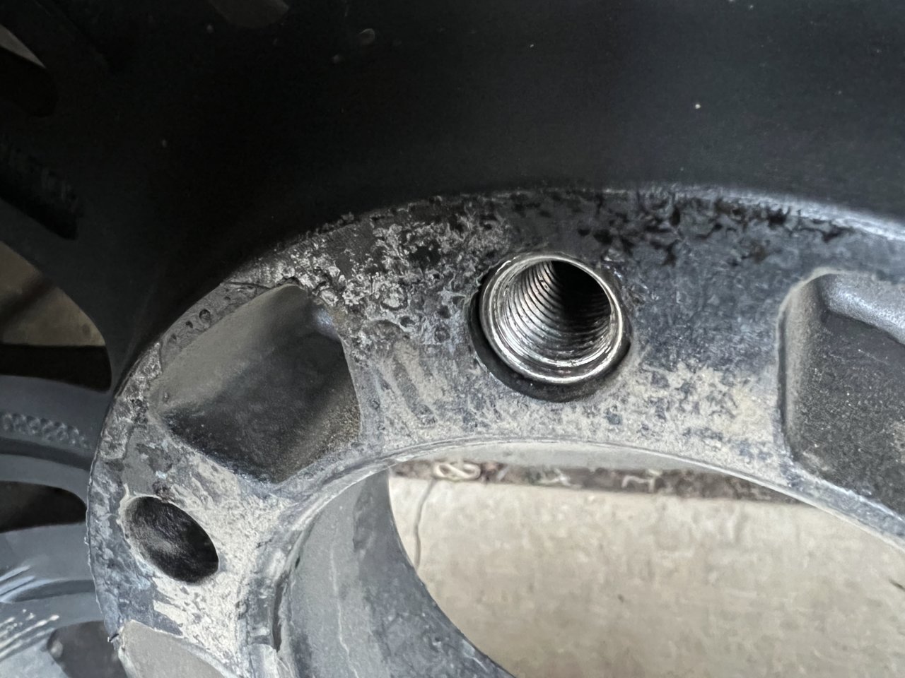

    I received my Bora spacers faster than I thought, so I put them on today. But before I did, I noticed why I think the SpiderTrax didn't work for "me" in this particular case. As I said above, I was using the right lug nut style. But the threads on the SpiderTrax most likely didn't have enough length for the wheels and lugnuts I was using (somehow I had no issues for over a month, with highway driving, and hitting a few trails). I used a Digital Caliper and found the studs on the SpiderTrax were 23mm, the Bora's are 31mm, and the ECCPP's are 35mm. The last two offer a lot more thread to grab. I still plan to run SpiderTrax in the rear, I will just use the extended thread lug luts I recently purchased. Now I'm just waiting on some snow to try out my dedicated winter tire setup.
