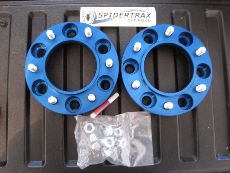

    How to add the Spidertrax 1.25 hub centric wheel spacers to a 2009 Tacoma. A few things you will need are a torque wrench and a decent socket set and you’re ready to go.
    I added the spacers to the front two wheels the weekend before and did not take any pictures, but the front and rear are basically the same, so you will get the idea.

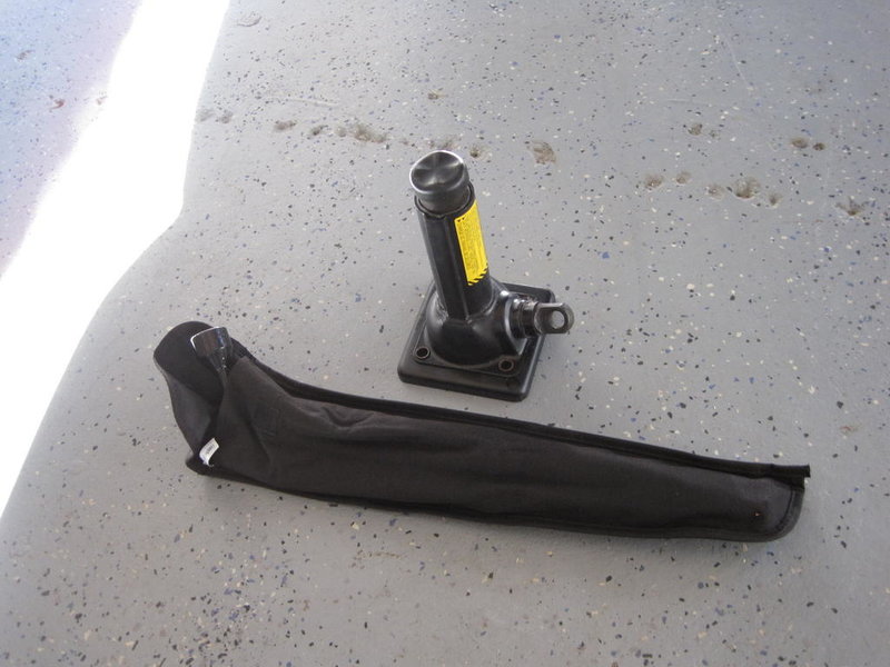

    Grab the factory jack from the truck and the bag of attachments.

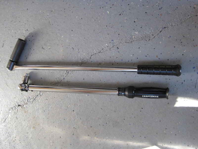

    CityTRD [OP] Active Member

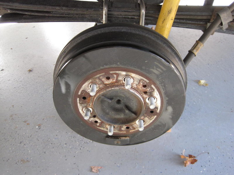

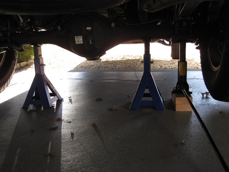

    I put a few pieces of 2x4 under the jack so I didn’t need to crank the jack up quite as much. At this point you can start the install, but if you have jack stands, use them. I am a big fan of them as the engineering is simple, and there are very few points of failure. That being said, I did the front two wheels without the stands just using the factory jack.
    Now that the truck is up on the stands I am ready to remove the rear wheels.

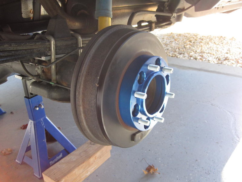

    Since I live in New England, a breaker bar and PB Blaster are two essentials to any shop. The rear wheels had a small amount of rust that was holding them firm to the hub so I sprayed a bit where the back of the wheel meets the hub and let it sit for a half hour.
  3. Dec 13, 2010 at 9:15 AM
    CityTRD
    Sep 22, 2009
    #23151
    43
    E
    Southern CT
    TRD Offroad
    2.5 Lift, Tint, De-badge, Bed Cover, Leather, Spidertrax, Extra D Rings, Weathertech...

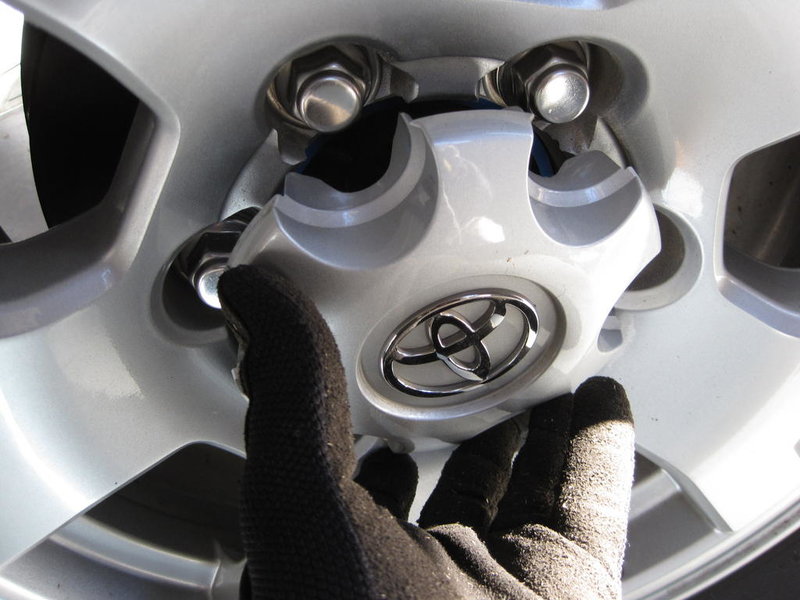

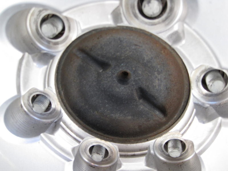

    Popped the center cap off.

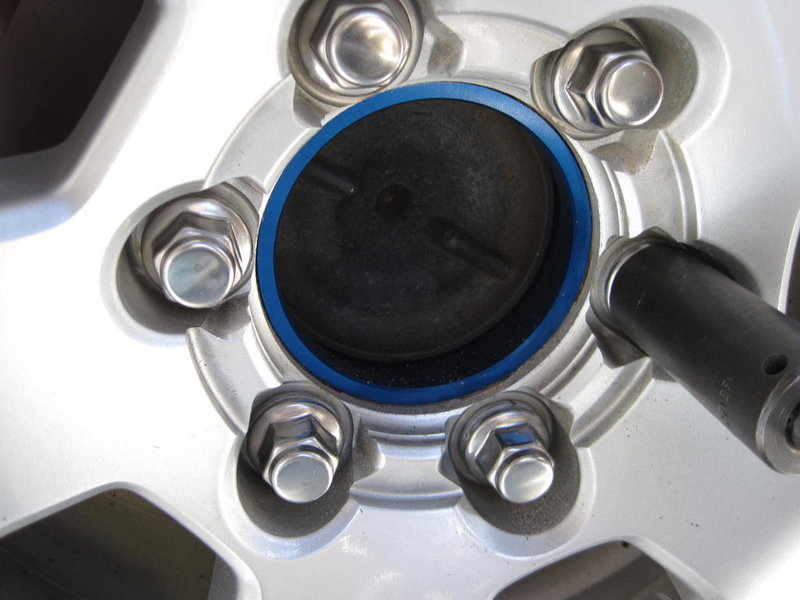

    I used the breaker bar to free the lug nuts.

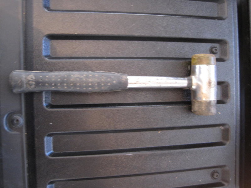

    At this point all the nuts are off but the wheel is still attached, so a persuasion tool was in order.
    After the wheel was off, I knocked off the heavy rust with a wire brush, there was not much.

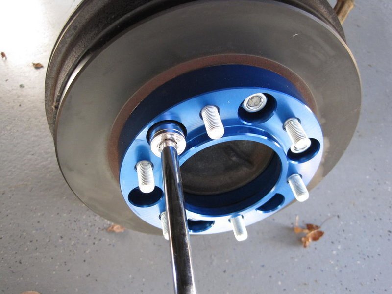

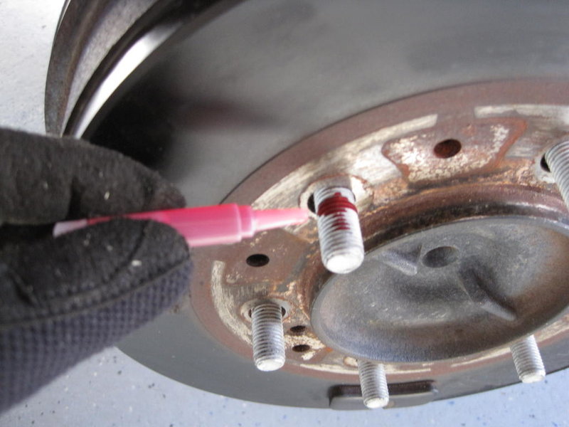

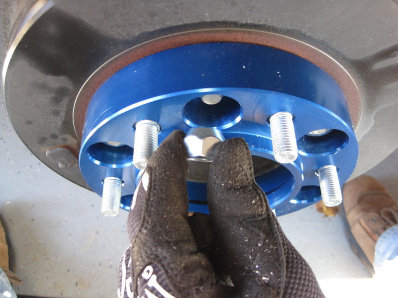

    A note about Loctite. You want to put the Loctite on the bolt were the nut seats, where its going to sit after its all the way torqued, as shown in the picture.

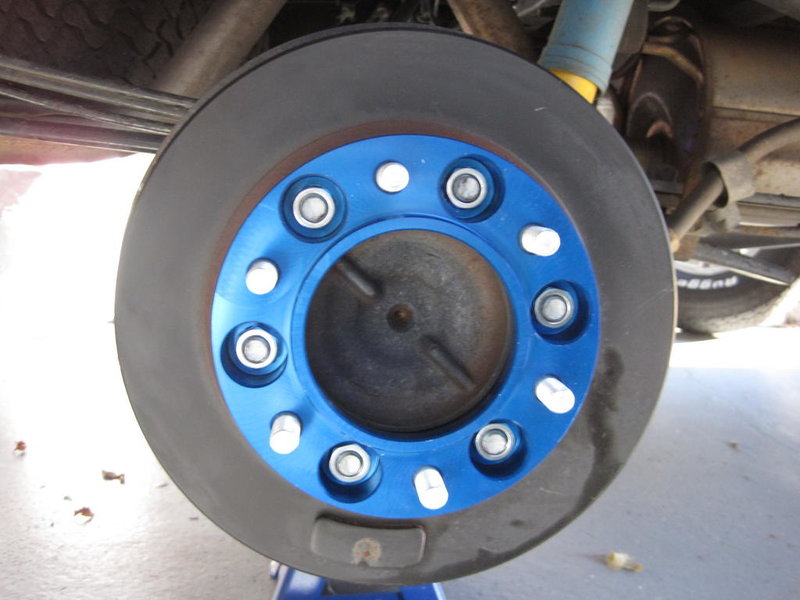

    After you apply the Loctite to all the 6 bolts, slide the spacer on.
    Then with the tapered end in, spin the nuts on. I used a small socket here just to spin the nuts on the lugs as there is not enough room for your fingers to get in there. I used the socket just to get the nuts spun, but did not make them tight. If you snug it with this ratchet, then move to the torque wrench, you will mess up the torque reading. I guess you could do this whole part with a torque wrench, but a small socket wrench is easier to start. Whichever you prefer.

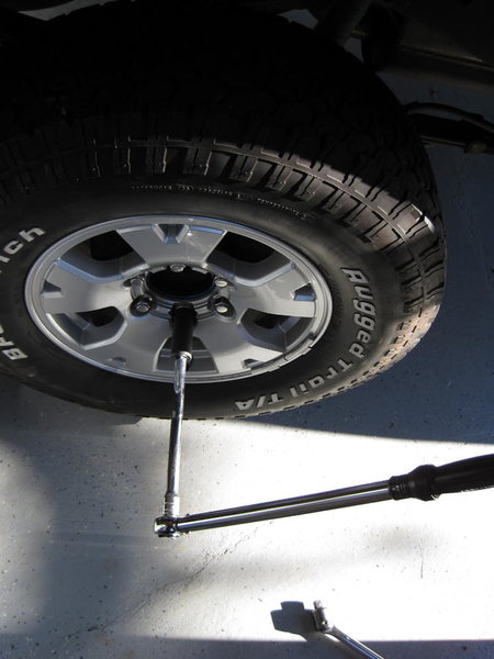

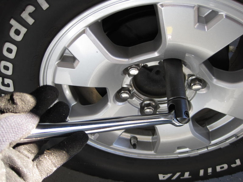

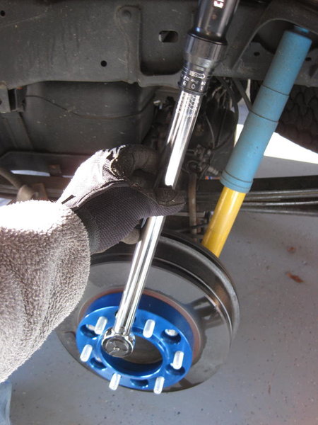

    Torque all six nuts in a star pattern to 75-80 foot lbs.
    Once the spacer is installed and torqued to the correct amount, re-install your wheel and torque your lug nuts 80-85 foot lbs.
    Pop the center cap back in.
    You are done, for now at least. Spidertrax recommends checking the spacer bolts after 50 miles. This does not mean put a wrench on them and break them free and re-tighten. What this means is put a wrench on the bolt and put a few pounds of pressure toward the tight side, if nothing moves, they are fine. You don’t want to break the Loctite, you just want to confirm they are still snug.

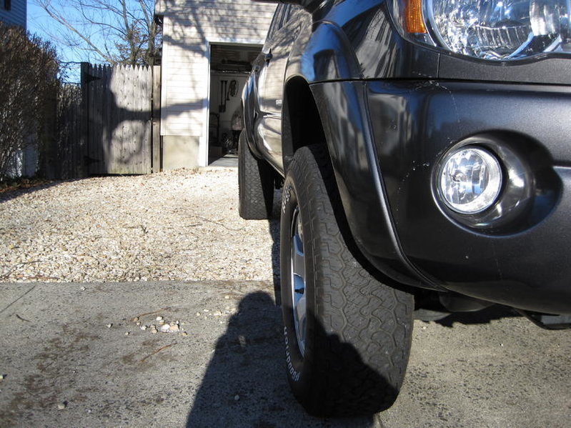

    What's the benefit of these with stock wheels and tires?

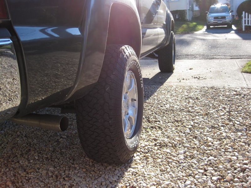

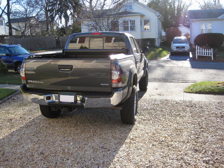

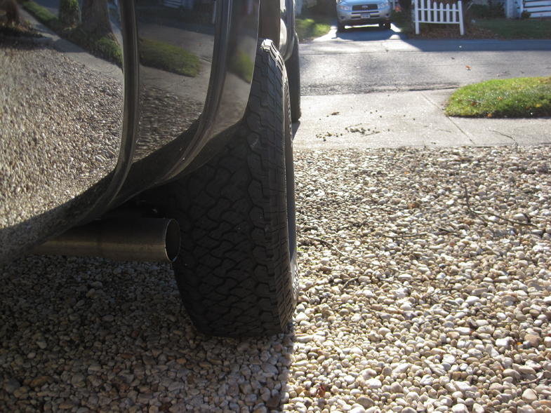

    The final product. The truck is on stock rims and tires.

  8. Dec 13, 2010 at 11:12 AM
    KeithB
    KeithB Well-Known Member
    Jan 6, 2009
    #12299
    864
    Keith
    Cheshire, CT
    SWB '09 Tacoma DCSB Sport 4x4
    Wheels and Tires: 17x8" Ultra Goliath wheels with P285/70R17 Falken Wildpeak AT3/W tires, Suspension: Icon coilovers set at 2.5", TC UCA's, 1.5" lift 3 leaf pack with overload left in, 3* shims, carrier bearing drop, Bilstein 5100 B110 rear shocks Other: TRD SS exhaust, Pioneer AVIC 4100 H/U with Android Auto (awesomeness), sat radio bluetooth, Accessories: Toyota roof rack, black Toyota running board steps, cargo divider, weathertech floor liners, Literider roll up soft tonneau, thule bars over tonneau, USB ports front and rear, seat heaters, birddawg mirror riser Cosmetic: window tint, grillcraft black mesh upper/lower grill, eyelids, tinted tails and third brake light, vinyl armrest in doors, Clazzio black seat covers with blue stitch, Redline steering wheel wrap Lighting: fogs only mod, bed lights in pockets, back up lights, amber interior accent lighting, amber 10" LED light bar in hood scoop, 33" LED bar behind the lower grill, amber lamin-x on fog lights
    Wider more aggressive looking stance.

    Eventually, I will be going with 285/75/16 on the stock rims and wanted to make sure I will clear the upper control arm. It looks wider and a bit more aggressive as Keith said.

    Thanks man. I have not noticed any changes in the way it handles, at all. The tires actually look a bit wider since I added these. Its not a night and day difference, but it does look like the truck sits better - more aggressive. So far I really like them and think it was worth the money. I read all the other posts about them, people loving/hating and it seems that the people that didn't like them, didn't actually have them. I have about 500 miles on them so far and no regrets.

    Nice post! Looks nice and even better when you get those 285s. Nice tools too :)
    Is that a craftsman breaker bar? Who has the best price on these?
    Thanks.
