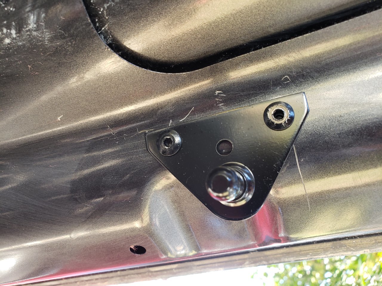

    sir, started my installation late this evening and have the fender brackets installed ( I believe in the right location. Center furthest indentation towards the firewall).
    But when locating the top hood brackets I couldn’t get them to lay flat. And the point of the triangle brackets are at an angle off the raised hood support. I hope I’m drawing a good enough word picture.
    I have the hood set at 5.25” higher than hood support rod.
    Do I need to raise the hood all the way up to 6” to get the right angle?

    @JAL, The hood bracket should rest against the inner side of the hood reinforcement, as shown below. It should line up like this no matter the hood height, as the reinforcement cross section is unchanged for most of the hood length. The bracket will not be vertical, it will be angled like the side of the reinforcement is angled - is that what you're concerned about? Can you post a photo of how things are lining up for you? (Bottom photo has a different bracket, but same basic design)/

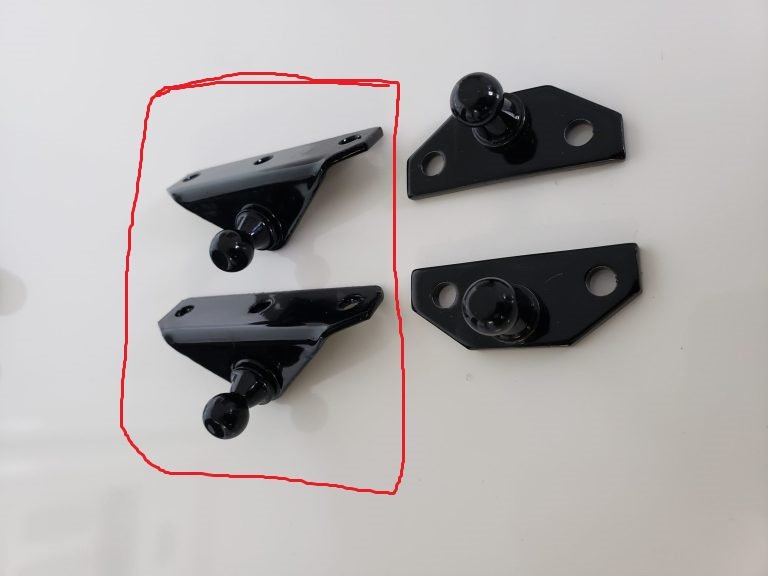

    The bottom brackets circled in red mount with 3 rivets each? or are there any threaded holes like in the Rav4?

    See their detailed install PDF. Middle hole not used.

    The brackets shown in photo are representative of our kits, the actual 3rd Gen brackets are a little different. Two rivets hold each fender bracket, two rivets hold each hood bracket.

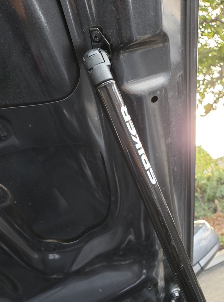

    Finished!!

    Set mine to 5.25” over normal just in case ditch lights and lift later on down the road.
