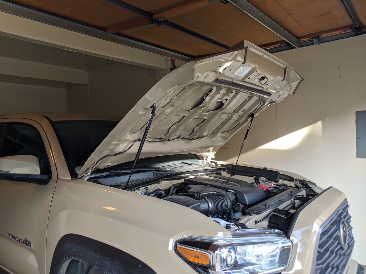

    Just finished mine. Had to make a trip to harbor freight for a bigger rivet gun, but other than that, pretty easy.
    Video of it opening
    https://youtu.be/aIUYdTFyGyE

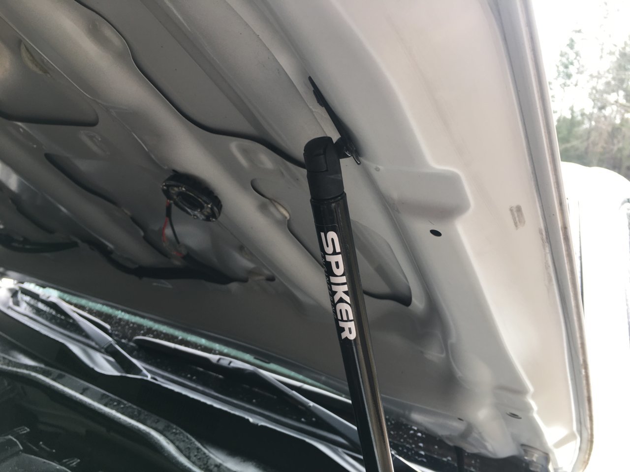

    Looks great! And love the sticker :thumbsup:

    Thanks for the video - looks great!

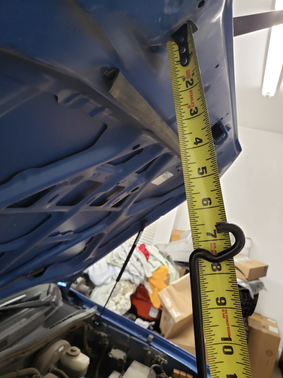

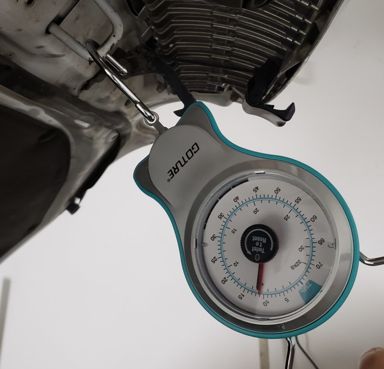

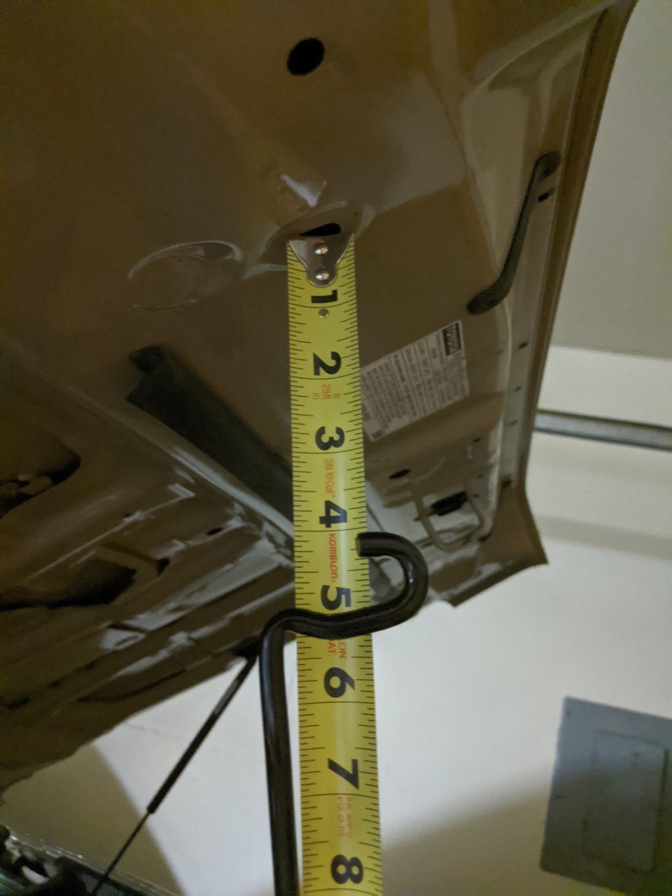

    We found in the past that there are some minor variabilities from truck to truck and installation to installation, so to help us fine tune our products, it'd be great to get some feedback from those who already installed our hood struts. If you can post the following info, which would require just a tape measure and a fish/luggage scale, that would be great:
    1. Height of hood above stock prop rod height (first figure below)
    2. Pull force to get the hood to start closing (second figure)
    Thanks in advance!
    Height above stock prop rod:
    Pull force (pull perpendicular to hood):

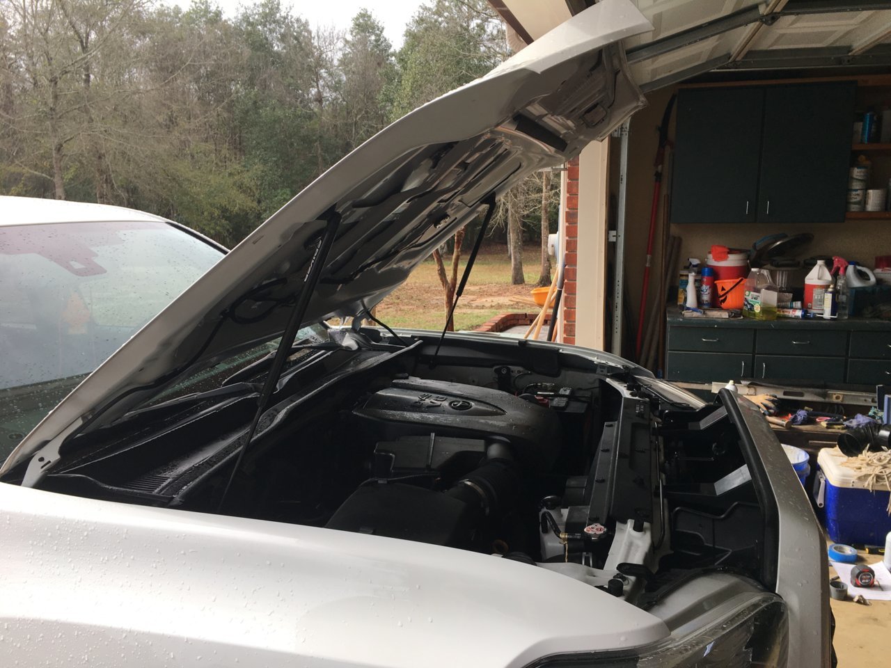

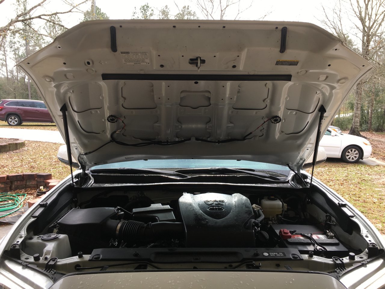

    Don’t have a scale so I’ll just post hood height.
    5.25” above normal support rod height.

    I start to get motion around 14lbs and 15lbs of continuous force is when it closes

    You forgot to ask for temp. This time of the year it might matter. :)

    Good point, we forget about that here in CA... The force output will definitely vary with temp, around +/-10% for most cases, closer to 20% for those doing this at -30F (you know who you are!).
    So yes, a temperature reading would be helpful too, especially if it's far from the 50-70F range.
