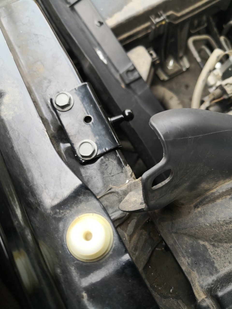

    I think rinut looks more stock

    Well done - what size rivnuts did you use? Did you use them for the hood as well?
  4. Jan 23, 2020 at 1:44 PM
    #244
    Alfamua
    Alfamua Well-Known Member
    Oct 17, 2013
    #114692
    144
    Alfa
    Sacramento
    17 TRD OR
    Fox 2.5 coilovers dsc. Fox 2.o with dakar. SSO slimline stage 1 and 2
    M6, want to match 10mm bolt.
    SpikerEng[QUOTED][OP] likes this.

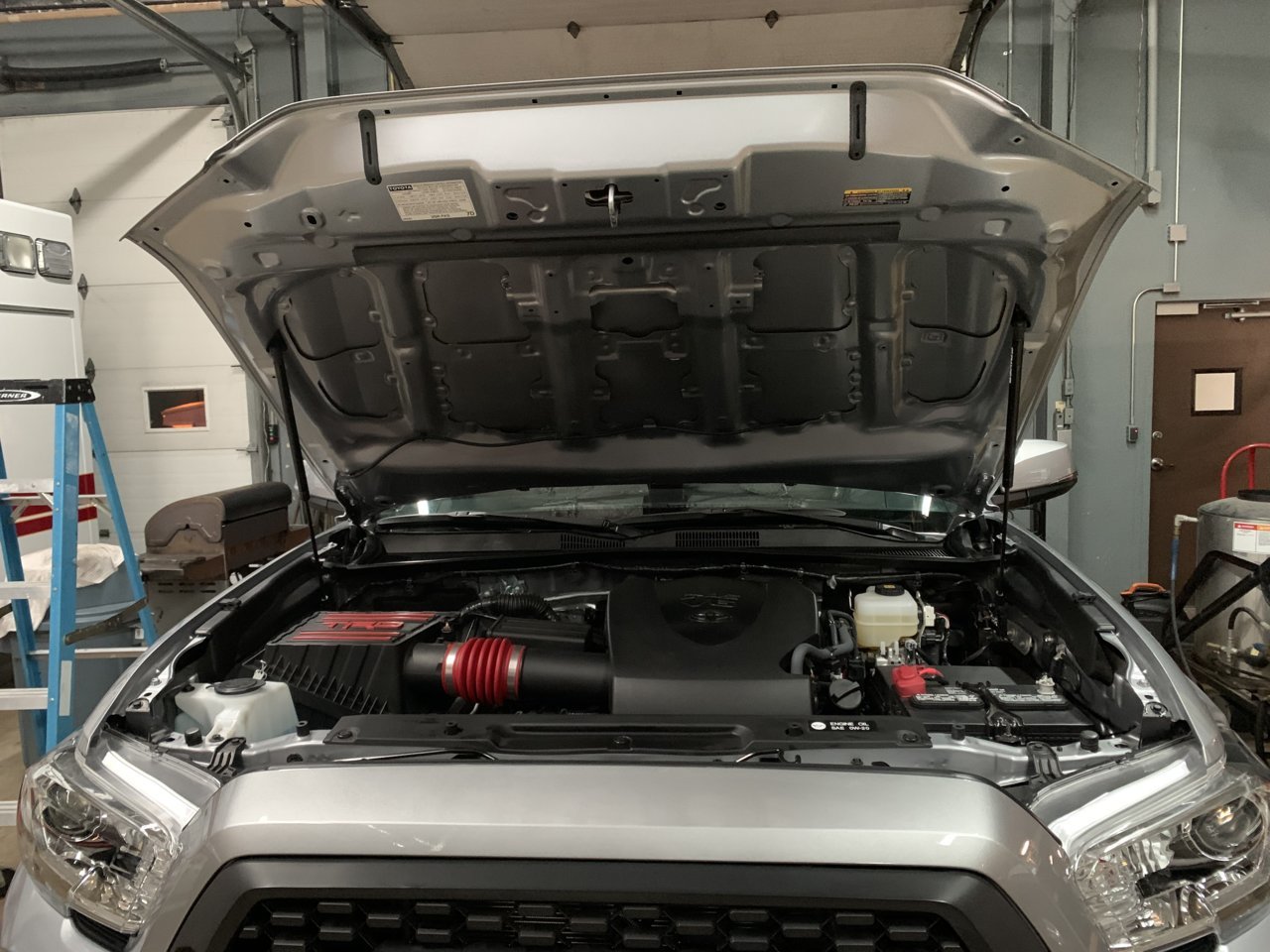

  15. Jan 26, 2020 at 5:25 PM
    #255
    BCfiremedic
    BCfiremedic Well-Known Member
    Oct 31, 2019
    #309576
    125
    Chuck
    NWA
    2019 Silver Tacoma DCSB TRD OR
    Finally installed mine today! The first hole you drill into the hood is a little daunting, but after that it’s all pretty easy. Instructions were pretty good, looks nice, and works great!C5B3CD4B-CB90-4BD5-A989-D37942322482.jpg

    Chuck, did you have to do any trimming to clear the TRD air filter box?
  17. Jan 28, 2020 at 2:20 PM
    #257
    BCfiremedic
    Oct 31, 2019
    #309576
    125
    Chuck
    NWA
    No sir, it works perfectly in conjunction with it. I shut it real slow the first time ;)
