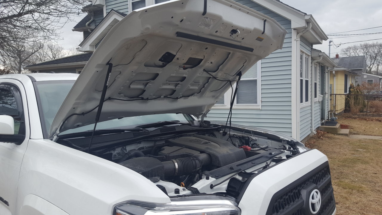

  4. Feb 6, 2020 at 8:49 AM
    #264
    SpikerEng
    SpikerEng [OP] Well-Known Member
    Feb 4, 2019
    #281767
    790
    Leon
    Portland, OR
    Looks great! Does that wire on the driver's side get close to the strut?
  5. Feb 6, 2020 at 9:06 AM
    #265
    FRESH OJ
    FRESH OJ Well-Known Member
    Jun 26, 2019
    #297514
    106
    Rhode Island
    2017 Tacoma Sport
    Thanks! Great product. The wire is fine for the time being and doesn't interfere with the strut but does need to be relocated when i have a chance. It's for a scoop light bar

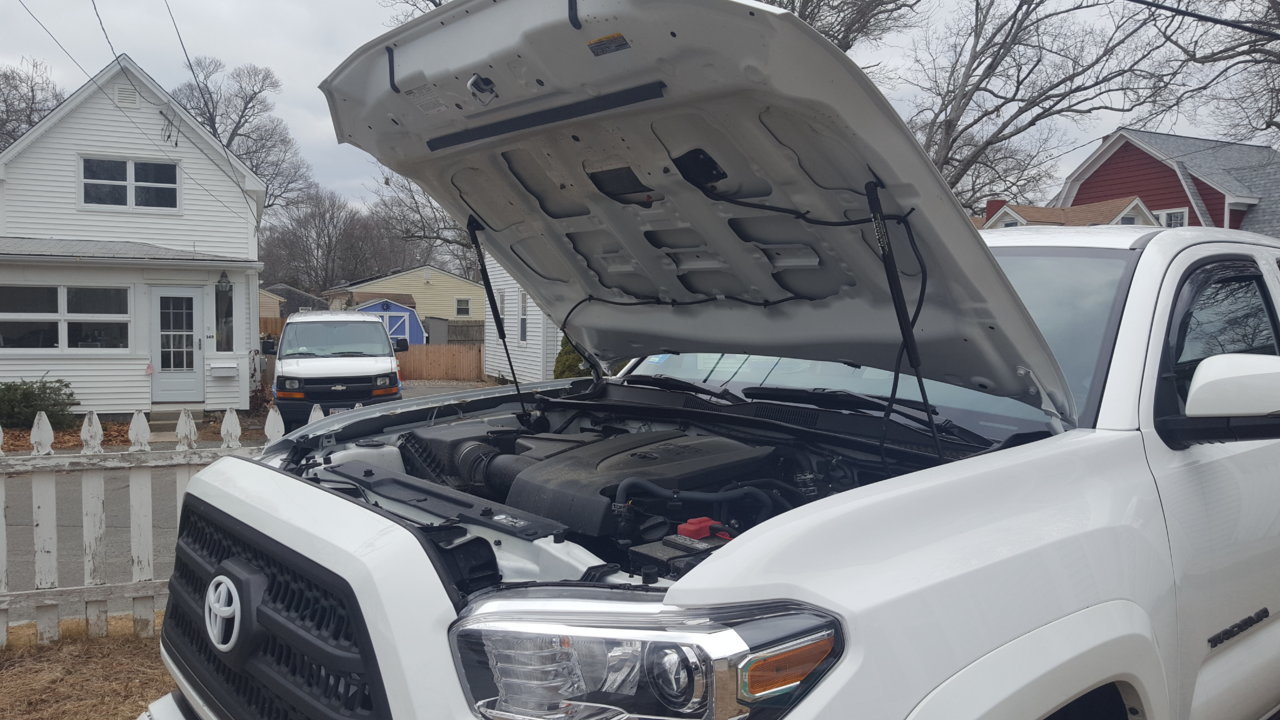

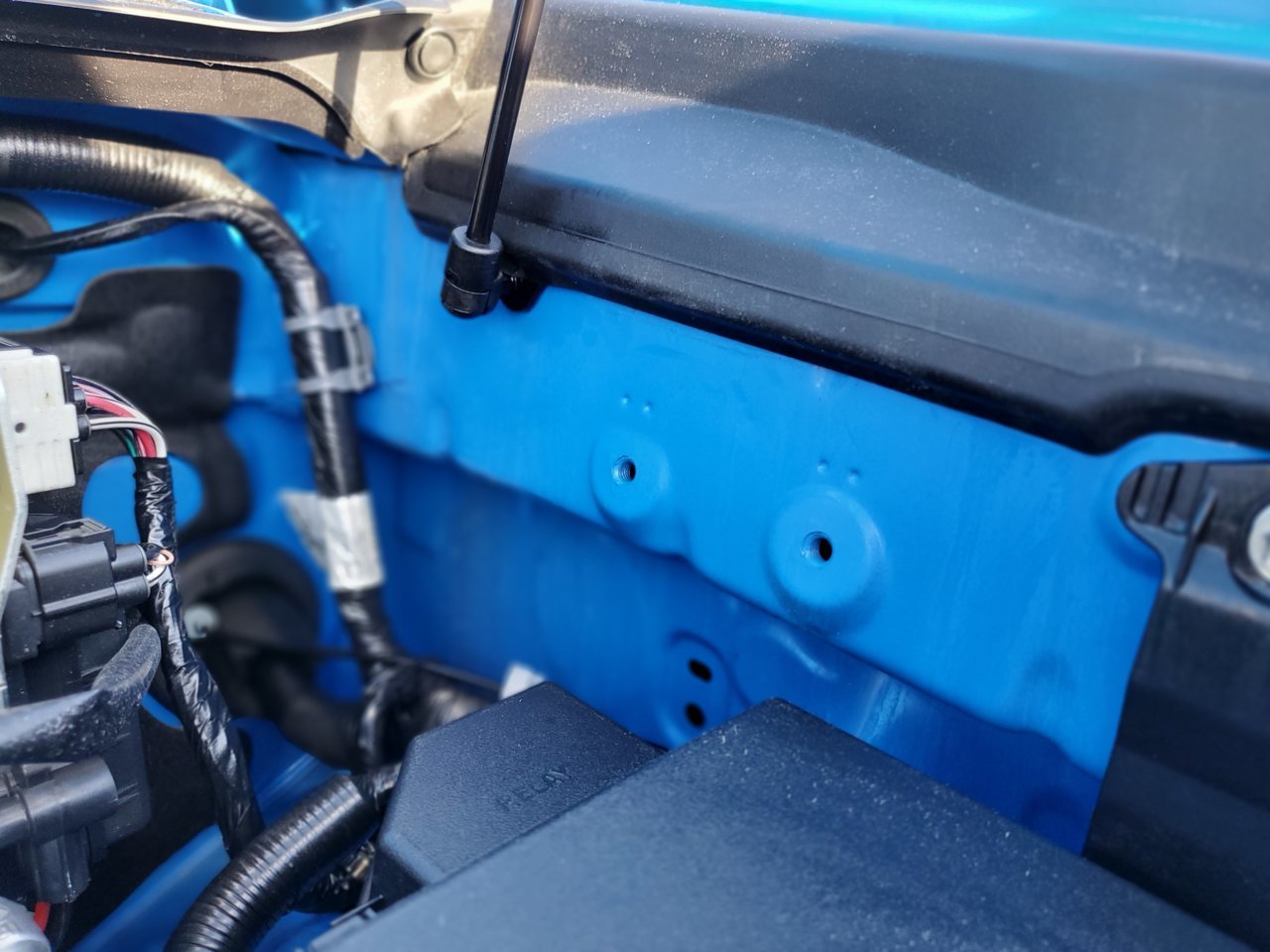

    I finally installed my Spiker Engineering hood struts. I have been waiting for the snow to stop and today is sunny and kinda cool!
    These are easy to install. I used a #10 drill bit which is slightly larger than a 3/16" bit. I set the height for an extra 6".
    I used this Arrow rivet gun for the 3/16 rivets (Yellow Tip).

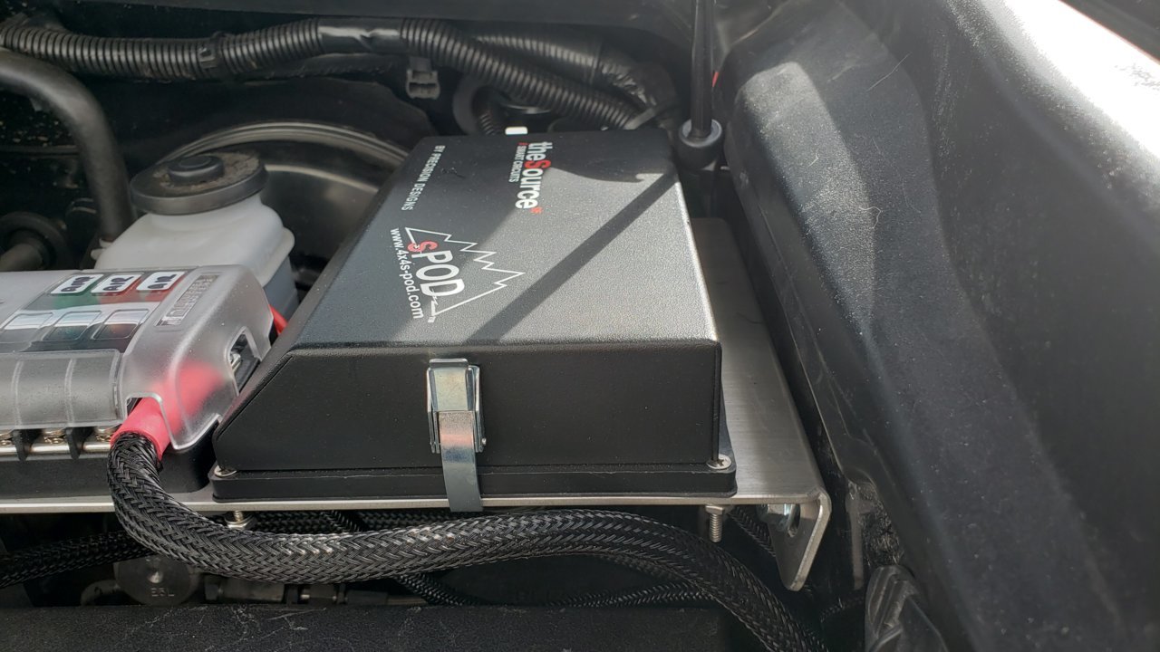

    Has anyone installed a set in a vehicle that has a PowerTray and/or Genesis dual battery set-up?
    I am curious about clearance with these two items

    I have them in with a Powertray for sPod. It's real close, but I don't see any issues.
    SpikerEng[OP] likes this.

    @crashdb, would you mind posting a picture of your setup, for future reference? I'm trying to maintain a database of what mods work or don't work with the strut kit, so this would be very helpful.

    Sure thing. Wish I had known. I replaced a Switch Pro with this sPod.

    How smooth do the struts open the hood? Is it easy to close under the hoods own weight?

    Two pics. Up close you can see the sPod lid is close to the strut, but it doesn't hit. sPod is brand new and there's no marks on it.

    Smooth as butter. I can close with my little finger.
    Here's a shitty video I made demoing just that (was practicing first-time editing)
