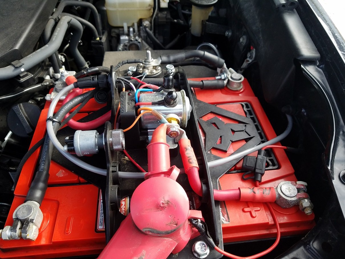

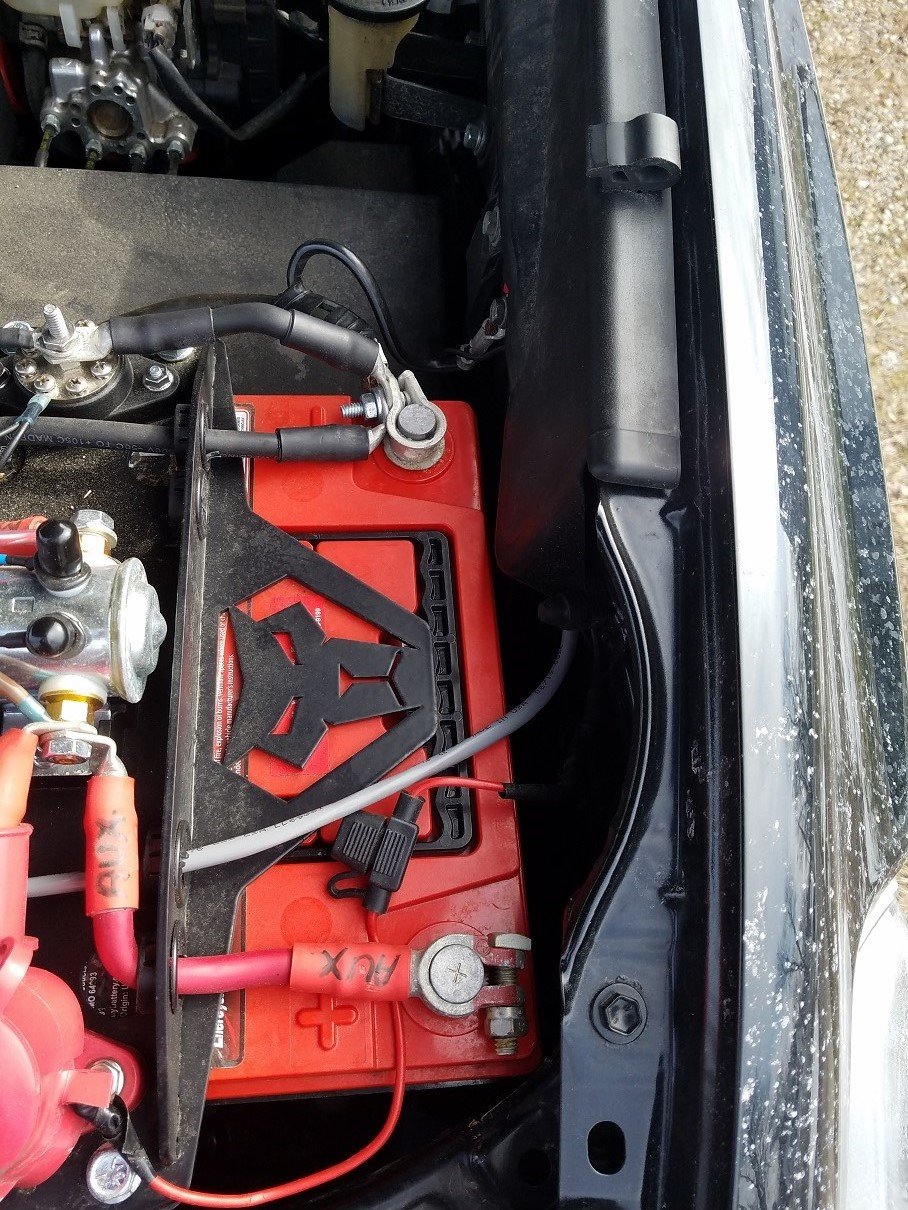

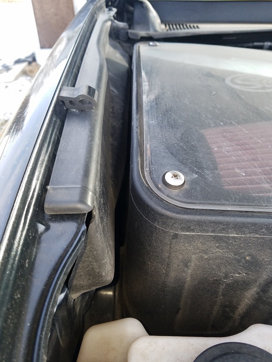

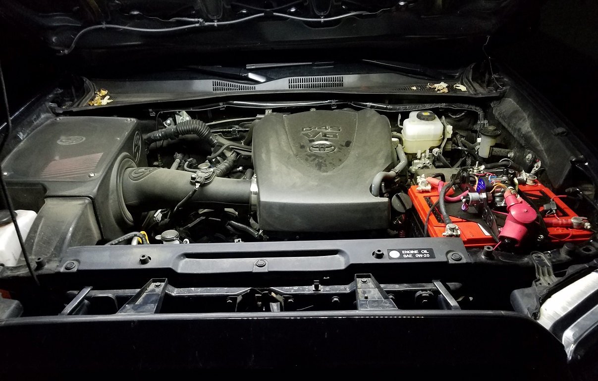

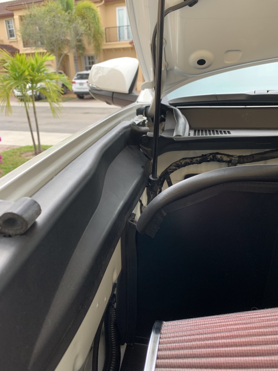

    I think the current driver side is fine, but depending on what you do with the powertray and solar charge controller, that may change.
    The passenger side will need some work - the CAI will need some trimming; it looks similar to @Profounddiver 's setup, you can see how he trimmed the air box:

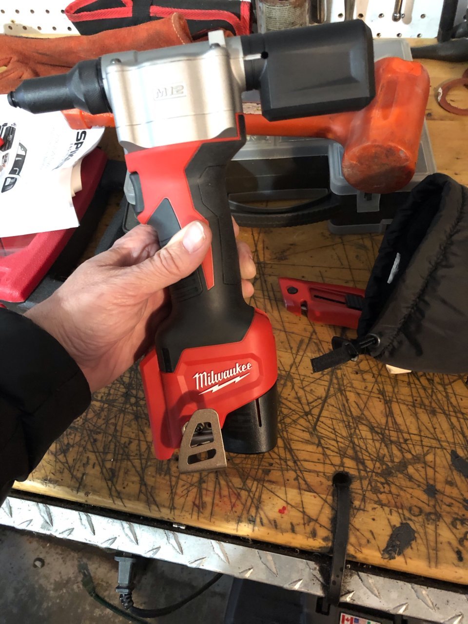

    What a great looking truck, even better now that it has the hood struts :). And those Milwaukee rivet guns are awesome, they make riveting fun. Enjoy!

    What rivet gun are people using. Trying to install now with my harbor freight red handle gun and it won’t pop the rivets. Not sure if it’s just worn out or not strong enough. The big gun I have I’d have to take the hood off to use...

    I used this one from Amazon.
    https://www.amazon.com/dp/B0039697ME
    You are using a 3/16 tip, correct? Not that I would ever forget to check and have trouble with my rivet gun not popping the rivets. :(

    I used this Arrow rivet gun for the 3/16 rivets (Yellow Tip), from Home Depot.

    If you need to make room to use the big gun, you can temporarily raise the hood higher to get the needed clearance to drill and rivet the fender brackets - then lower it back to the desired height for strut and upper bracket installation.

    I made a noob mistake. Was using the incorrect tip. Got it installed. Thanks guys!
