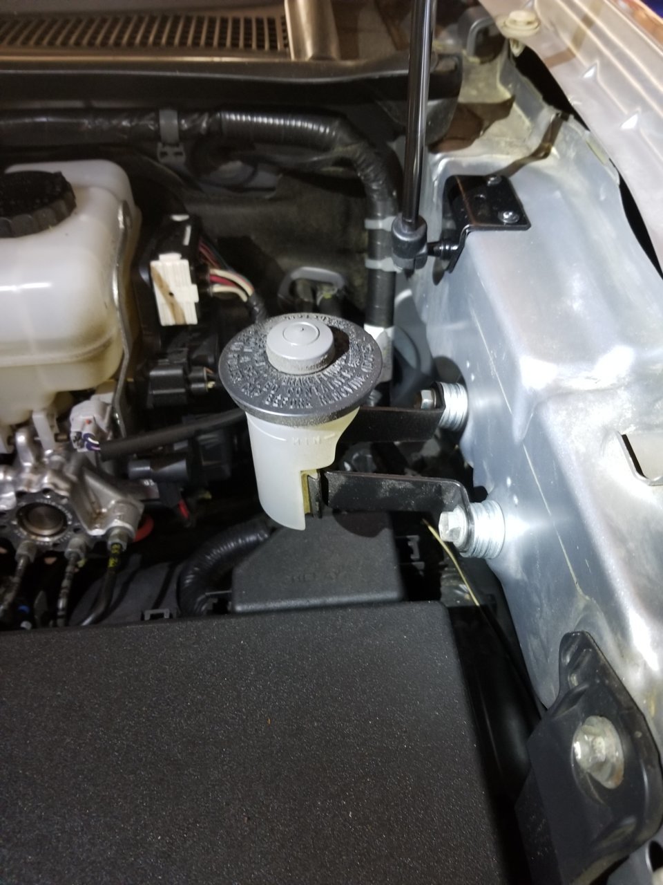

    Installed mine last week. Work great. I went through this thread to see if anyone had the clearance issues I did and doesn't look like anyone has put these things on a manual truck. In my '16 manual I had the driver's side strut coming down on the clutch fluid reservoir. I spaced the reservoir off the fender with stacked washers for now.
    Rivets installed well with this gun. https://www.amazon.com/dp/B07VPDVXHP/ref=cm_sw_r_apa_i_vxpNEbY2JYFTK
    Can definitely tell when the rivet is pulled tight and about to pop. Takes a little effort but zero problems.

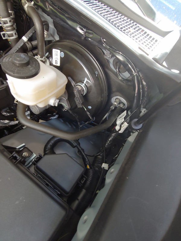

    I have a MT, but newer (2019) use a different MC arrangement.

    Thanks for the picture on spacing out the clutch reservoir, good and simple solution! :thumbsup:. If you don't mind, I'll add your photo to the installation instructions in case anyone else comes across this issue.

    Took some after install pictures today to show how the clutch reservoir is not a problem for 2019+. I think 2018 as well, not sure. Anyway some different perspectives:

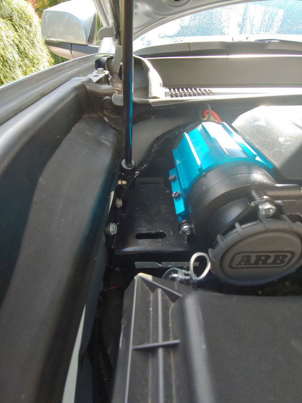

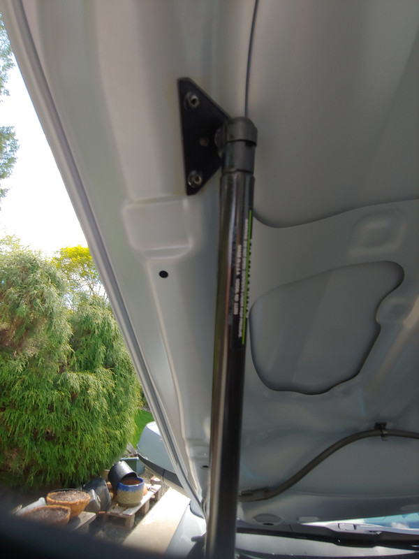

    Pics two and three show the bracket backwards than in the install video. Does it make a difference on the way the pointed area of the bracket faces? The video shows the bracket point facing to the fender on the pass side as the opposite in your pics.

    Follow the instructions. I obviously didn't. So much for relying on my Swiss cheese memory.
    Probably doesn't make a huge amount of difference. Mine work perfectly. Probably better for clearance installed correctly. Structurally probably no difference.
    As I recall my mind was all wrapped around rivet access. Well I'm not going to sweat about it now.:D

    I'm getting sloppy in my old age :). Honestly, I just woke up and saw this post, so I'm still chewing on a recommendation.
    The bracket is indeed upside down from the instructions, and if it were me, I'd probably redo it. In practice, as long as the bracket sits flat against the side reinforcement, and is not wobbling in any way, it should be fine as is. Have a look at it, and feel free to post more pictures so we can all stew together.
    If you decide to reinstall it, let me know, I'll send you a complimentary set of rivets.

    I am going to watch and touch the brackets as my son in law opens and pushes down the hood. It was rock solid when I was generally checking out the installation the other day.
    Either direction the bracket faces you gain the strength of the bent (inner or outer longitudinal curve) structural hood member.

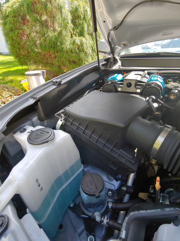

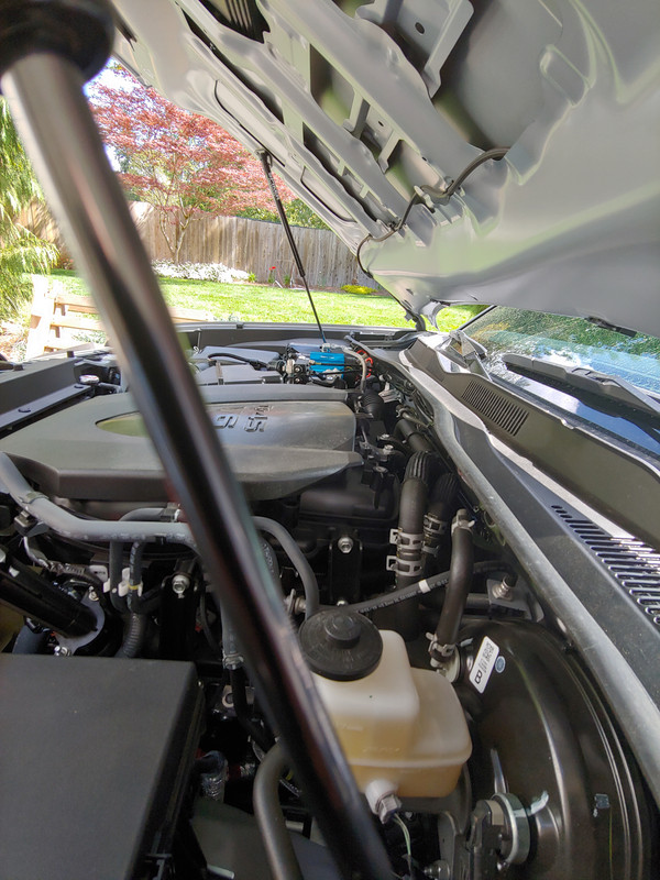

    They are rock solid.
    Observations: It really doesn't take much force to close the hood and the strut pressure up is controlled, even and not forceful in any way. It takes a little pull (or push) to begin the down travel, but again no movement or flex at all in the upper mounts. I mean I guess what am saying this is a complement to Spiker that one can install the brackets bass ackwards and the product works fine. Something like worst case may be to pull the hood up faster than the struts or manually force it down the whole travel - MIGHT be extra stress at the rivet interface, but again no movement and who would actually do that? I can see the brackets lasting tens of thousands actuation cycles - certainly more than a couple set of struts :D:p
    Yes the angle of compression and actuation is slightly altered.
    I have no concern about the location being tougher on the hood itself. I'm not seeing it.
    SO the only real problem I caused is less clearance. If somehow I get a taller battery or air box - then oops I will have to redo the upper mounts. So be it.
    I will watch it and check to see if anything goes askew with age!

    Sounds like everything is just fine Paul, good to hear! As long as the brackets are rigidly attached, you're good to go. I think you actually have MORE clearance with this setup, because the struts sit higher on the hood than they normally would. Probably is not a big difference, maybe 0.5-1", but it certainly won't reduce the clearance to other components :).
