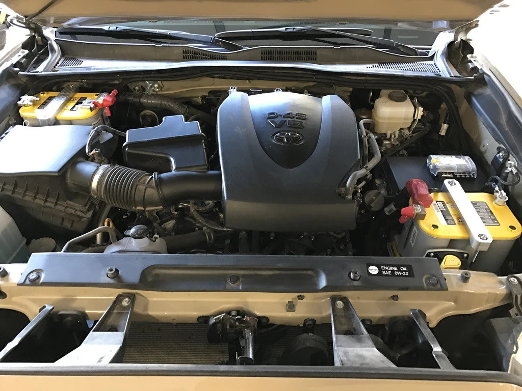

    Does this still mount the same with the Off-grid dual battery split system?

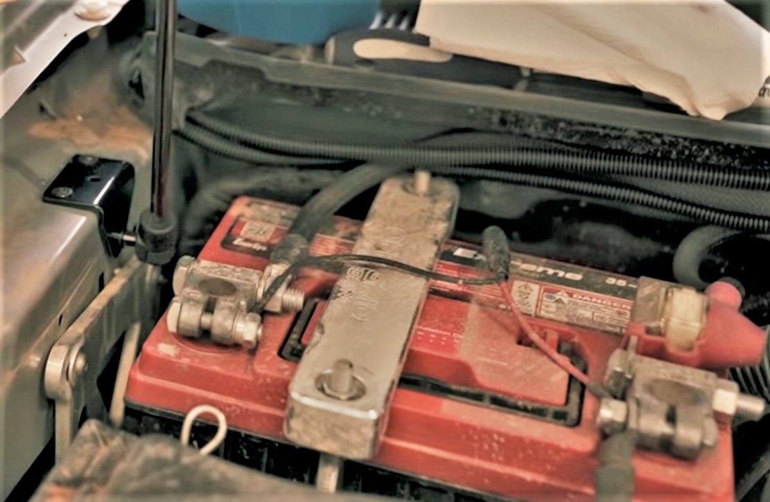

    Is this (picture below) the one?
    If so, it should work, you may just have to bias the passenger side battery inward a little, and maybe rotate or change the battery terminal. Here's a photo of the installation:

    YES!!!! Thank you. going to order it up

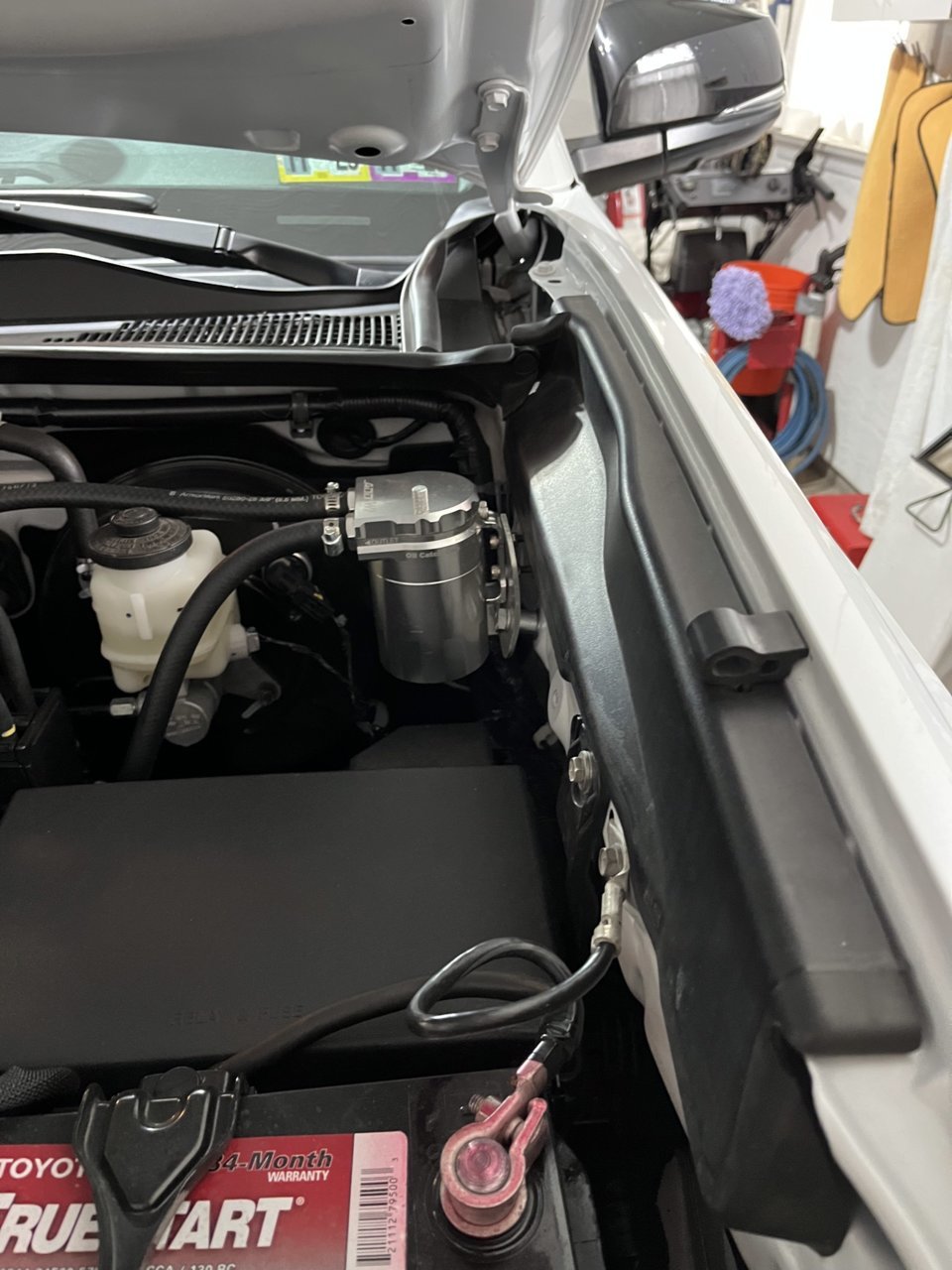

    Will I have the clearance for the strut when the hood is closed with my catch can installed?

    You need about 1" of clearance, I can't tell from the photo if you have that much. Given that the catch can is mounted on standoffs, you can get longer standoffs (or add some washers) and use a longer bolt to attach the catch can.

    My thoughts exactly. Looks like there's plenty of room for it to move toward the passenger side.
