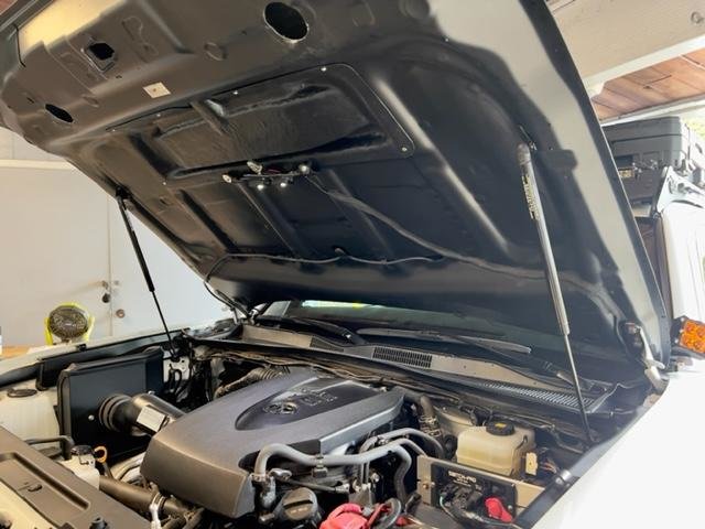

    Hello, curious and not sure if this has been asked before but is this compatible with the carbon fiber hood from Seibon?

    We've done carbon fiber hood strut kits, we use struts with less force output.
