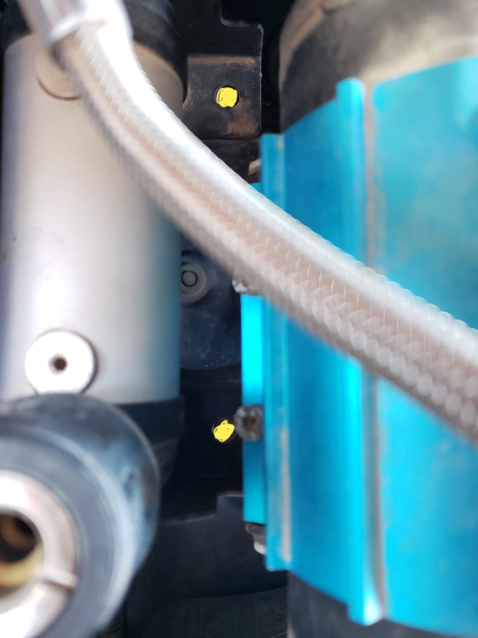

    Ok so I've been under the hood and here is what I've come up with.20200105_142154.jpg

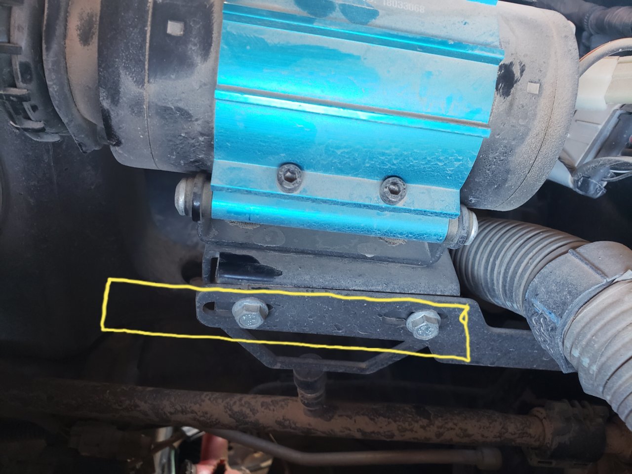

    This bracket with the manifold is 5⅝" overall with the mounting holes 4¼"center to center. 20200105_142251.jpg
    The 2 bolts in the picture are only 2¾" center to center. So, what will need to be done is to fab a bracket to mount the manifold in this location.
    The bracket will need 3 holes. The first two will need to be the same as the existing bolts and the last hole will need to center at 4¼" to mount the manifold with an additional bolt.
    I'm in luck because with this bracket I can reach the manifold bolts under the compressor bracket.
    So the next step is to fab the bracket and then order my high lift struts for my rig and momma's lil Pro.
    Be in touch soon.
    When I get the bracket built I'll write up the move and install.
