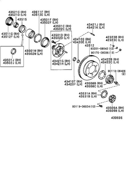

    I have 2wd spindles from an 03 prerunner. I also have abs. When I convert to 4wd, what parts am I going to need to source? Can I literally just press manual hubs into my 2wd Abs spindles and keep the abs?

    You’ll need manual hubs, hub locks, new bearings, seals, and cv’s also a manual front diff tube or lock the add fork in place
