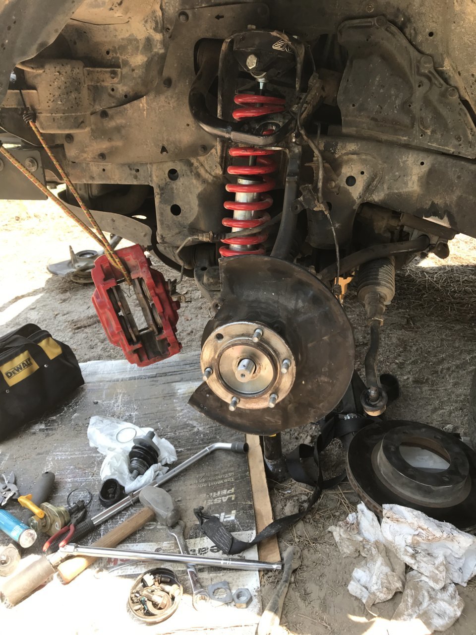

    Update: went back down the the runner started removing A couple things and turns out we don’t have a few things:
    Axle nut looks to be a 35mm
    Dust shield can be cut with metal snips (runner has the tundra brake upgrade)
  10. Jul 21, 2018 at 10:35 AM

    You can cut the backing plate if you want, but I'm pretty sure I just bent it back I a few spots.
    Yes, axle nut is a 35mm

    You're gonna want a 250lb torque wrench for getting that axle nut back on, too. Assuming you needed to disassemble the LBJ bolts I'd make sure you have a torque wrench for those (60ft lbs) and blue locktite.

    Update: spindle was swapped has an issue seating the lower part of the ball joint in the spindle as seen below used some parts from @Pickeledpigsfeet to get this bad boy to limp to the gas station for a tow

    Had SPC UCAs and we couldn’t get the bottom part of the ball joint fully fitted in the spindle, also lost the c clip. Came up with a bandaid, to get it driveable.
