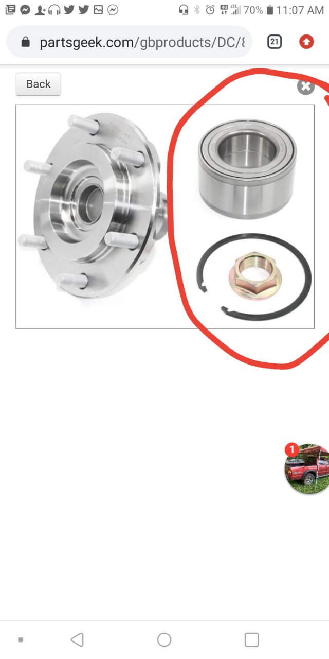

    The part I have circled in pic rightzz
  12. Apr 27, 2021 at 8:19 AM
    Kwikvette
    Feb 27, 2019
    #284735
    80,773
    Fresno County
    4 run, 2 don't
    The parts on the right are a wheel bearing, retaining ring, and nut.
    The part on the left is an axle hub/wheel assembly.
    I don't have part numbers but partsouq can easily answer you.
    Wheel bearing is the same part number though regardless of cv axle type.
