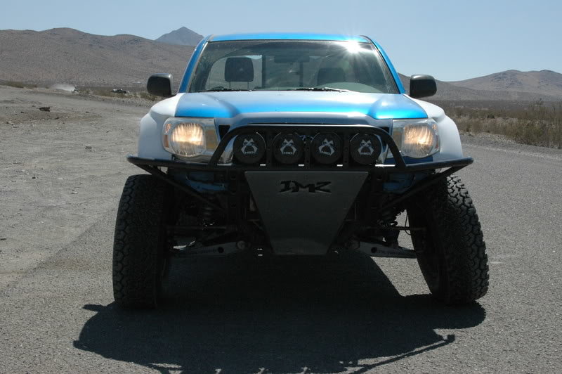

    Probably closer to $1000. They're expensive for several reasons:
    1. Development time
    2. Cost of manufacturing & materials
    3. They're a critical component so a lot of the above goes into them
    Look at the prices of upper control arms and you'll wonder the same thing about the price, but all you have to do is break once and you'll find the expense is worth it.
    But even after upgrading it's important to remember that nothing is unbreakable. :eek:
    (not my truck, but he mangled his Allied spindles on the same trip I broke my UCA)
