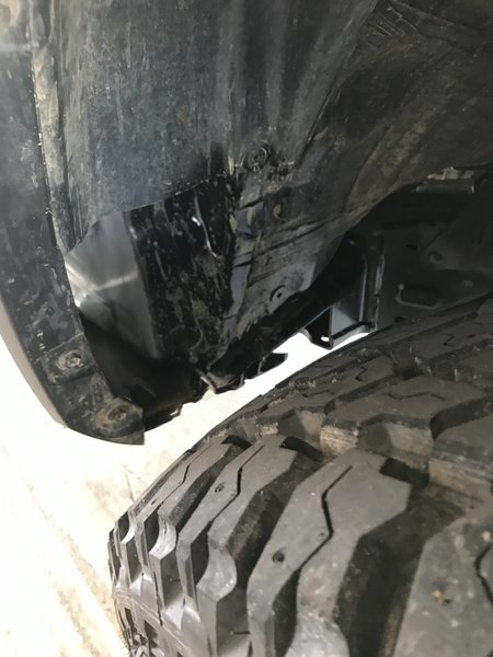

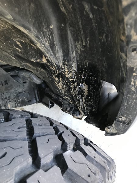

    I'm running an icon stage 2 lift at its stock setting with total Chaos uca's .5camber 2.5 caster and my wheels are 16x8 with 4.5" backspacing on 285/75/16 tires which is basically the same size as 285/70/17 (.1" difference"). I had to cut out the bottom of my fender well, hammer my pinch welds, and do a cmc.
