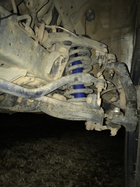

spindles on today more to come

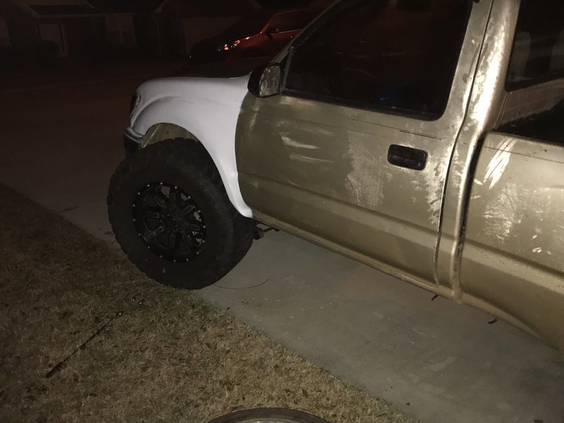

    I have a 04 single cab toyota tacoma with balljoint relocation and a 3 inch fabtech spindle and went and test fitted 275/70r18 and manage to fit them and not rub at full lock or rub on my bumper will be picking me up a set of delta chaparral m/t within the next week if yall could give me alittle bit more information on lifting it up just alittle more besides a body lift let me know
    Also my rim specs are ar908 18x8 with +40 offset with 6.07 inches backspacing

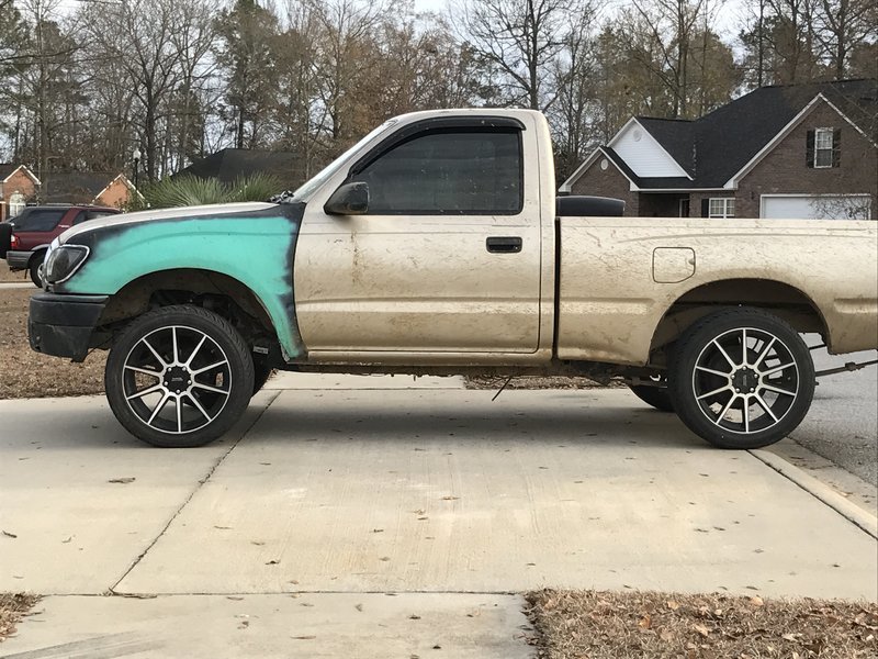

    Nice, what setup are you running in the back to level it out?

    Nothing as of right now
