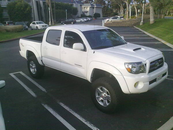

    Hello - Does anyone know if stock 2010 TRD sports rims with 285/70/17 BFG All Terrains will fit with Camburg Spindles? [​IMG]

    You will need wheel spacers.

    What rubs? I also have the 1.25 Camburg UCA's. Does that make a difference?

    It will rub without spacers

    Installed the BFG AT KO's 285/70/17 on stock TRD Sports rims yesterday. No rubbing, cutting or spacers. Clears everything!!! I was totally stoked!

    I am glad you didn't rub, because mine rubbed like a mofo, my offset was too high, I had the 16" steel prerunner wheels on my reg cab
