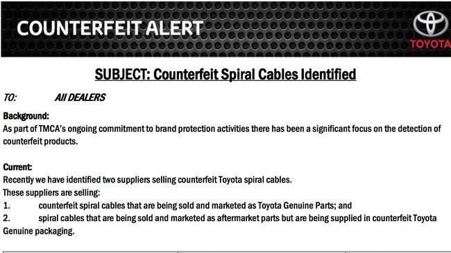

    According to an urgent dealer bulletin obtained by News Corp Australia, Toyota has “serious concerns about the safety of these parts” after internal testing in Japan found there were four ways they could fail to deploy an airbag in a crash.
    Toyota Australia has declined to comment on the matter.
    But the dealer bulletin issued over the weekend says there is a “high likelihood of insufficient conductivity to support airbag deployment electrical current” and “significant risk of airbag non deployment in an accident”.
    The technical bulletin says the counterfeit part does not have gold plated connectors, the crimping of the cable is not strong enough and it does not use copper wire as per the genuine article. The plastic locking tabs are also “poorly formed” or misaligned.
    As is the case with most new cars, the airbag connector — the link between the car’s power source and the airbag in the steering wheel — must be replaced every time an airbag is deployed in a crash.
    The genuine part costs about $300 wholesale, while the fake part is estimated to cost as little as $50.
