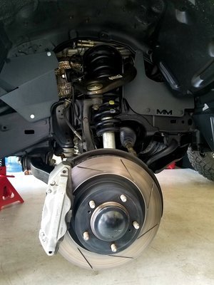

    Neat idea. Unfortunately for me, I live in the Northeast so unless its made of aluminum, it wont last a winter.

    Yes, just a list of people who would be interested in buying these once they launch. They will look exactly like the Tundra models yet they'll fit a 2nd Gen Tacoma. No one is asking for your money yet just some people who'd like to receive an email saying they'll be bunched in with the group discount and will be one of the first to receive shipment. And the plates are 16gauge steel, no aluminum.

    How do they attach?

    They attach with bolts in place of the factory plastic inserts.

    Lets put a hard metal piece between a frame and a rubber mounted body. There is a reason why everything that goes from the body to frame has flex (look at all the brake lines and their spirals before they reach the frame) and is the reason why stock and aftermarket larger splash guards are rubber.
    These will inevitably rip sheet the metal apart.

    The flex issue is not articulation. It is the fact that the body is mounted to the frame on rubber blocks. That means the body can flex on the frame. It also serves to isolate vibration. Having a solid connection with these shields will result in the shields cracking, and could increase transmitted noise. The simple fix is to mount these through large grommets. Nothing against the product, especially if bling is the thing, but rubber is hard to beat for this job.

    Toyota does fit them from the factory but they are rubber to allow for movement between body and frame.
    Yeah cool, the truck can be slowly flexed on a fork lift and not have issues, now put the truck through thousands of miles of roads with pot holes and off road vibrations i guarantee you will start ripping the original sheet metal that these are bolted to on the body side. Like stated there is a reason that the stock ones are rubber, there is a reason that EVERY SINGLE THING that goes from the body to the frame has the ability to extend / collapse / flex.
    But hey you wanna rip apart the already rather fragile front clip of the tacoma to look cool, by all means go for it.
