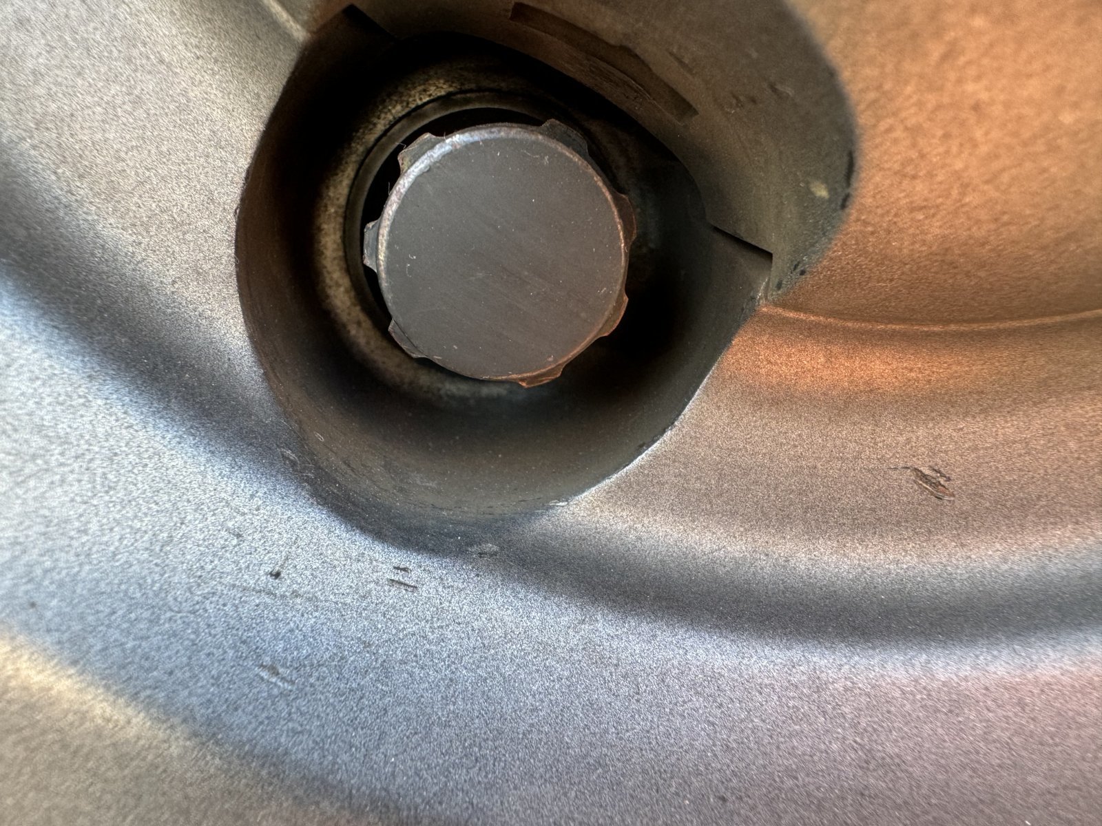

    Hey taco bros. I purchased a 2016 Tacoma a year ago but I didn’t notice the wheel lock key is missing. Can anyone help identify this lock? I need the key to it. It’s got 7 spline but are not spaced evenly.

    Splines on that lug nut look asymetrical. Not sure if there is a "generic" key that fits it, possibly a custom key to fit the asymmetry.
    If you are cool with destroying the nuts, you can try a few things. Most tire shops that need them removed I think just hammer on an impact socket of close sizing and zip it off. Or even go to a local tire shop and have them remove the nuts, they will know the tricks and probably won't cost you much at all. Nut extractor kit could work. Other methods that are more destructive might also damage your wheels so take caution as you dive down this rabbit hole.
    If you are trying not to destroy the nuts, Gator Grip has a special socket with pins inside to fit irregular objects like this and could work. Or you could try contacting a company like McGuard who makes those special locking nuts and see what they can do.
