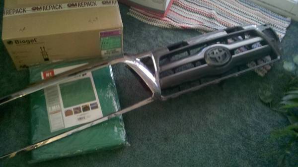

    well i decided to just go for it cus if i mess it up im only out $30 bucks to get a new one so here we go.
    Heres where there is no turning back
    Heres the end result
    well tell me what you all think

    i did it with my stock 08 grill, just melted or ground the tabs down and she pulled apart. check out the "jamoshi grill" page, its what i used
