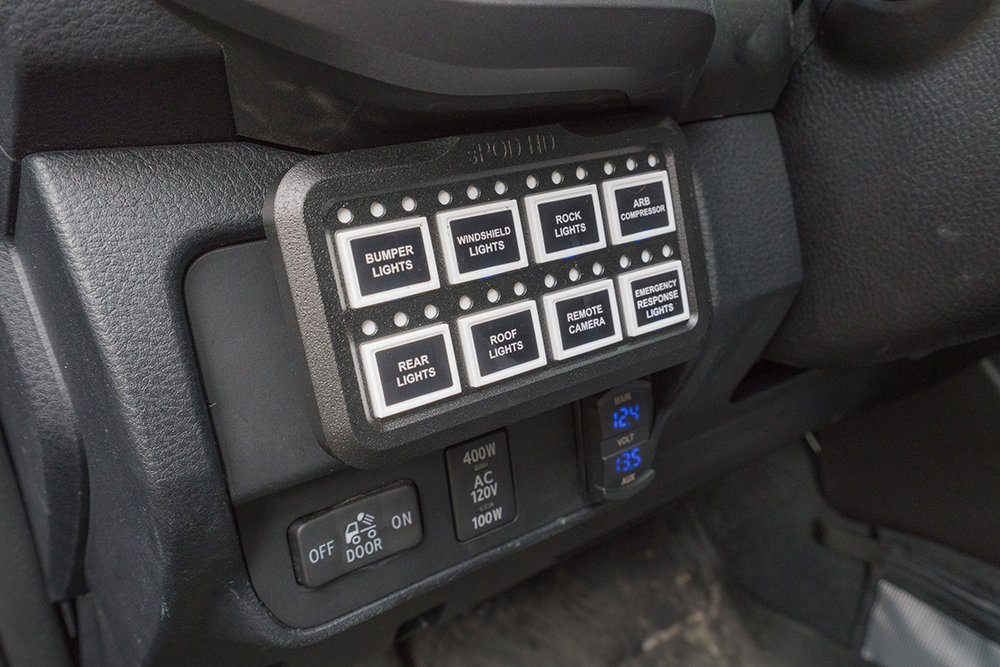

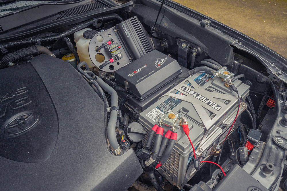

    It doesn't get any cleaner than sPOD. No extra fuse block or wiring needed.

    Does that thing behind your sPod have something to do with your dual batteries?

    Yes. It's a multi stage battery charger/isolator for the aux battery.

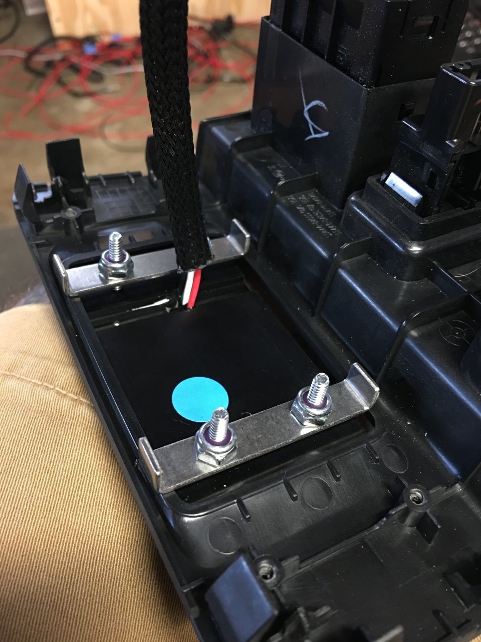

    Also, how did you mount that thing in the cubby?

    With the included bracket and hardware. Mounts right inside the cubby. Had to drill a hole in the back of the cubby for the Cat 5 cable that connects the HD panel to the sPOD SE unit.

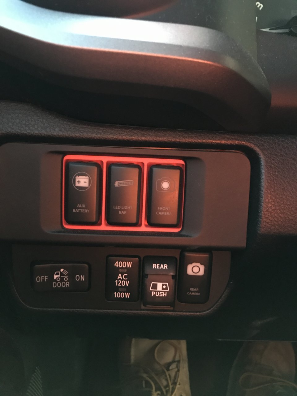

    Where'd you find a 4 switch replacement for that cubby? I purchased the shapeways item a forum member made, but it's only 3 additional spaces. TIA!!!

    Shit, maybe I'm misremembering but I thought it was three up top then I had a blank one that was stock. Something for the manual trans.

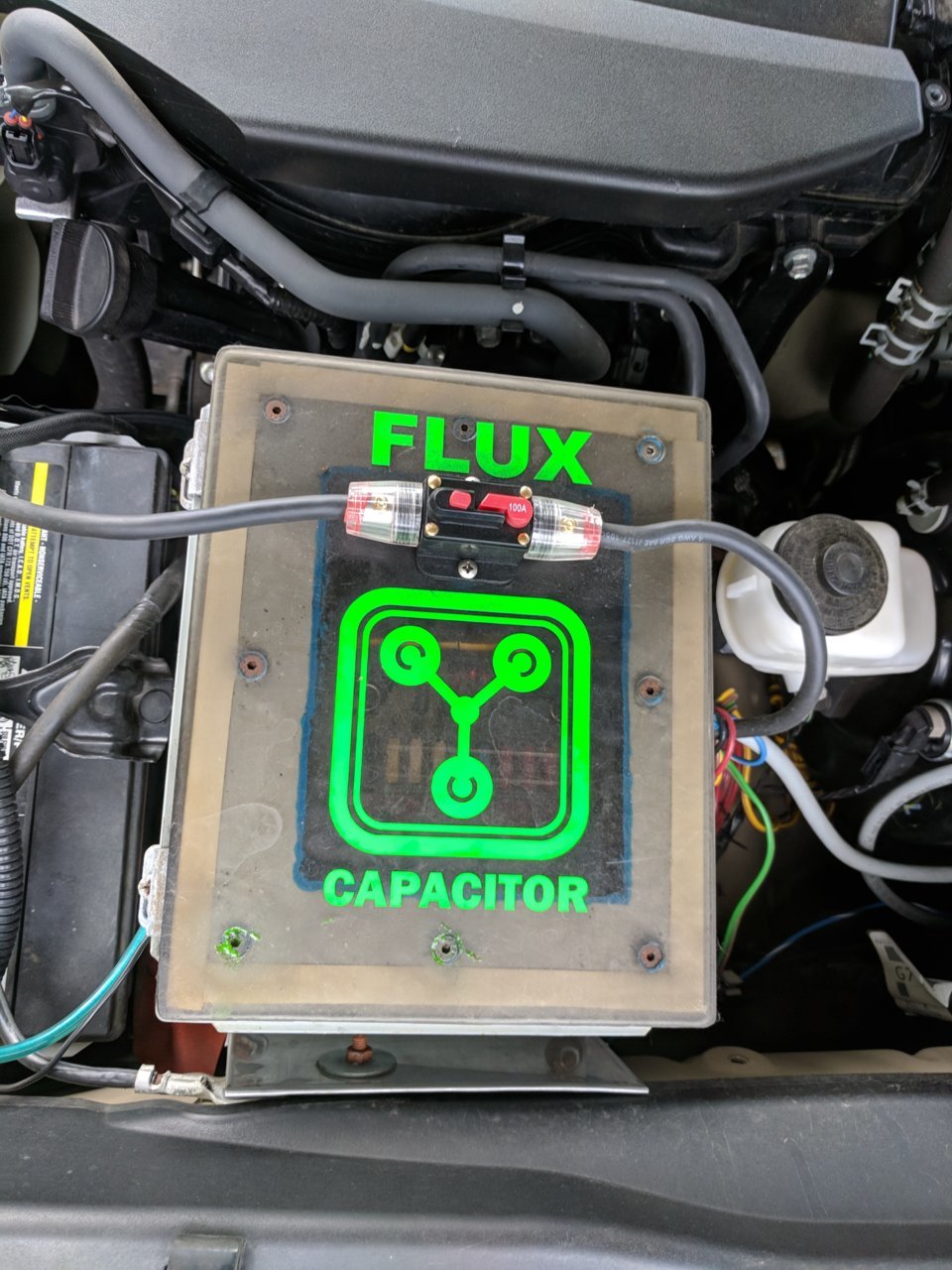

    I built my own to. It was a cool learning experience, 6 relays ranging from 15-30 amps with a low voltage cutt-off switch i found on Amazon https://www.amazon.com/dp/B019F3BEIO?psc=1. I found the box were I work. wire and all in in $200 [​IMG] Now I get to say I have a Flux Capacitor.

    Gotcha! I've already used that space where you have the rear camera. I thought maybe you had a 4 button cubby up top.
