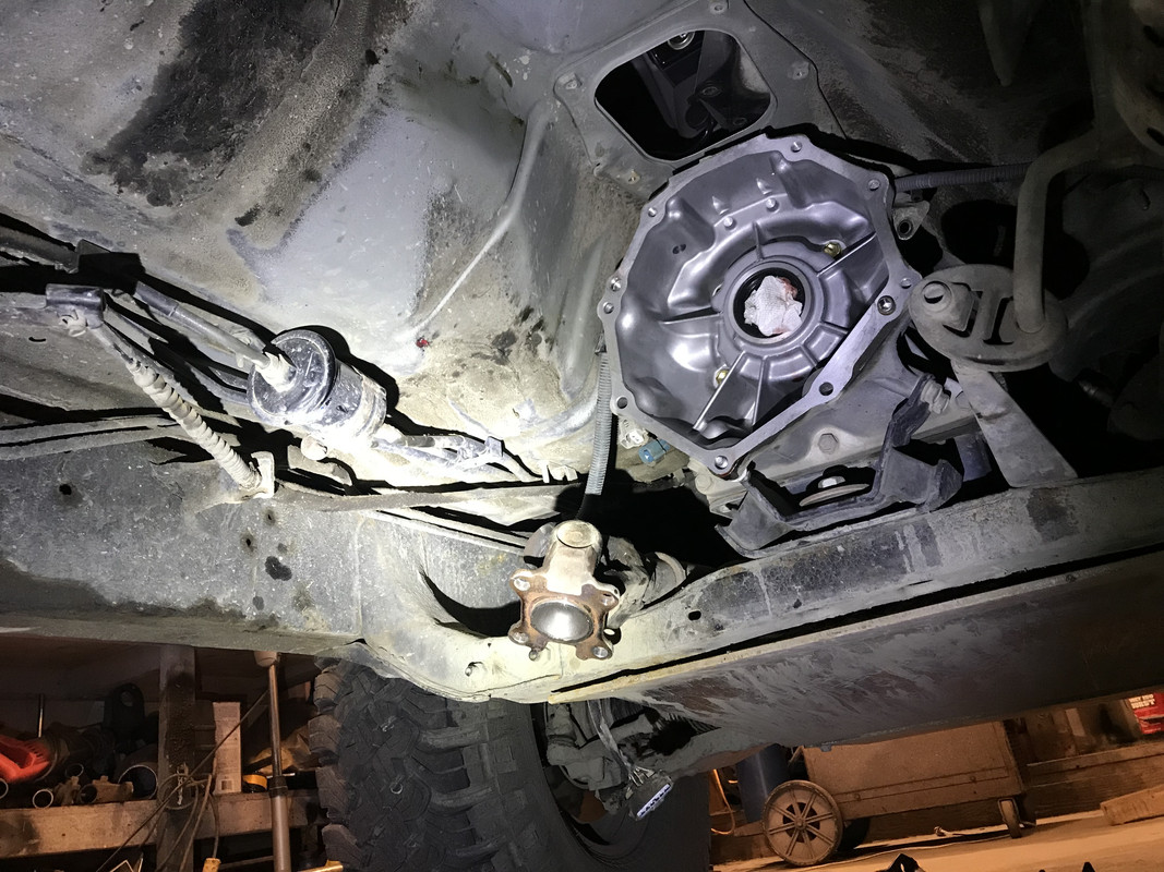

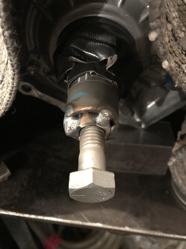

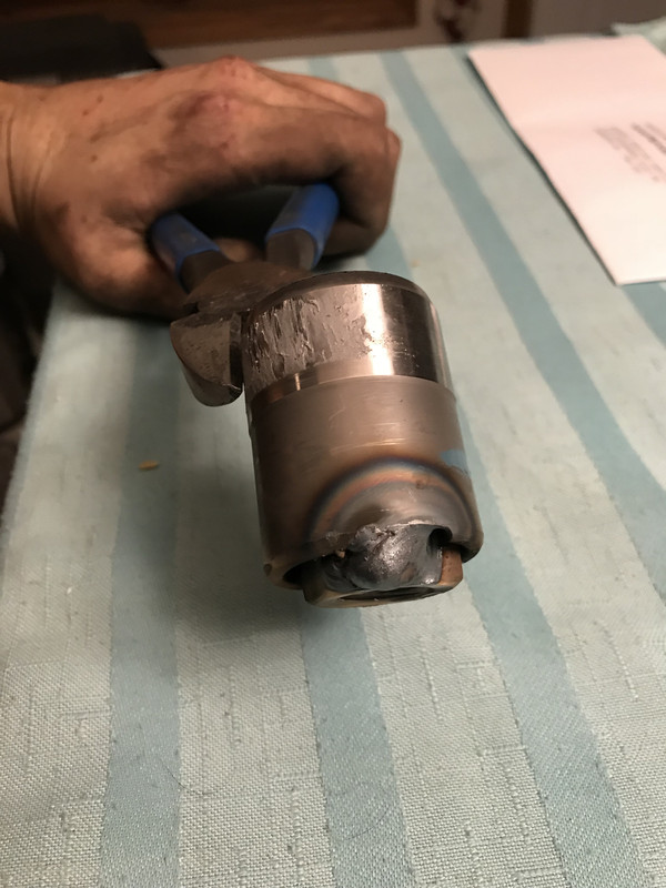

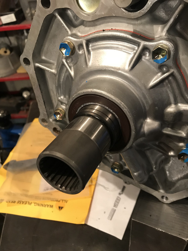

    Well I got my low range trail gear order and I’m terribly disappointed.
    Here’s a few photos of the damage. Shipping box appears intact and it was well packaged.
    This seal is fucked.
    Mounting surfaced marred and needs to be smoothed.
    Entire unit had been dropped and adapter is damaged. And a chunk is missing.
    Also found a loose bolt on the assembly. Which robs me of any confidence I had in this product.
    Called marlin crawler to place an order for one of their assemblies, but they’ve been waiting months already, and with new trump tarriffs causing steel availability to be greatly reduced, they are months out too.

    Thats a used case, I dont case what anyone says. My buddy ordered marlin crawl box in May and he said possibly by the end of the year he will get it. Inchworm had some issues with so.e units so id lean away from them personally. Sucks, sorry to hear that jaime, hope they at least refund shipping and all
