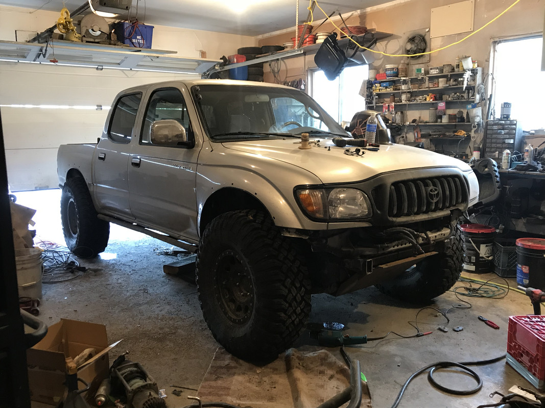

    Prepping the truck further for snow wheeling :D

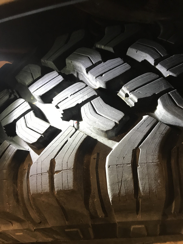

    So far yes they’ve been good. I’ve now siped and grooved them to help with snow snd icetraction.

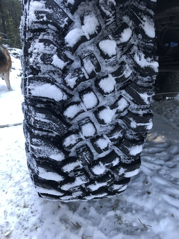

    Grooved the big outer lugs and center lugs in half. Siped everything.
    Snow is packing in the grooves and getting into the sipes which is what you want. If it contributes to work wel I might groove more.

    I may end up getting a set of just summer tires so I can prevent ruining these if i get a lot of chunking. Because i have a couple idea on grooving them more. Even with smaller grooves so it’s just heavy siping.

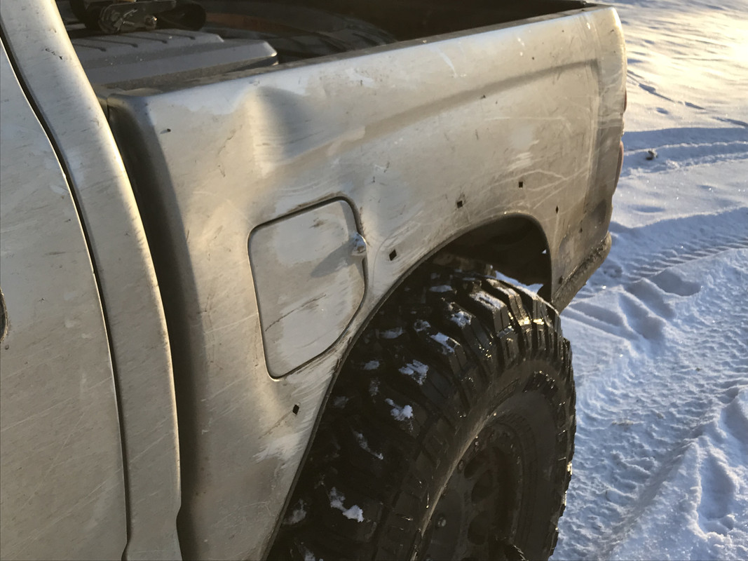

    Alberta
    Today’s work
    Tree hit me but I popped most of it out
