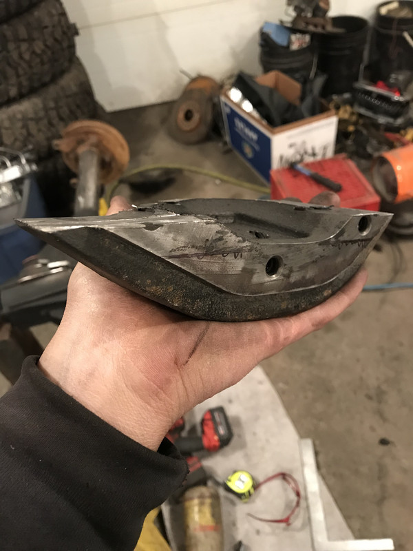

    Oh man some of those huge brackets on the front axle sucked to remove. The rear was pretty easy. Just torch them off and grind the rest.

    Yeah the d60 mounts suck to cut off on the 05+ axles haha. Can’t wait to see the carnage begin.

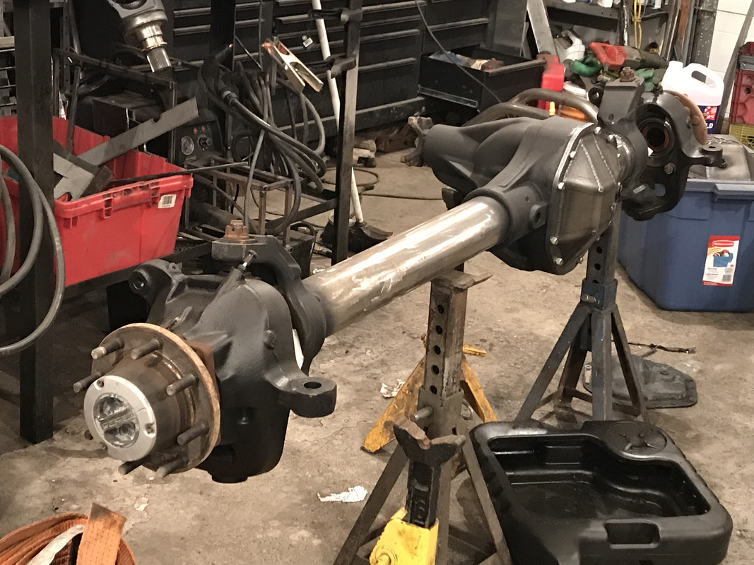

    When can I start cutting my truck up??
    And some leaf spring setup stuff for the back

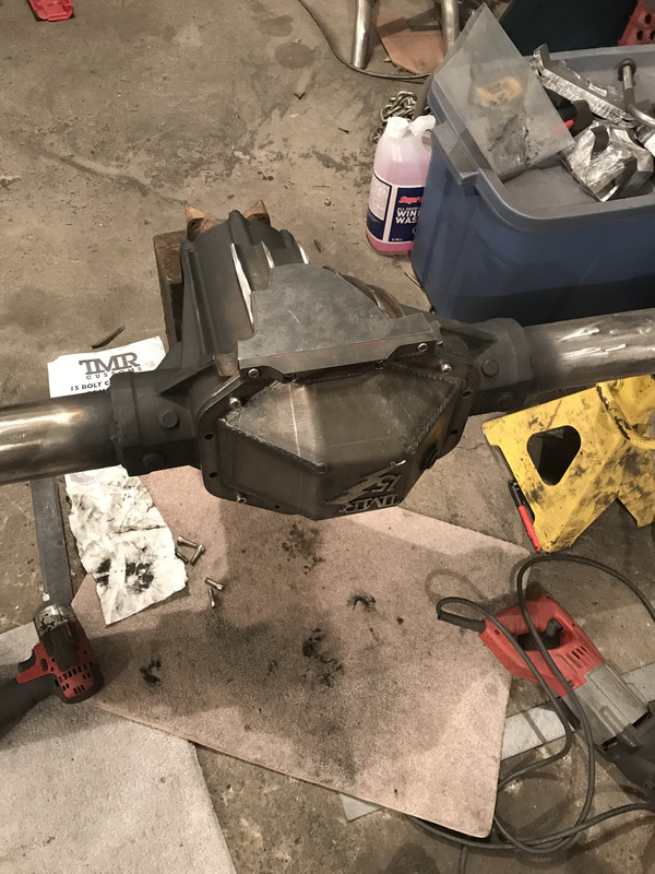

    Very nice! Why didn't you shave the front too?

    It’s not necessary. Dana 60s don’t have a super low hanging carrier like the 14 bolts do. I don’t even know of anyone that makes a shave kit for the A’s 60 don’t anyway. It’s got pretty good clearance as far as I can see

    Oh ok, I know they make kits for them just wasn't sure. I was contemplating shaving mine but I fear the loss of oil volume and being still driven on the street would lead to problems.
