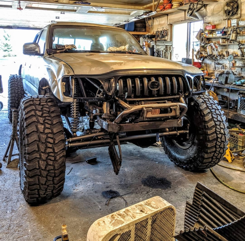

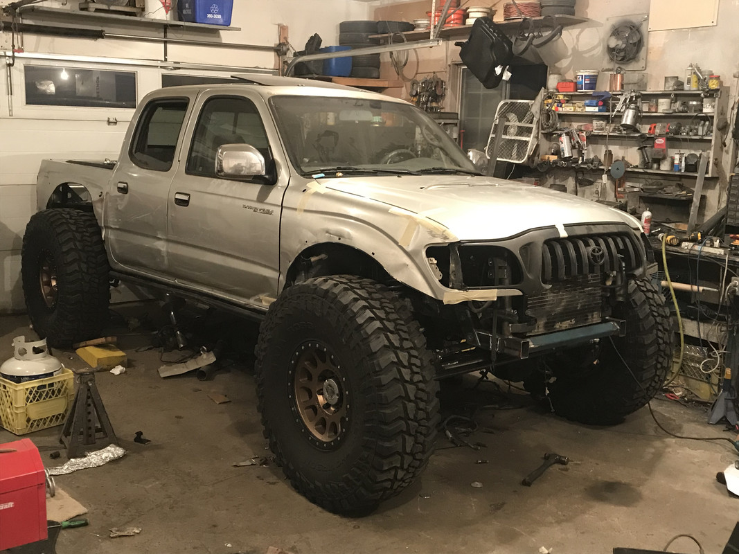

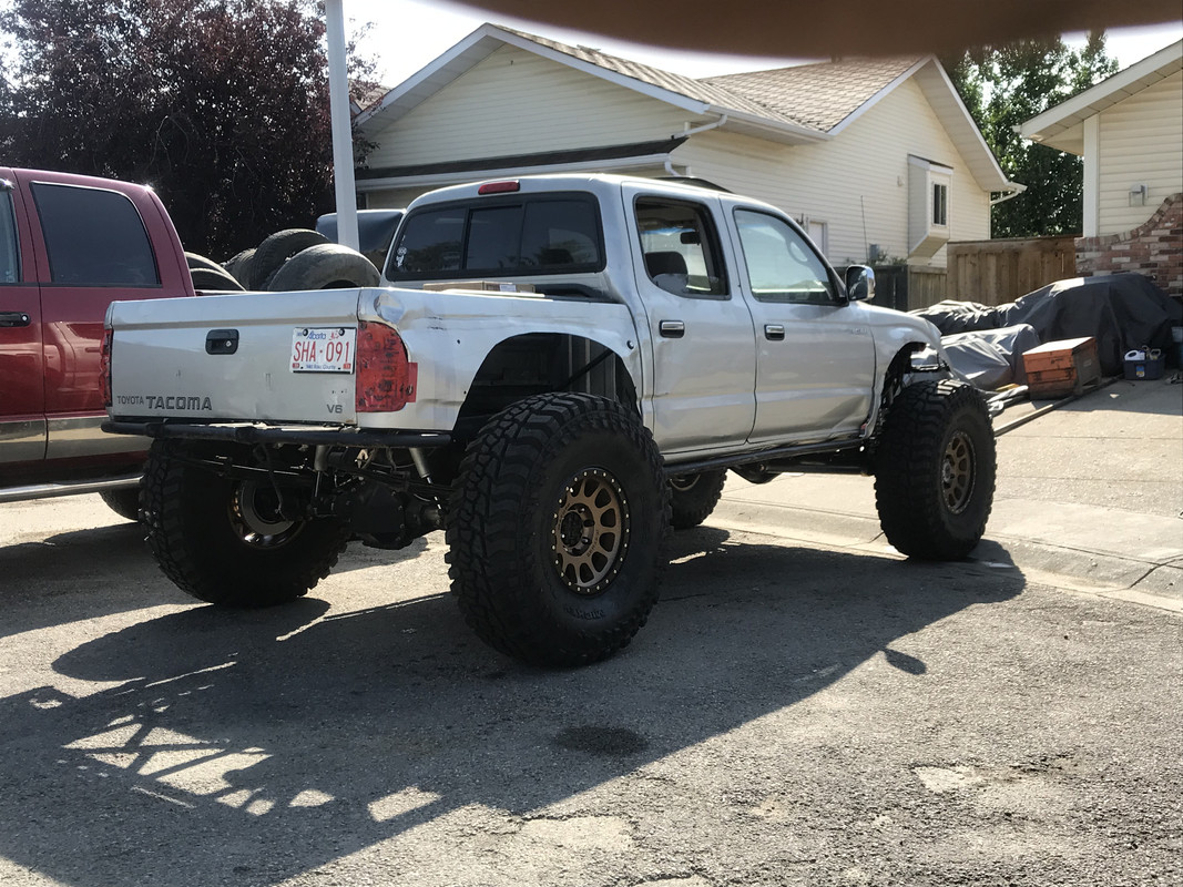

    Rolled out for a sweep. Not sure why to do on it today.

    2000 ext cab, 2.7L, auto, 4x4
    Lmao I love your build hombre

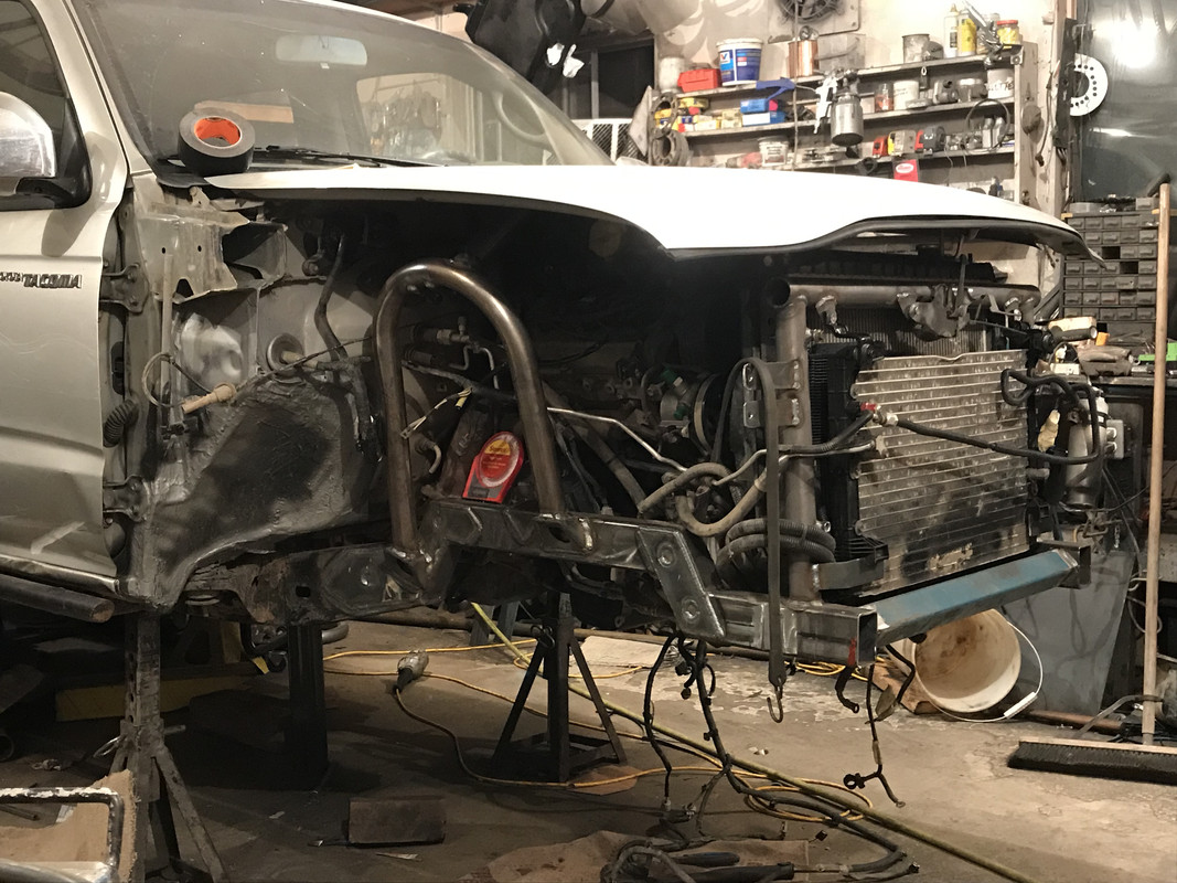

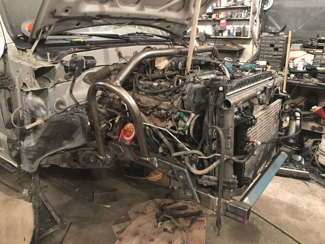

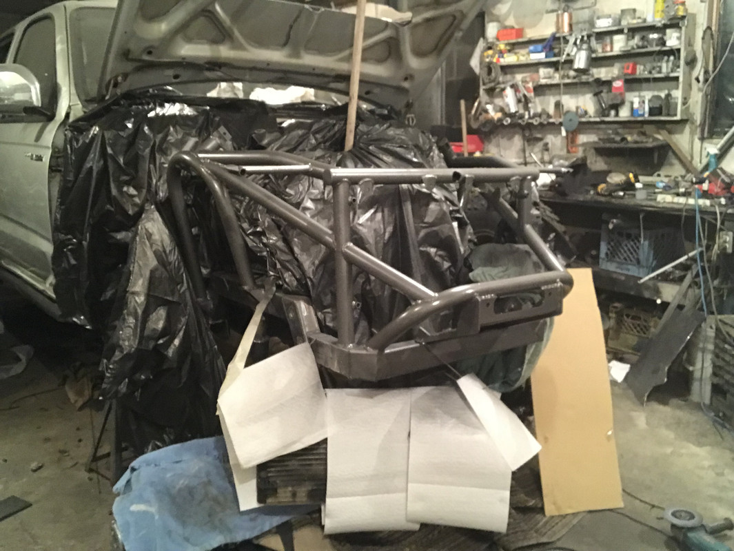

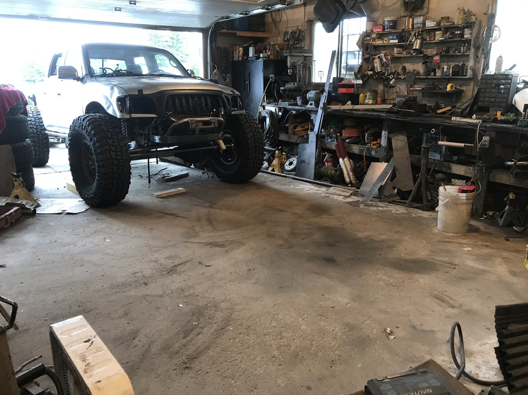

    Workin on the crossmember and skid stuff this weekend

    @Spoonman
    What's you're F/R axle wms and BS of those wheel? Look like 3/4 of the tire are sticking out of fender? Maybe angle of picture?
  8. Jul 21, 2019 at 4:20 PM
    #768
    Spoonman
    Spoonman [OP] Granite Guru
    Sep 11, 2011
    #63328
    9,810
    Jamie
    Alberta
    Nope. It’s probably 3/4 tire sticking out. 71” wide axles. And method 8.5 0 offset wheels.

    You probably post it here but are those 40s?

    What are you using to cut the plate? Looks clean AF!
    I can’t tell from the pics on my phone but are you going d60 and 14b?
  11. Jul 21, 2019 at 7:35 PM
    #771
    Spoonman
    Sep 11, 2011
    #63328
    9,810
    Jamie
    Alberta
    Yes
    Plasma or cut off discs. Yep.

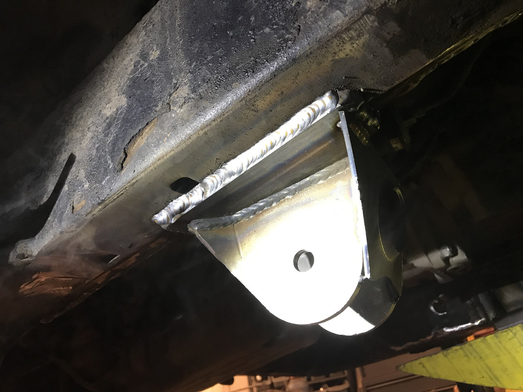

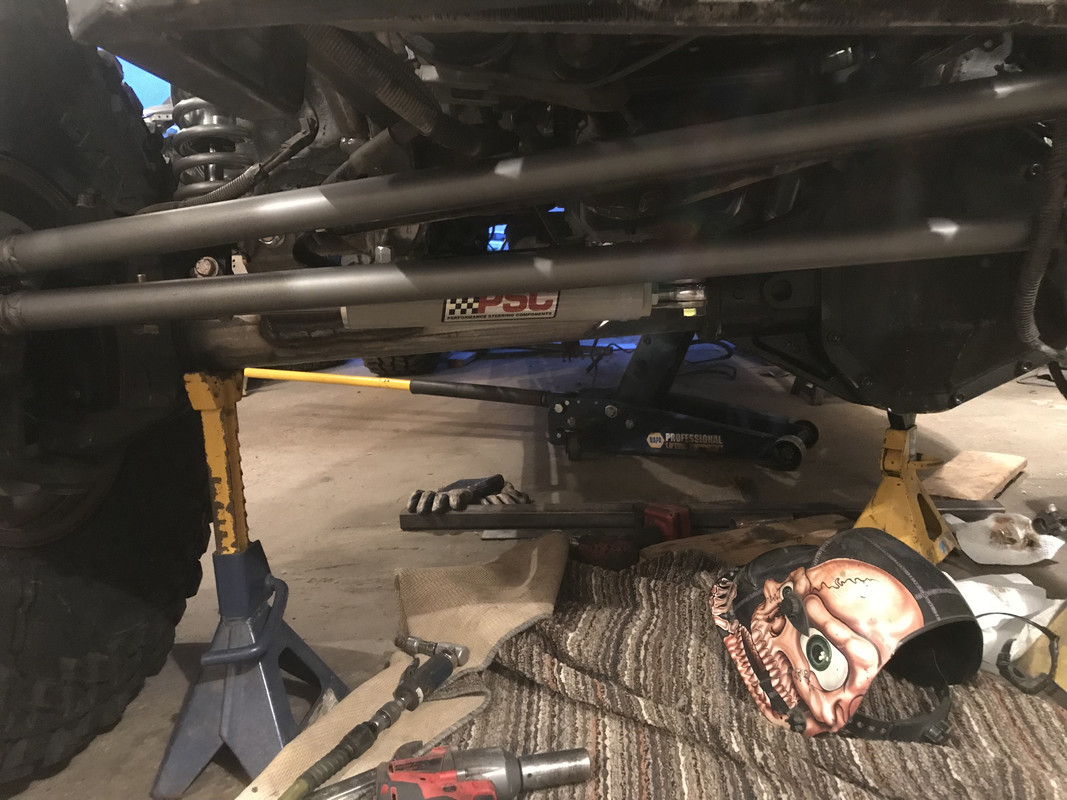

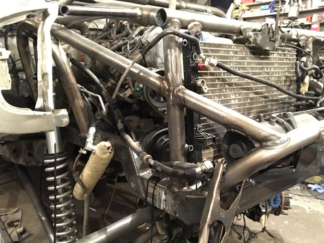

    New master should arrive tomorrow. We’ll see if it will work.

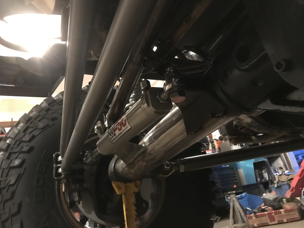

    Tonight I pulled out the rear axle and welded on the shock mounts. Then Got it up on the bench to setup the gears. Added a leaf to my packs. And added a tube to the engine cage to help strengthen the front end.
    Should be able to bump into shit now.

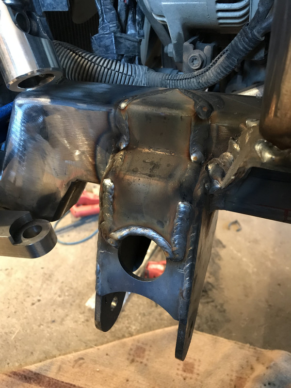

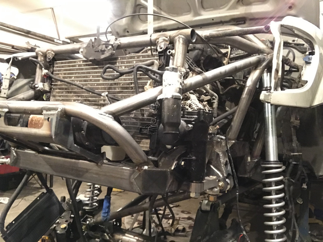

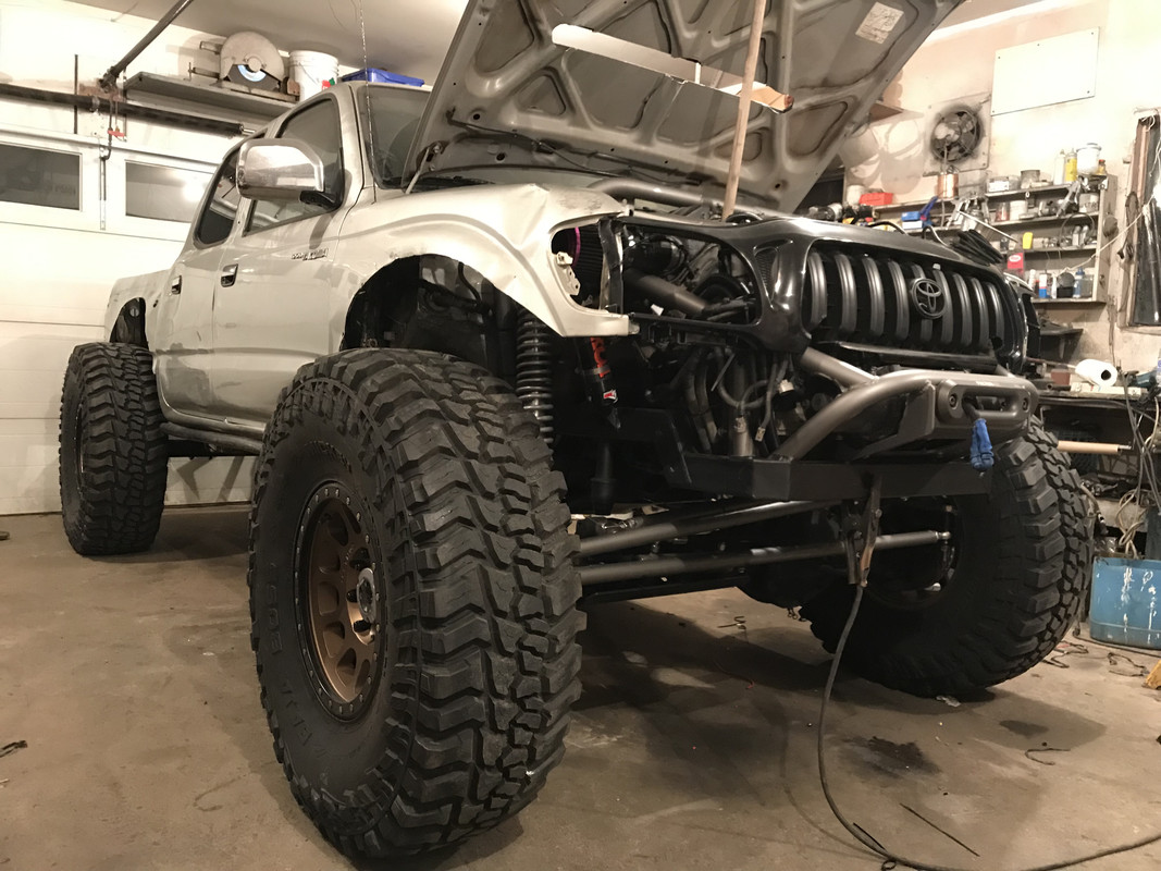

    Got more done. Gears and lockers are in. Got the new springs on, both axles are under again. Then tore some stuff off for paint

    Just quit for the night. Winch is wired, rear light wired, other wiring bs done, did a bunch of little things. Also trimmed the front fenders a little.

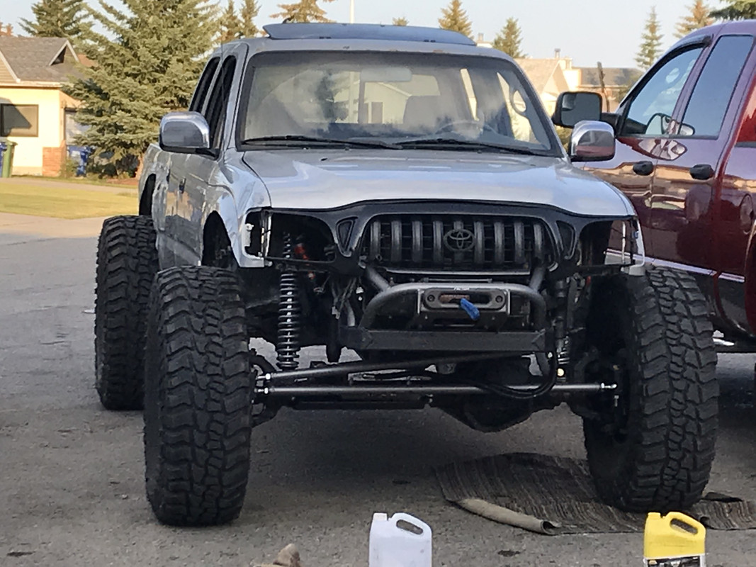

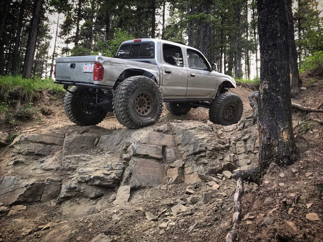

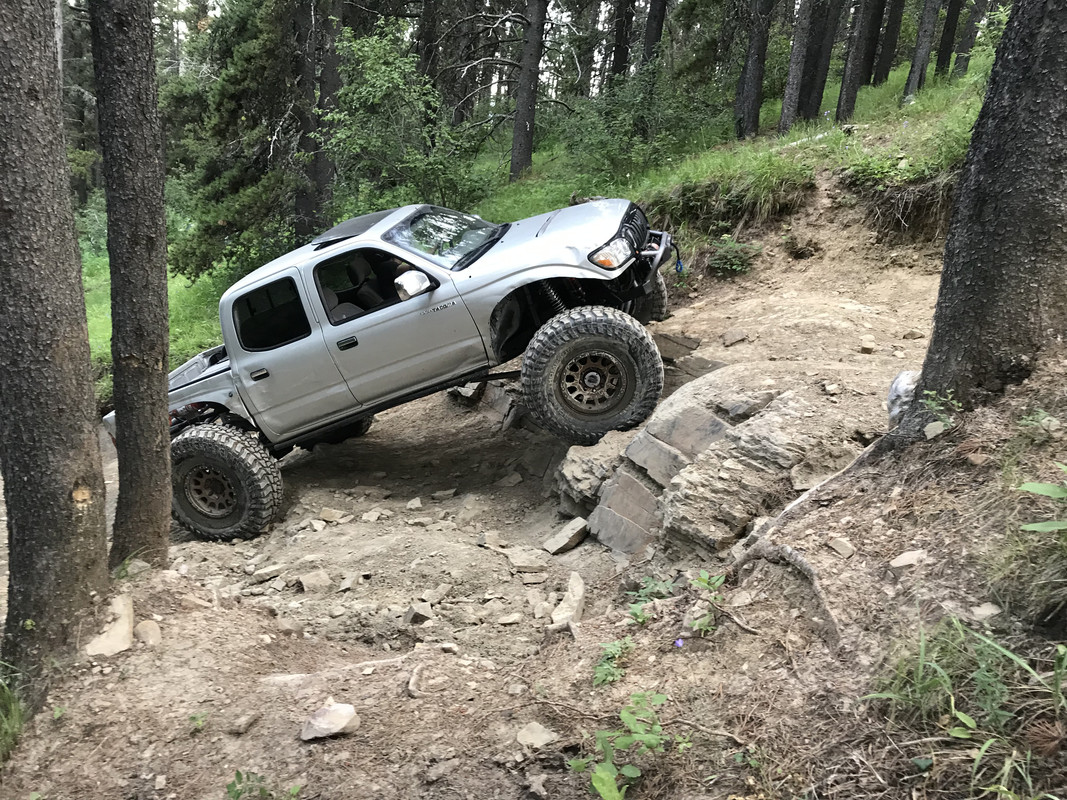

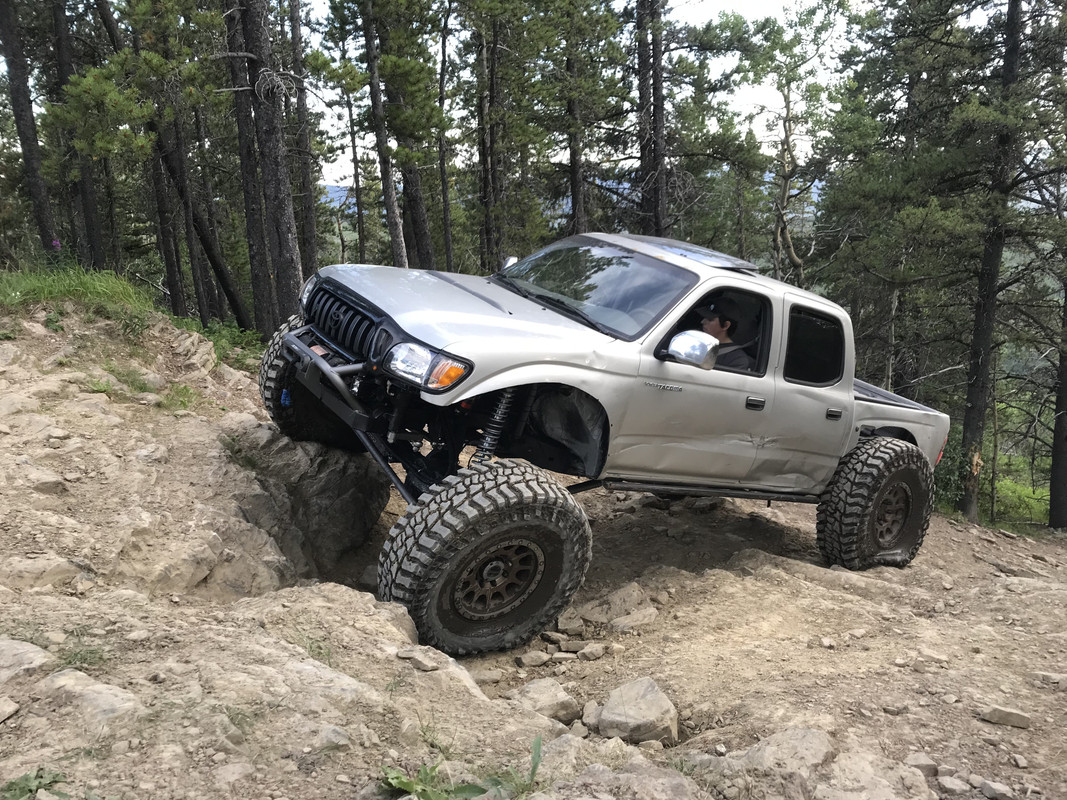

    Drove it around town today and couldn’t wipe the smile of my face.
    Ordered a new rad, mine got a smal pinhole yesterday. New tails, new front markers,
    Little flex test

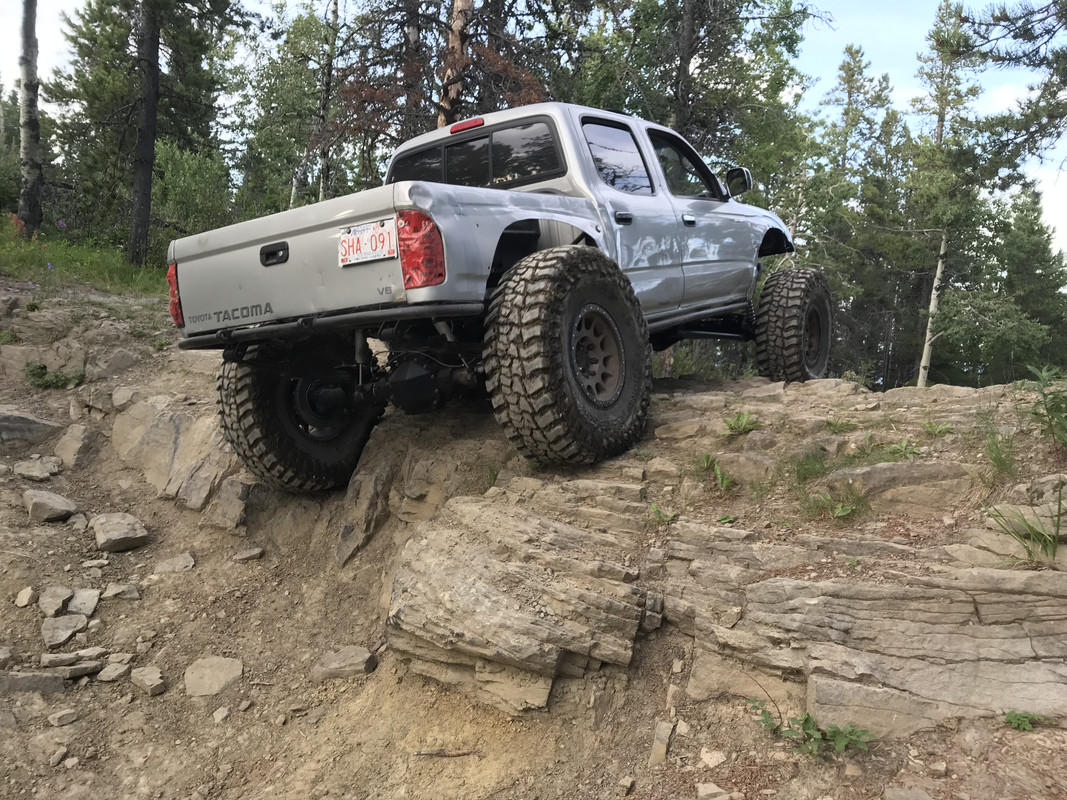

    Little shakedown this evening
    And it did great. Drove it 60 miles on the highway to and from the trail
