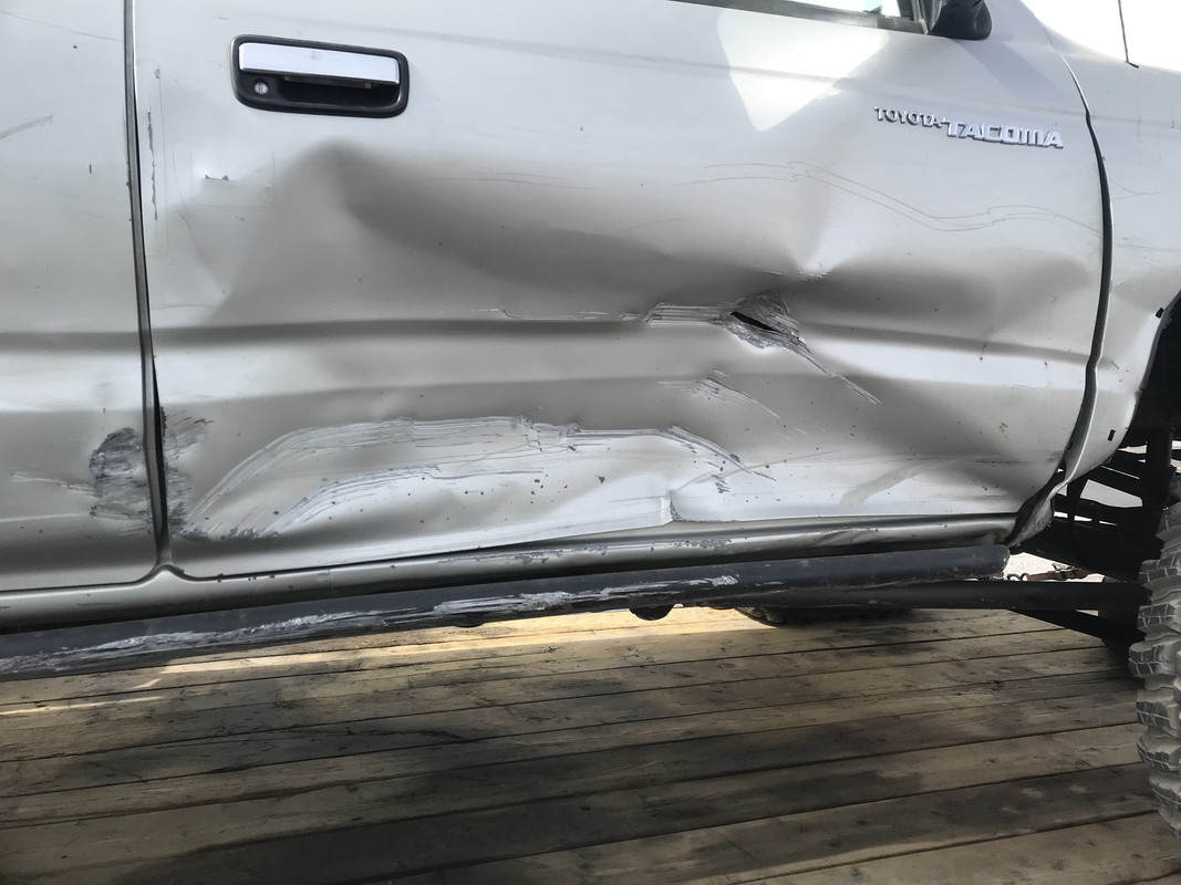

    where did the door damage come from?

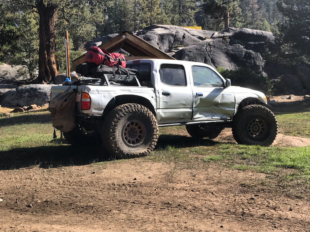

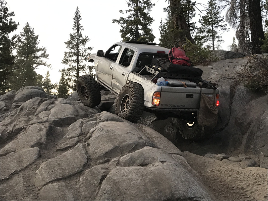

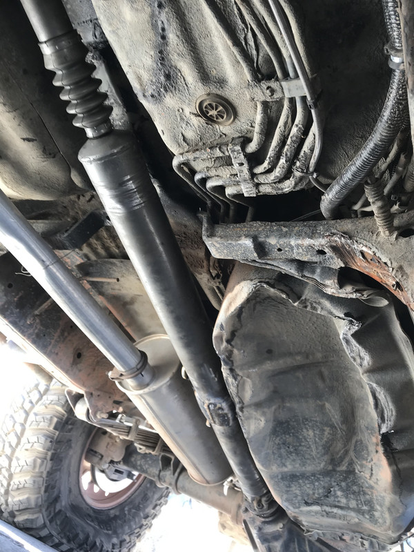

    Here’s a few mcr18 pics. I tried doing the hardest(and dumbest) lines I could find and paid for it a little.
    There was some carnage.

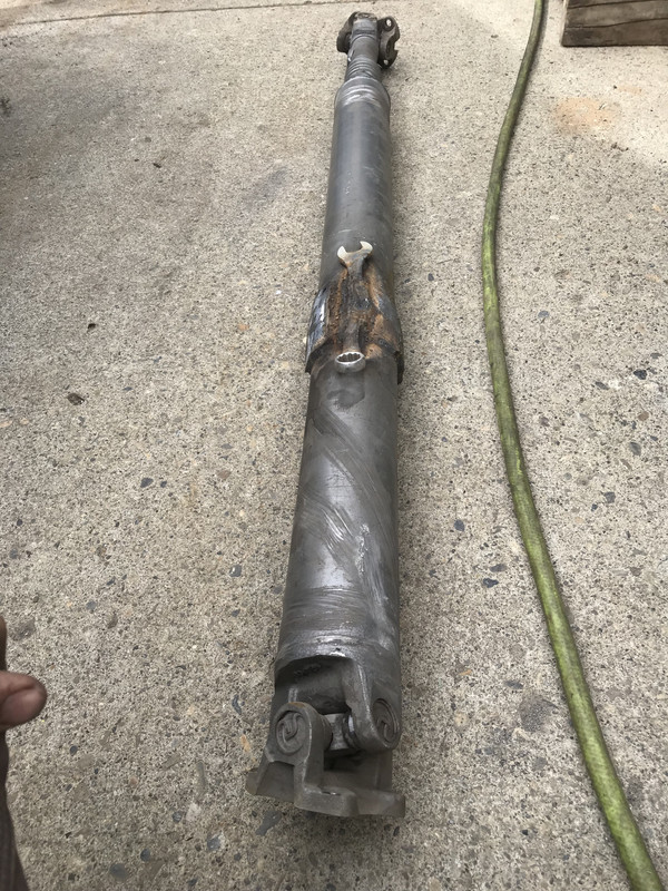

    Leaf spring bent to hell(replaced that today), broke my 24 hour old driveshaft in half, punctured my tank in a few places, tail light(that hurts the most), and lots of body damage. Fixed the shaft and tank on the trail and kept wheeling. Louie was near so with lots of help we had my shaft back together in short time. 5 minute epoxy worked great on the tank.

    More details on shaft repair please. Did you weld a collar and a wrench on it?

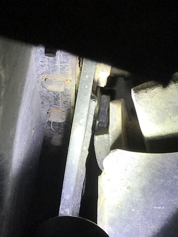

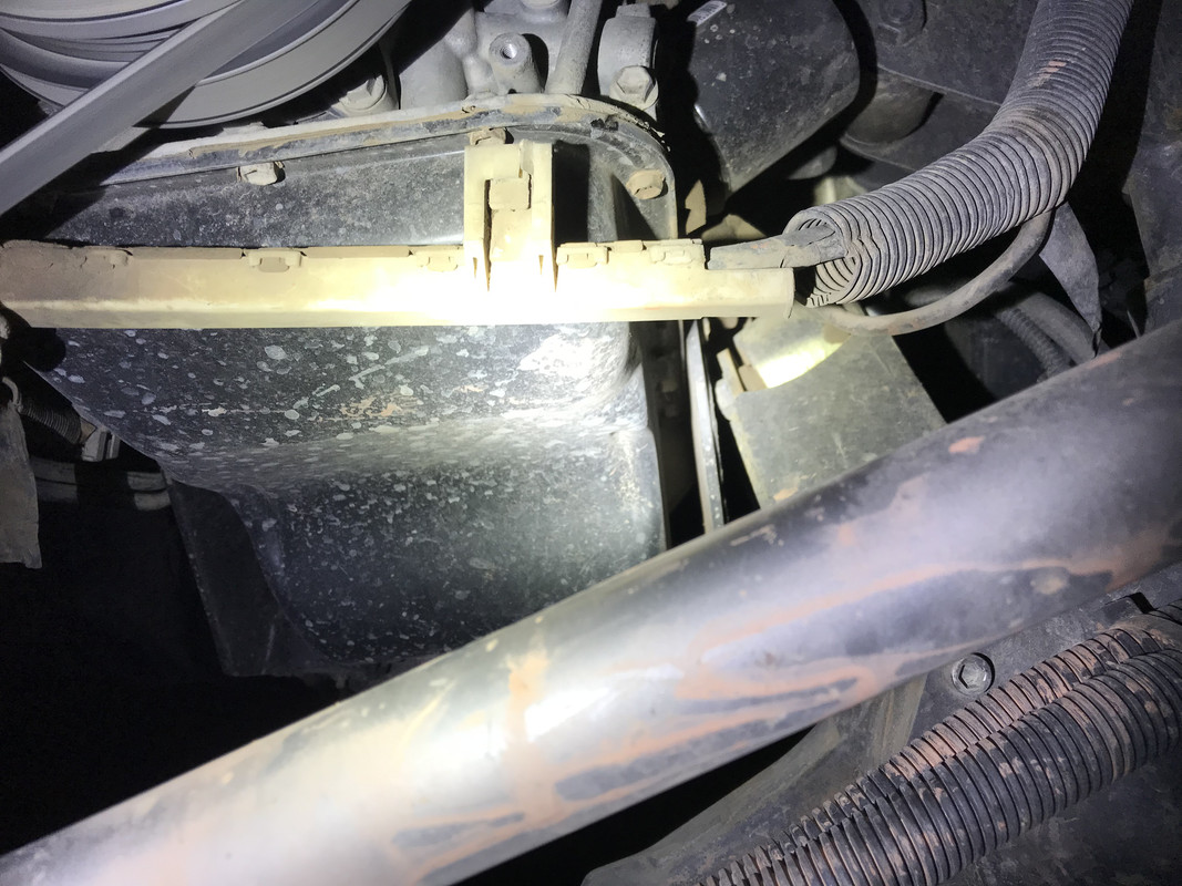

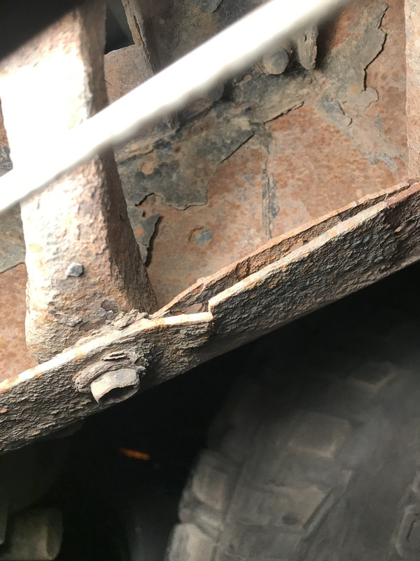

    My upper link is actually contacting the side of the block when the passenger side is fully drooped and the drivers side is stuffed. There’s a few marks in the plate and one mounting bolt my transmission skid mount. I just che led it out and it’s very close when stuffed and obviously moves enough to touch. So i need to move my upper link mount over about an inch toward the frame.
    Here’s a pic-
    Anyone have any idea on how to fix this upper link? All I can think of to do it cut of off and angle it over to get more clearance.
    If I move the link mount over, bend the upper link a little and bend my panhard, I can get 3-4” more uptravel at this ride height. Which would be awesome and I think worth the work. I was having a helluva time keeping up with the buggies.

    Slow down lol. It’s not a buggy :p
    As for the upper link, looks like it’s self clearanced on the transmission pan. Maybe see how much it contacts the block. If not a lot see if you can take some material off the block and upper link to account for it. I wouldn’t go crazy. Just a little with the grinder.
