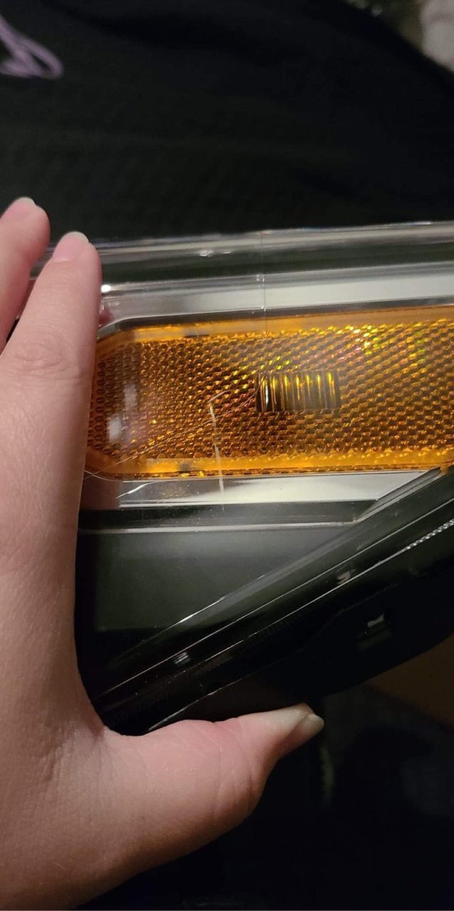

    would sport headlights work on an sr?
    found a really decent priced (at least I think... $150) and it’s off of a 20 sport.
    do these come with led drl’s?

    do y’all think $150 is worth it?
    has small scratch on one of them

    Yes, that’s a very good price for a pair, even with the scratch
