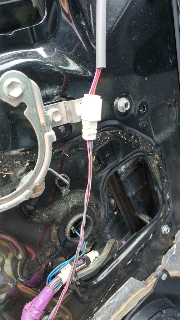

    Ok so I popped the door panel off and here is what I'm looking at. The blacktape cluster is what's running from my side mirror. Looks like 3 wires (red, white, light brown) are running into the white connection which has 5 wires running down from it. So should I be able to plug one of the 5-wire turn signal mirrors into this and have it work properly?? Thanks for any help. @TaterHarry

    Yep - you're good to go :thumbsup:

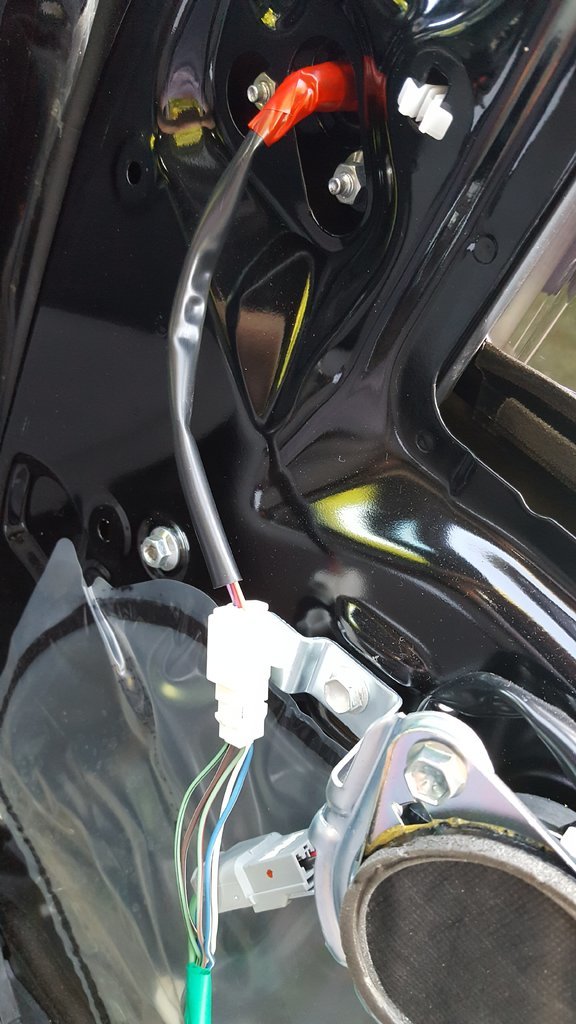

    I just installed Sport mirrors in my 2014. It has 5 wires running up to the harness. The power mirrors work, but the turn signals are a no go.
    Any idea why these aren't working?
    I put a voltmeter on the pins at the harness and there seems to be no juice at the harness despite it being prewired for it. Been searching for a bit on TW but coming up blank...
