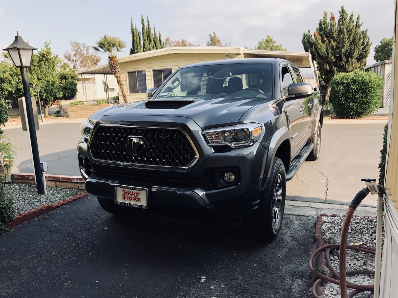

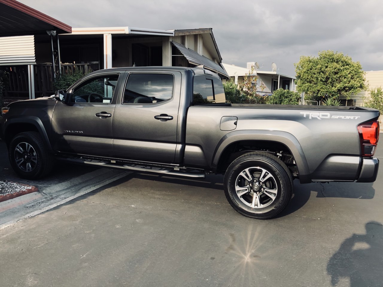

    Well I love mine. For stock it’s a beautiful truck169575A5-5BB5-4789-AC82-516DF4D0D250.jpgF02B24D2-9BF9-4F8A-8725-0144D5EE9760.jpg
