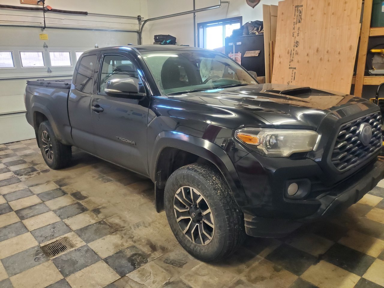

    Opinions please:
    I have a 2022 AC TRD Sport but I also have a set of TRD Off Road struts sitting in my garage. Just ordered some Bilstein 5100s for a 2" lift. Would you use the Sport springs or the Off Road springs on the 5100s? Is there even a difference in the springs? Or should I just order some OME 888s?
    My truck is stock except for a diamondback cover.
    I drive about 50% highway and 50% dirt roads. I'm looking for more comfort and control on the rough roads. Thanks in advance!
