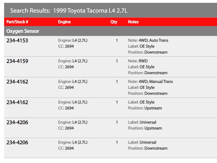

    Does anybody know WTF Denso fuel/air sensor is SUPPOSED to be for a 99 2.7? I believe I have been duped on EBay. I heard that 99 is tricky and two different sensors were used. I really would love to know what belongs in this friggen thing.

    1999 4wd 2.7L Sensor 1 upstream Denso OE #234-4162 OR Universal# 234-4206 Sensor 2 downstream-automatic transmission Denso OE#234-4153 Manual transmission Denso OE#234-4162 OR universal #234-4206

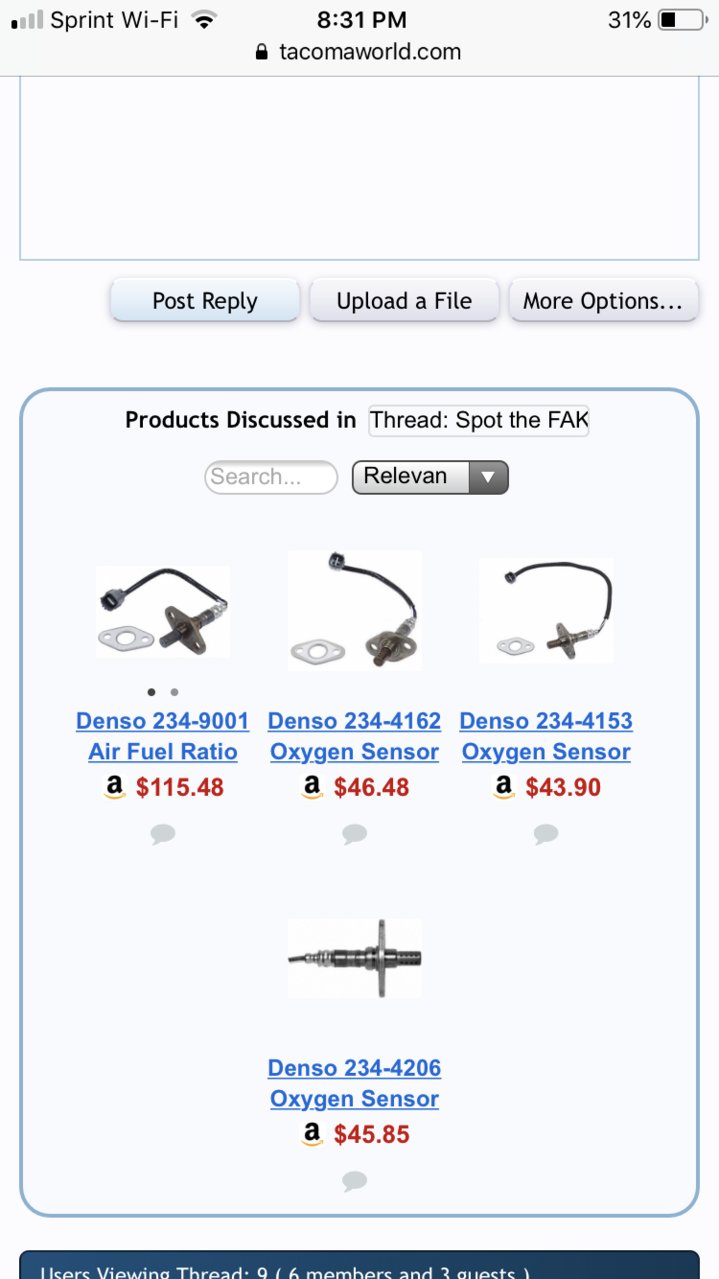

    Is it an a/f ratio sensor or is it an O2 sensor. I swear I got the wrong thing in there. Please oh please just tell me what is supposed to be in there. So confused 8F061008-F63E-4349-A98B-FE54447F3C08.jpg

    *Gasp! Wait. Is there a difference between 2 and 4 wheel drive? Cuz “technically” my PreRunner is 2 wheel drive. Has this been my problem? Certainly the ecm’s are different between the two.

    99 does not have an air/fuel ratio sensor - just O2 sensors.
    No difference for upstream (for the downstream sensor, YES there is a difference). See below. Upstream for the 2WD 2.7L is the same for either OE Style or their Universal. I would go with the OE style P/N. So, grab it from:
    https://smile.amazon.com/Denso-234-4162-Oxygen-Sensor/dp/B000C5UFK8/
    Prime item, can't go wrong.
    Part reference source: http://densoautoparts.com/find-my-part.aspx
