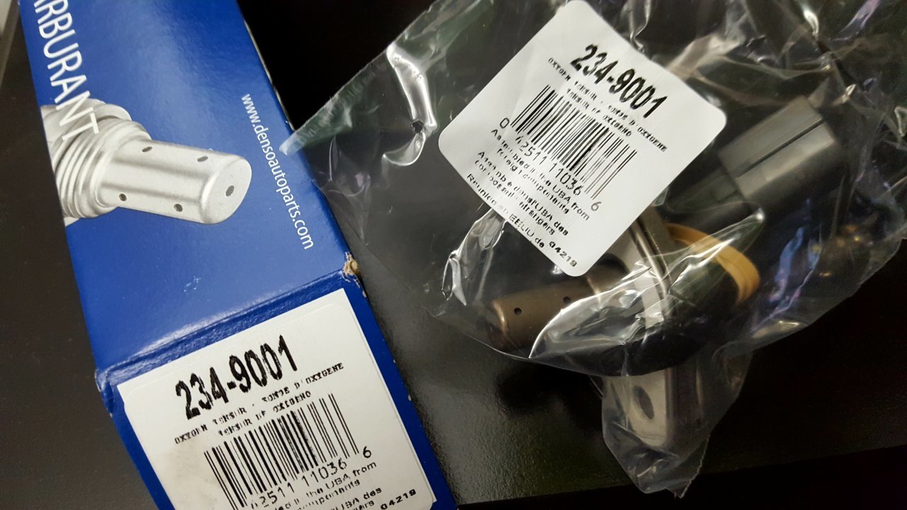

    Oh and I think the one on the right is a fake...IIRC the Denso sensors have the holes in a straight line like they do on the left. I could be wrong though, been awhile since I changed mine out.

    Upstream sensor is the same for 2 or 4 WD. Only makes a difference for downstream sensor.

    O2 and air/fuel sensors have different hole patterns unless it's a fake. Genuine air/fuel sensors have a hole in the bottom and 4 rows of 2 smaller holes on sides.

    I have an extra o2 sensor and refrained from posting until I took it out of my parts box -
    Purchased new from Rockauto months ago.

    I get your point but air/fuel sensors should always be called by what they do. Elimates confusion. As to the eBay fakes; Seller has been very good at sending more fakes every time I notify them of incorrect part in correctly numbered box. I now have 3 fakes and another one on the way. Their 5 star rating is also fake. HONG KONG co. shipping from Ontario, California.

    I ordered a pair set upstream air/fuel. downstream O2 on a lark. Their O2s are pretty fair and do funtion as per oe spec but putting a short wire and a/f connector on an O2 doesn't make it an air/fuel sensor.

    the right side looks fake to me, but they could both be fake. I went through several fake ones from Amazon. they are notorious for selling fake homemade O2 sensors under brand names. I got a downstream one once and it was listed as the brand name but in a ziplock bag when it arrived. it lasted about 6 months before failing.
