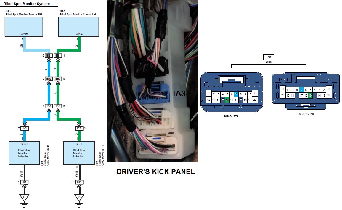

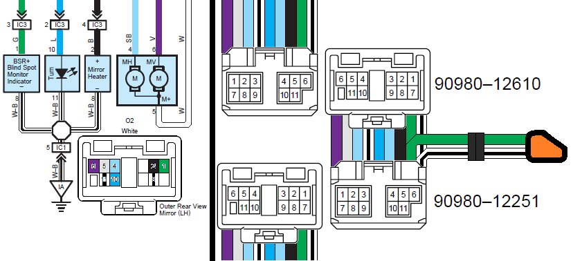

    I've read somewhere that the BSM indicator lights are at a lower voltage... So, a 12v relay might be in order? :notsure:

    Test for us with meter:burp:. EB3 is in engine bay fuse/relay box.

    For those wishing to confirm my measurements in post #20 of the stock BSM only putting out 9VDC to the BSM mirror indicators the best way to do this is when first turning on the ignition. It is then that the longest period of activation occurs while not driving. The EB3 in the engine compartment fuse box connector as caribe suggested seems like a convenient place to take the measurement. Oh shucks so convenient, I just confirmed my prior measurements, but this time only measuring 8VDC. Could be a meter thing.

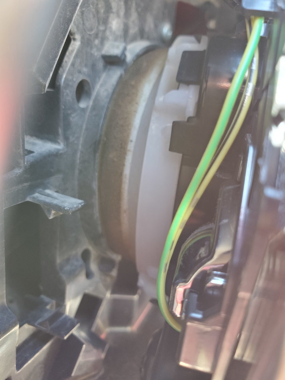

    Do these mirrors stick out further than the OEMs? I feel like I've got the driver side seated properly but it sticks further out and leaves pretty noticeable gaps on the perimeter.

    Shouldn't - I don't think you have it pushed into the clip on the upper left.

    Hm yours definitely looks more flush than mine, but I think all the clips are fully seated. I've given the mirror multiple solid pushes from the center to ensure all clips seated, and I heard 4 distinct sounds during the install.
    Below is the top left.

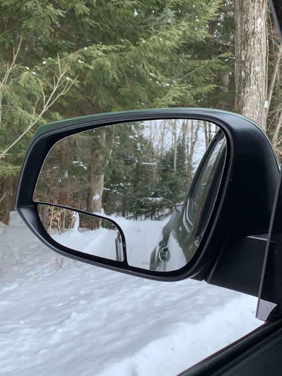

  17. Sep 9, 2022 at 5:21 AM
    #37
    Rock Lobster
    Rock Lobster Thread Derailer
    Dec 14, 2018
    #275833
    13,232
    Dee Eff Dub
    I drive a Miata.
    I wouldn't say they stick out further, but I did immediately notice the lack of a plastic bezel around the edge like the OEMs have. Same amount of glass in the same position, but that tiny little detail makes it appear "off" from certain angles. I can also see my turn signals bleeding around the edges of the mirror now. I'm trying to decide if it bothers me enough to fab up a gasket to mimic the missing bezel.
    Another thing I noticed... are these mirrors a hair more convex than the OEMs? I've noticed that the field of view is slightly wider even on the "non-spotter" section. :confused::confused:
