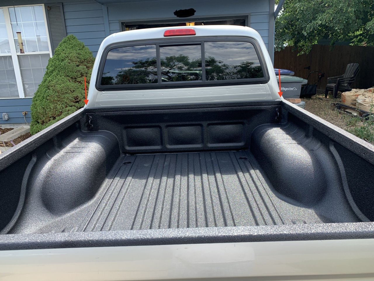

    Sorry for the double quote. But does the outer lip of the Snugtop go over the outer edge of the bed rail? It should on all four sides. See the picture below (zoom in) of how the topper sits over the bed rail. So any water running down the topper doesn't even hit the bed rail. Should be positioned on all sides like that.
    Also on the front (closest to cab) bed rail the middle section is about 1/4" lower than the corners (which are part of the side bed rails). If water is leaking in through that 1/4" gap you can fill it with some goop to make it flush. So your bulb seal sits across the front as it should, without any gaps under it.

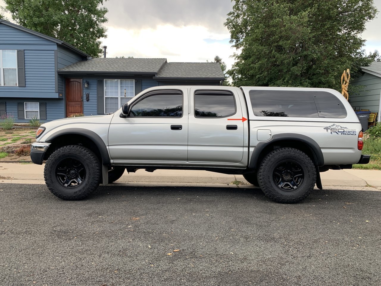

    Here are those 1/4" gaps that I put goop in to make the front rail flush with the corner rails.
