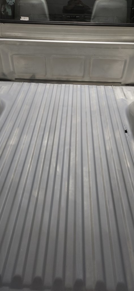

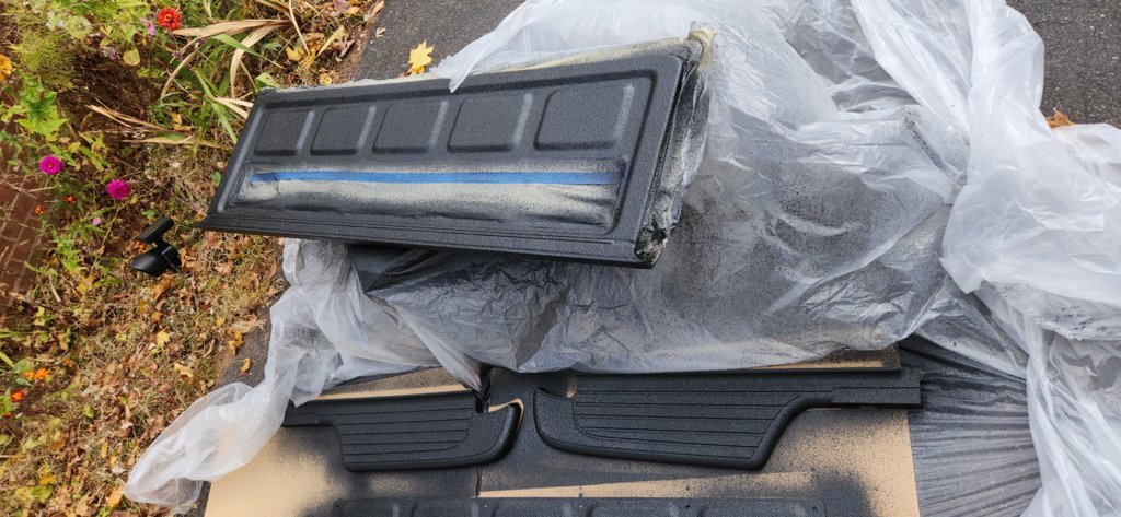

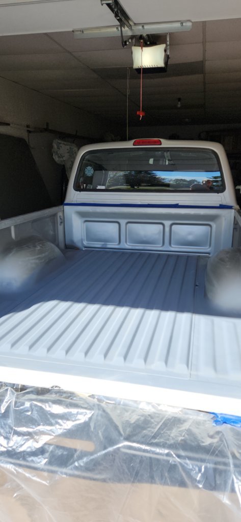

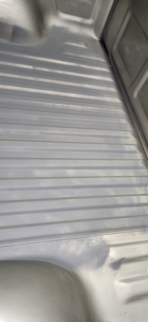

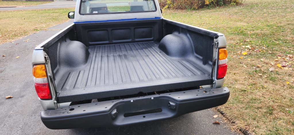

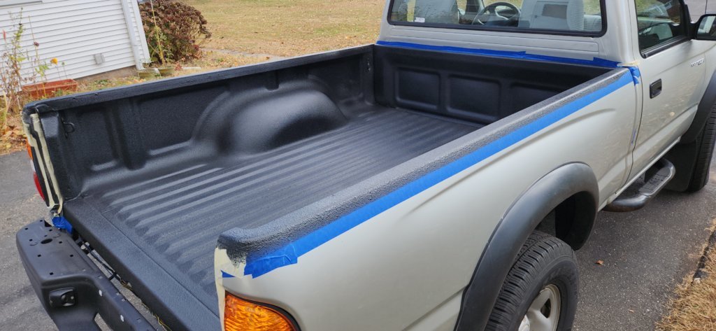

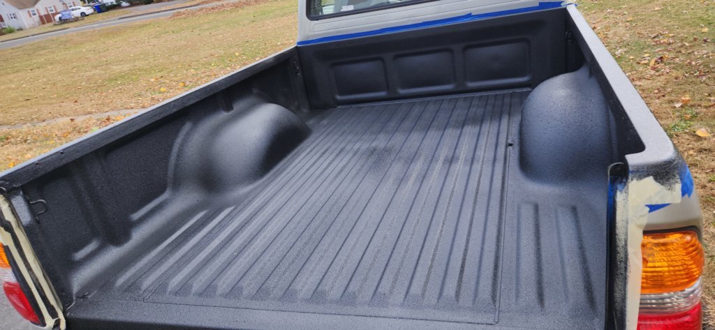

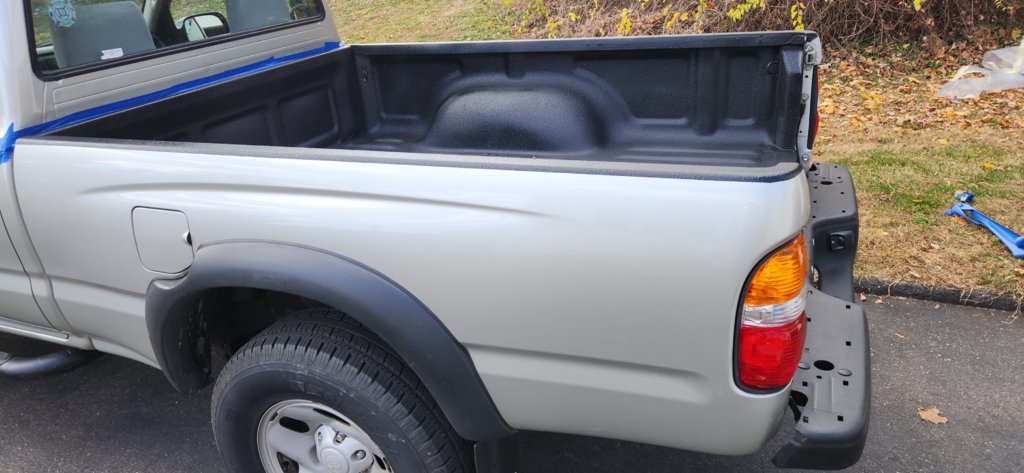

    I sprayed Raptor bed-liner after a few days of prep work.I did cover the rest of the truck with plastic from the overspray from hitting the paint. It was fairly easy and fast using the 2 part kit.Also did my plastic bumper top trim pieces along with the tailgate.I will be putting the original plastic bedliner over it for the best protection of the bed.20241102_124450.jpg 20241102_124449.jpg 20241102_123836.jpg 20241102_124854.jpg 20241102_124900.jpg

    Looks good. I'm considering doing this but will probably have someone do it professionally. There is a place locally that uses Patriot liner, and another that does Line-x. What did it cost you in materials, if you don't mind me asking.

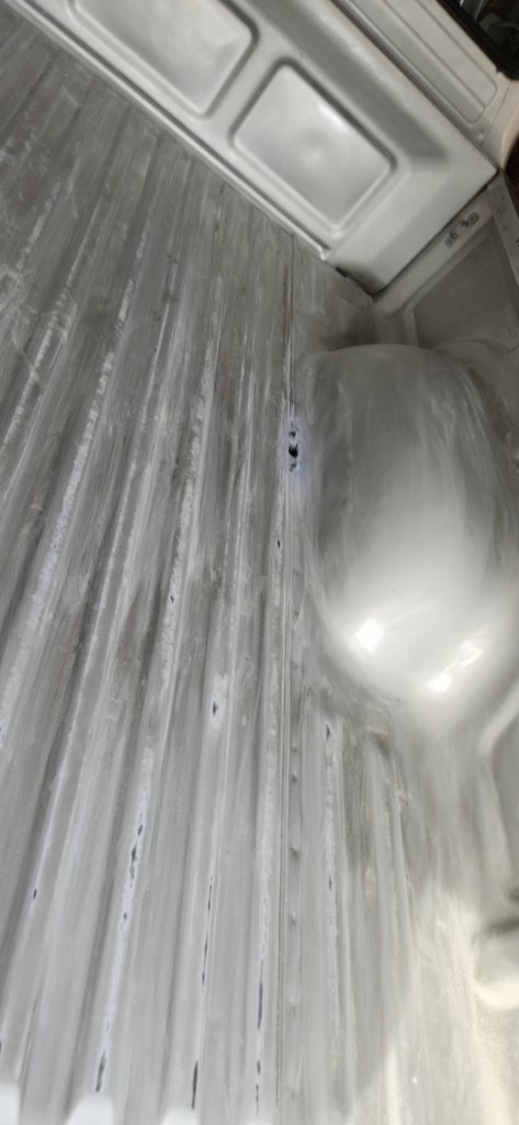

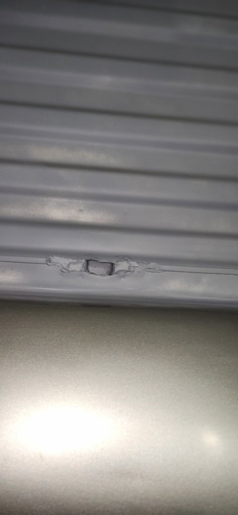

    I could say its cheap enough for $142.00 that's on the A site. Also you need to have an air compressor and of course all the safety equipment like a good respirator, gloves and a paint suit. Plus the prep work before which will take more time depending on the condition of your truck bed.Rust is the biggest problem if you have any must be addressed and any bare steel. If you look at one pick you will see a hole that in the bed caused by leaves that were under the original bedliner. I left it with the hole so now it has a extra drain.LOL All I got to say you must be willing to put some time and effort for a good result.

    looks great!
    especially like the over the top of the bed rail sections!

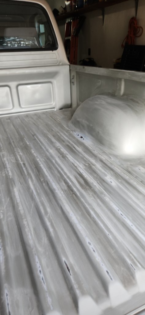

    My truck bed paint was lightly scuffed up and also did spray can primer. Then I sprayed it in

    Here is some pics of the prep work20241101_130715.jpg 20241031_201051.jpg 20241031_201047.jpg 20241031_201014.jpg

    20241031_142627.jpg 20241031_142631.jpg Found a few more pics
